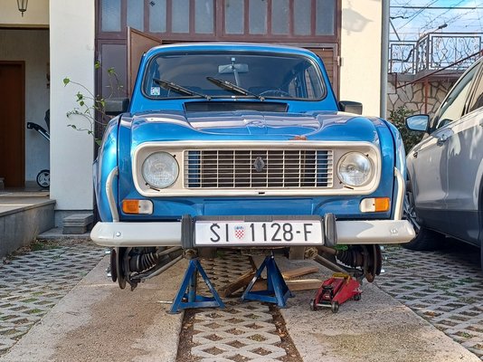

Setting ride height
Starting measurements were
LEFT SIDE [mm]​
RIGHT SIDE [mm]​
H1​
255​
255​
H2​
195​
201​
R = H1-H2​
60​
54​
TOP OF WHEEL ARCH​
626​
640​
I wanted that top of my wheel arches are at 615mm on left side and 610 on right side
Left side need to go down for 11mm, and right side for 30mm.
Change of one splin on front and rear end of torison bar changes height for 3mm.
That meens that left side need to go down for 11/3=3,67 splins and right side for 30/3=10splins
I decided to go with 4 splins on left side, and 10 splins on right side.
To lower car left torsion bar must be turned counterclockwise and right torsion bar must be turned clockwise.
After all work i got what i wanted. (not quite but will left it for now)

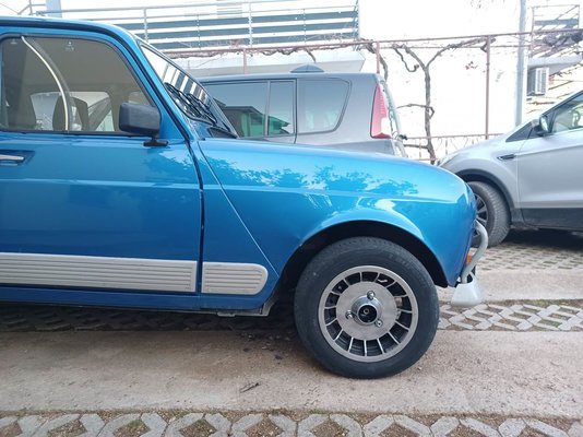

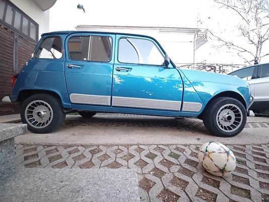

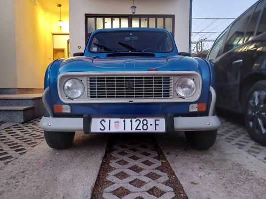

LEFT SIDE [mm]​
RIGHT SIDE [mm]​
H1​
255​
255​
H2​
177​
179​
R = H1-H2​
78​
76​
TOP OF WHEEL ARCH​
610​
612​
I would be more satisfied if left side is little bit higher (615mm)
I should go with 3 splines on left side instead of 4 but not going to do that now.
It is really a lot of work to dismantle whole front end on both sides and i am not in the mood to do that again right now
Will see if car will drop slightly after some time. If so then i will do setting again.

It helps a lot if you take anti-roll bar off before measuring and put it back after completing adjustment. This way you will prevent or detect previously unequal torsion bar tensioning.
Measuring at the wheel arch on a car with a separate body and bolt-on wings and wheel arches will give confusing results. For a quick check it's better to measure chassis under jacking points.
There was somewhere a "hidden" note that cars equipped with tripod inner joints - all R4s after around 1972, in fact - should be set so that H1-H2 is 5mm lower (46mm). It may now look high to your eyes because you have lower profile tyres - with 145/80/13 tyres at 23psi I get H1 figures of 258-262 mm.
Check out this post too: https://www.renault4.co.uk/forum/threads/how-to-set-front-ride-heights.5693/#post-72343
Tx Angel!
I was reading carefully your topic. There i have found information about that "hidden" note and 46mm.
But my H1-H2 are still to far from 46mm.
As wings are bolted to chassis and chassis goes up and down depending on position of torsion bars my logic was telling me that height of car is connected to height of wheel aches.
(it does not mean i am right)
Comparing heights (H1-H2) at Malcolm’s table there is no many R4's set to that 41mm (or 46mm)
Not sure where up in the "sky" would end my wheel arches if i have set ground height to 41 or 46 mm.
It is really confusing in my head and still do not get it.... I am trying to find logic in these figures but cannot.
I have measured height at front end of chassis behind wheel. (10 cm in front of jacking point) - check picture
Before lowering left was 255mm, right was 260mm
Now it is left 238mm, right 235mm.
This is also confusing
I can see that you have removed only anti-roll bar. Hub, driveshaft and shock absorber are left intact.
I have taken all this apart.
My tires are 155/70/13 which is same in circumference and height as original 135/80/13
I get what i wanted but not quite happy as i do not understand why is such big difference in H1-H2 measurement in my case and in books.
In other word....have i done it correctly....is something wrong with my car?
Difference in H3 is because your car still sits too low. It's not something wrong. It's normal for the wheel arch gap to be huge when ride height is correctly set. Many people find it quite unsightly, but that's how an R4 looks :-) .
