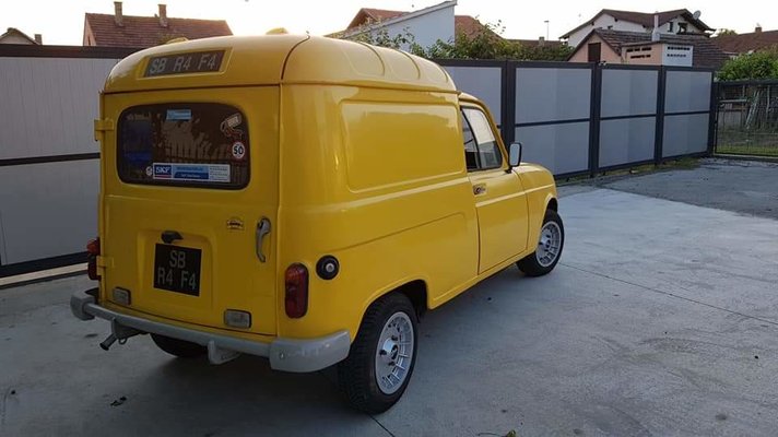

There is certainly 10 years (or even more) that i want F4. Short furgonet with big openable side windows, rear bench and girapfone on the back of the roof.

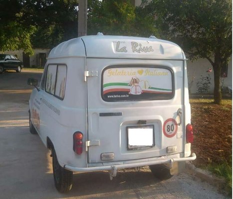

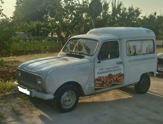

As to my knowledge there are only three F4 in Croatia still alive in any form.
One in Istria owned by pastry shop that is still used daily as delivery vehicle for shop

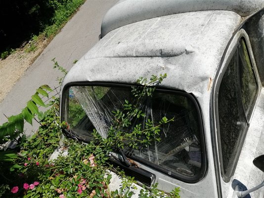

One in Rijeka who suffered badly in some storm when tree branch well on front part of the roof and bended roof and broke windshield

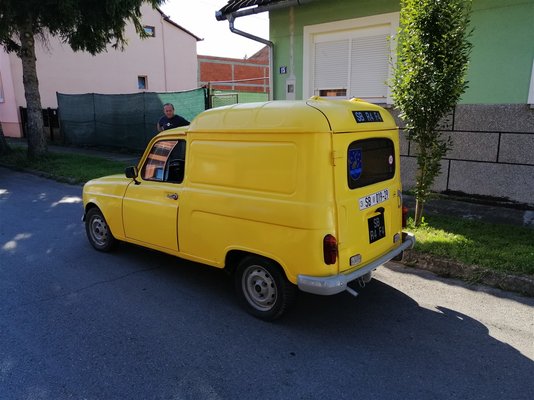

And one in Slavonski brod. Could be seen on gatherings but was not registered since 2003.

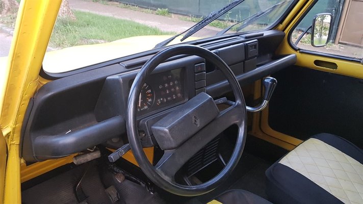

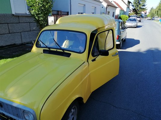

This is not passenger version that i would like but i believe it is not so big trouble to transfer it passenger. giraphone is already there
Year of built 1981. Imported to Croatia in 1995 from Switzerland where it was used at some airport
Drum brakes all around, and handbrake to front wheels
Inside is GTL model (instrument panel, seats)

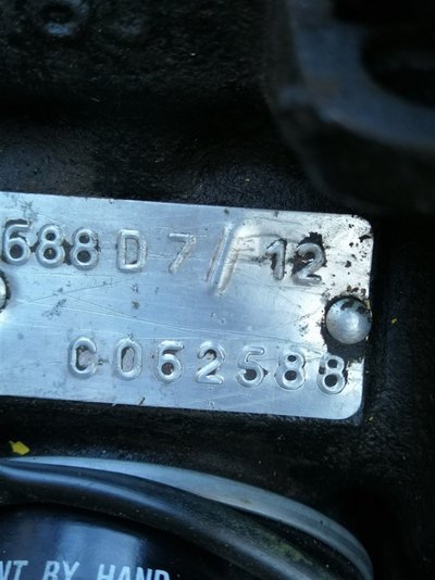

Engine is 688-712 and gearbox HAO-146 but i believe original engine and gearbox was changed sometime in the past.

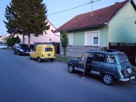

After five hour drive we are standing near yellow F4.
Center of the universe for next few moments
After first enthusiasm about car big disappointment came. Chassis underneath is in bad shape. So bad that going thru Technical Exam (Croatian MOT) is impossible.
Starting from Vodice we did not think about it as project car but car that we could register, get license, and drive right away.
After whole night of discussion decision was made. We are going to take yellow F4.

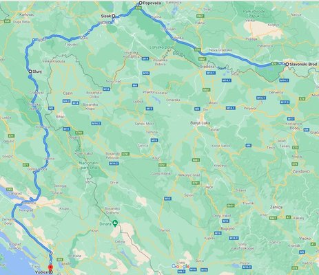

First couple hours we were stopping every now and then to check the car that wasn't done more than 100km in 10 years. And now he is on the road trip of 550km

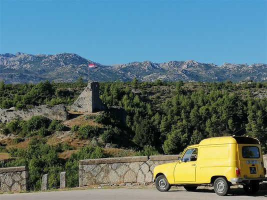

After we cross Velebit Mountain i had smile on my face. We were some 100km to home and now car could stop and i would not mind it.
Velebit Mountain in the background

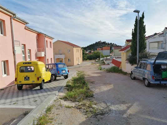

After 10 hours’ drive we came home to Vodice/Tribunj
In front of my house

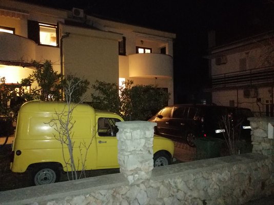

In front of BorgeB house in Tribunj surrounded with our other sweethearts

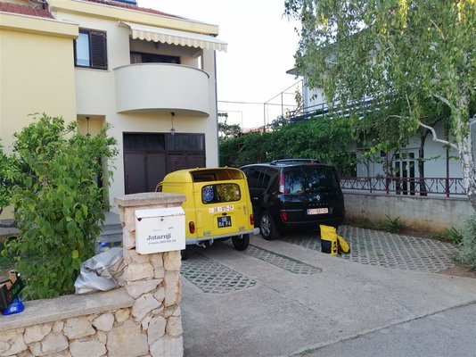

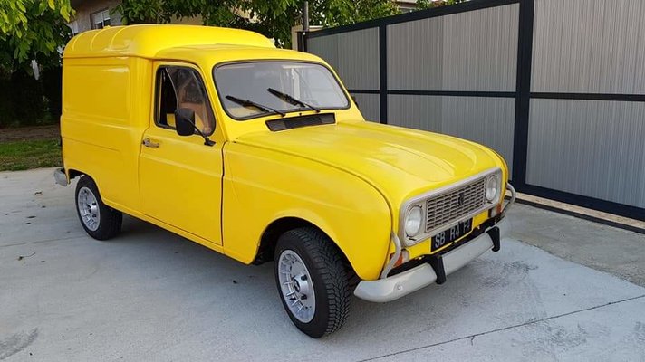

Intrigued by the number plates Petak, are they just for show or is really registered as whats got to be the most desired plate for a Renault 4F4...R4 F4?
Laxeian.....unfotunately those black plates are only sticker. would be great if it was real licence plates. For now car does not have licence plates. In Croatia you must return them when/if car is no longer MOT. Then when you get new MOT you can get old one back (if they are not destroide) or take new one. Same thing is when car is changing owner and county.
For now idea is to sort out chassis and make it road leagal with "old not so rusted shell".
Somekind of "rat look"
Bumpy "neglected" body with perfect chassis and mechanic underneat

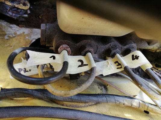

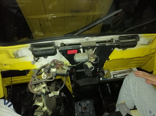

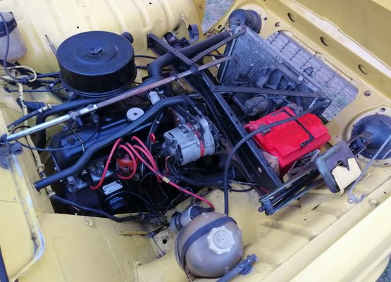

Dismantling started from engine bay.

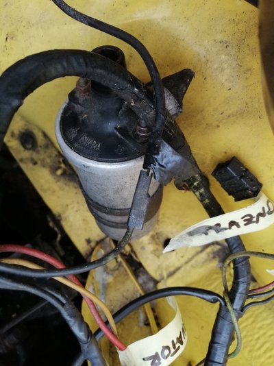

Marking all electrical connection
And brake lines.
So i can put them back in place.
I can see that some electrical connection and lines will have to be renewed.
It is getting harder than i tought it would be.

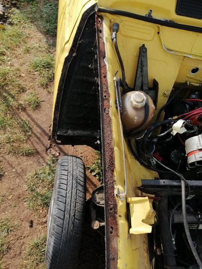

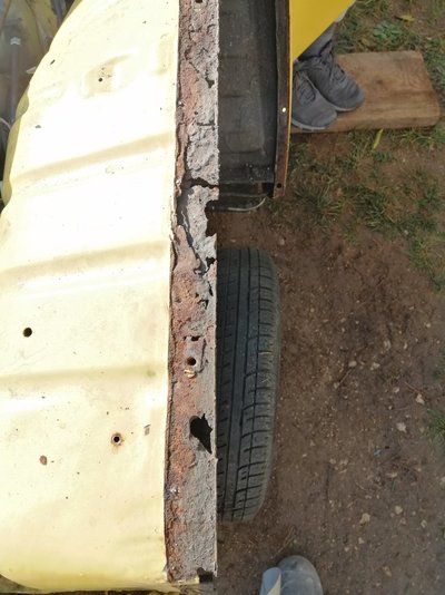

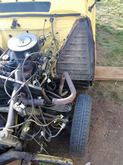

Tried to remove front outher and inner wings but bolts are rusted and hard to undo.
Few snaped, which is better solution. Worst case is if bold start to spin, and i can not reach other side to hold nut (or cage nut)
80% of bolts and nuts are rusted and wont be able to use them back.
What is worse, whole chassis (even flor from inside) and wings are painted with somekind of underbody chipstone protection that is not helping during dismantling process.
Left side wings are off.

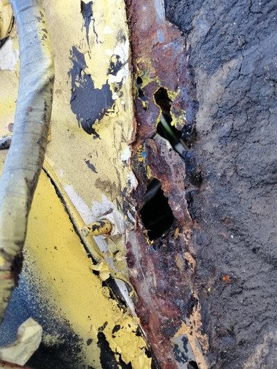

Some rust at inner wing.
And some holes right beside master brake cilinder
Right side is partly down.
One bolt (last one naturally) is turning and must use grinder

I am glad i have decided to remove front wings because of this rust holes under it.
Once again it shows how pictures in adds can be deceptive.
