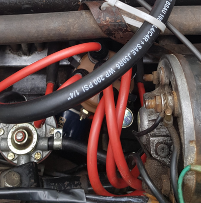

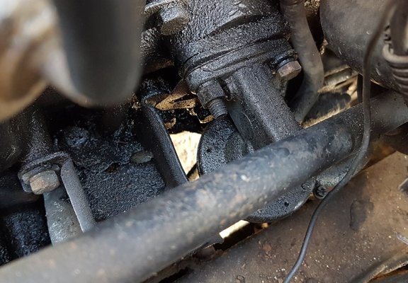

845 engine (Billancourt):
Cléon engine (1108cc):

Is this the type on your van?
https://www.amazon.co.uk/Valeo-Serv...leo+247101&qid=1581509815&s=automotive&sr=1-1

Thanks Andy - now that makes perfect sense. Yes my van is the smaller engine and has the Renault 5 mk1 interior with the super thin steering wheel! The pump sits upright. The tank is out now so I am replacing the sender unit as well as it is very slow!
