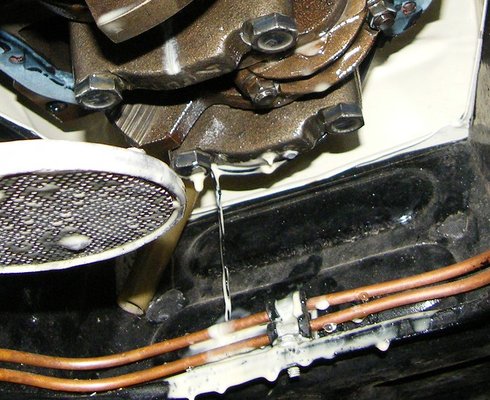

Plugged an airline into the radiator expansion hose today and found the water is all coming out at the rear of the rear main bearing - possibly from the timing chain. Suppose if I pull the main bearing it might give a bit more of a clue.
PS - it is possible to pull the sump with the engine in situ if the back of the engine is lifted a bit. Don't fancy my chances of getting it back on though.
ops: Surprised the engine building folk didn't pick up on it.
