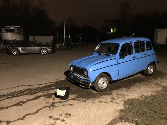

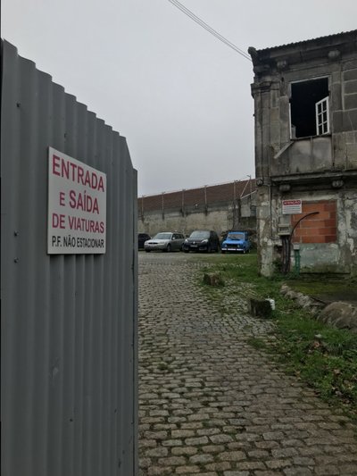

The day after Boxing Day we took an early flight from Stansted; by lunchtime we were shown to a secure parking compound in suburban Porto...

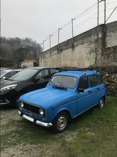

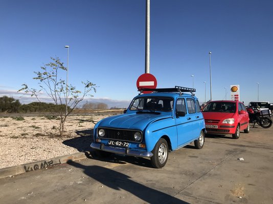

...where Joao, our 1985 GTL was waiting -
Now all we had to do was to bring him to London :)

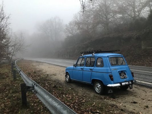

After a drizzly start with dense traffic we got out of Porto. Hills to the north were shrouded in fog -
After two hours' driving the roads were non-stop twisty, the fog became dense and day became night. In extremely limited visibility we trickled along at 50kph.

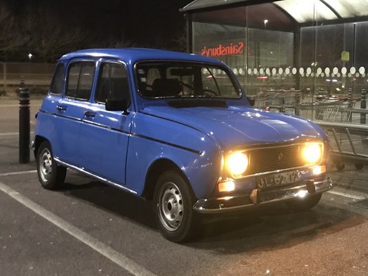

Joao had taken a hit. The impact had pushed the front of the bonnet in. Luckily the radiator was intact. However both dipped beams were gone, and we were left with one crooked main beam. Not great in the fog. We had to drive a tense further hour of mountainous country roads before reaching Chaves.

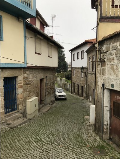

Chaves was very pretty -

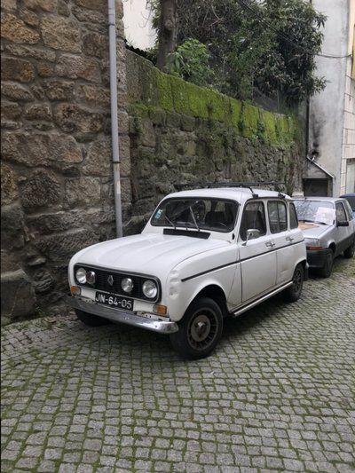

And guess what we found hiding on a side street?
Proper well-used example, with a selection of different alloys and what appears to be Portuguese-obligatory roof rack and tow bar (ours had been fitted with these too) -

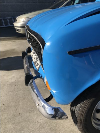

Next day we crossed the border into Spain and the sun came out. Got our first clear view of the accident damage - not great but not the end of the world -
That won't polish out

Last week I took him to meet Derek at Renospeed, who's not far away. He kindly pulled my goat-damaged bonnet into some sort of usable shape, and got the headlamps levelled with new bulbs :)

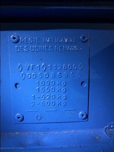

Whoever did the respray remembered to do inside the engine bay ...including the ID plates, CV gaiters, wiring loom...

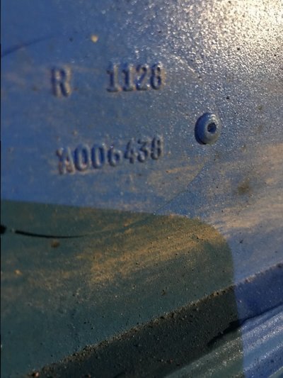

Oval plate -

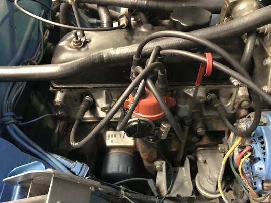

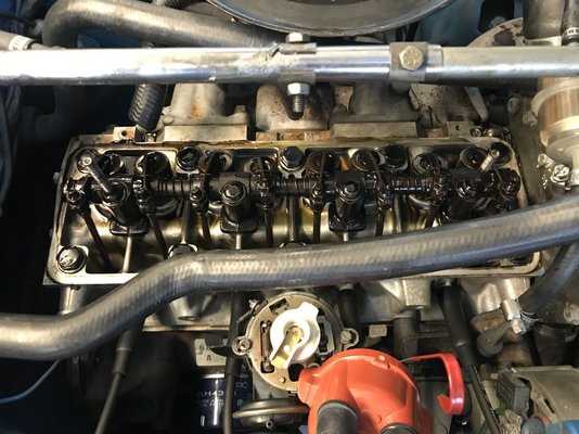

RHS of engine showing Femsa distributor (thank you for the "which distributor?" post!). God knows how long the oil filter had been there -

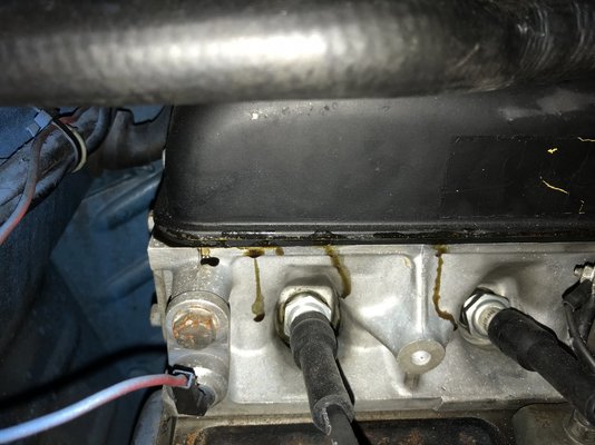

Rocker box had clearly been leaking. The retaining nuts had been overtightened, deforming the cover - we straightened it on the bench with hammer and drift. Only discovered after fitting a new gasket that the dribbles were of old sealant not oil :whistle:

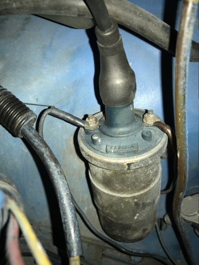

We replaced the distributor cap, rotor arm and HT leads, although the existing items seemed quite fresh - saved to my box of bits to carry in the car. Vintage Femsa coil stays for now, albeit with the Gammatronix unit strapped to it (sorry, no pic of this) -

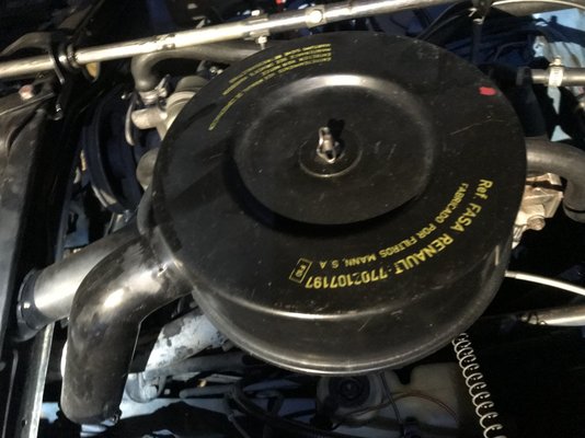

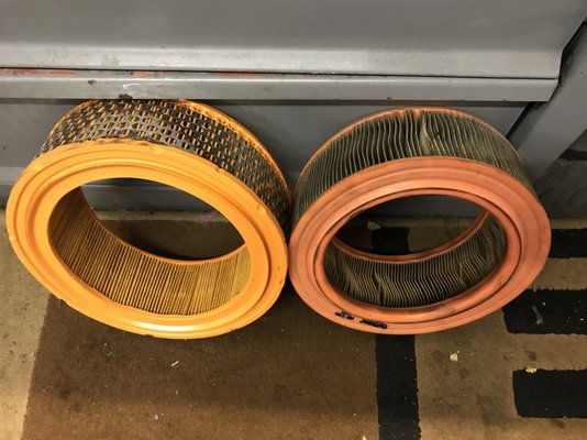

Spanish spec air filter cover...
...held a rather grubby paper element. Replaced -

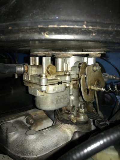

Carb has been replaced at some point, but I'm not sure with what. I think this may be a Zenith 32 -

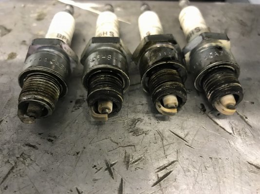

It seems to be running very rich at idle. However I want to replace a frayed/ sticky throttle cable (car doesn't always return to tickover) before playing with it. General running is okay and the plug tips looked a fair colour -

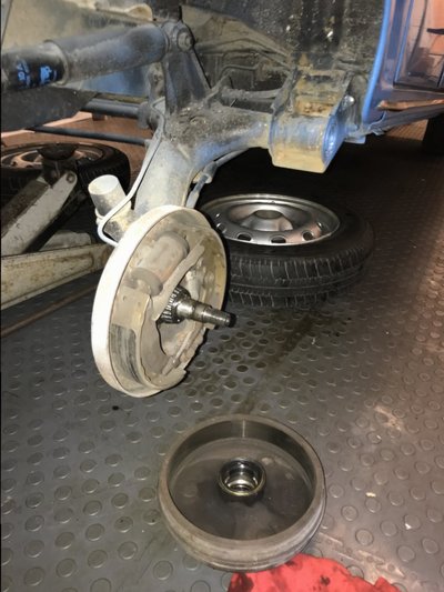

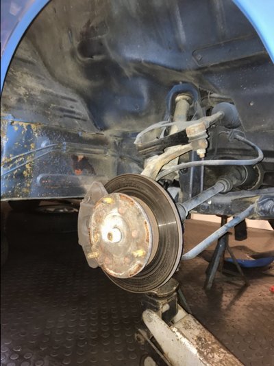

Discs and pads, drums and shoes all seemed okay for wear. One slave cylinder weeping though. Brake lines were flushed through with new fluid.

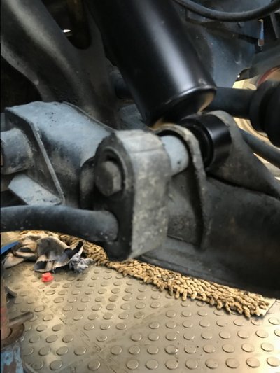

Whatever these bushes are called, they look knackered. There's also play in the front hubs, especially the left-hand one - think we'll need to deal with this
