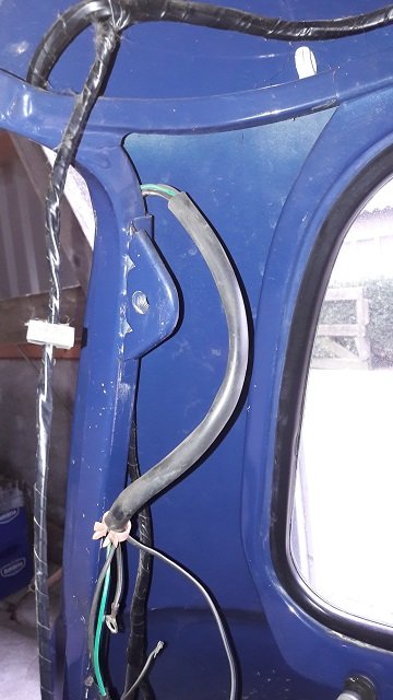

Here the 3rd strongpoint mount on my 1985 GTL, the first 2 points are obvious since the 1972 berline models.
Anyway, the rear seat belts (2 or 3 point) and their mounting points will differ per country as in those days every country had a different law about the rear seat belts and after all the FASA build R4's are unique/different in their way :whistle:

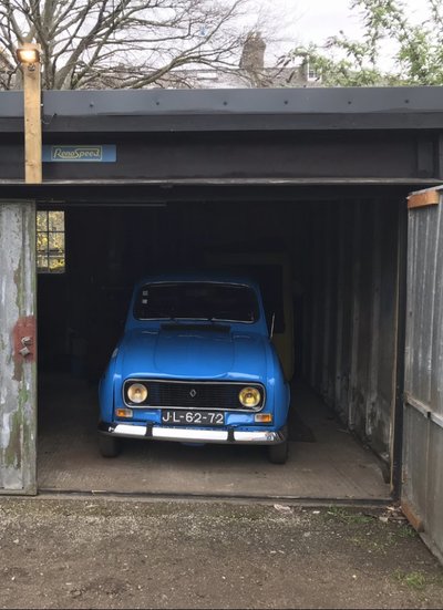

I've just collected Joao after his short stay at Renospeed in south London.
Dealing with Derek there has been a pleasure.
He's dealt with the list of tasks identified during our service back in January, plus a few other bits found along the way:

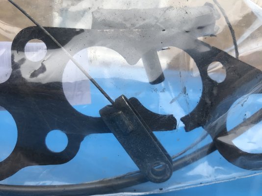

FEMSA distributor replaced with new substitute-Ducellier item, with working vacuum advance
Frayed throttle cable replaced with new
Manifold gasket replaced, dealing with exhaust blow and inlet air leak
Proper crushable washer fitted to sump plug, curing leak experienced with solid copper item sold by DF
Nearside front hub and wheel bearing, driveshaft, CV and steering rack gaiters all replaced
Rear drum cylinders replaced; misplaced brake shoes refitted (they'd been mounted the wrong way round and were causing the brakes to grab on one wheel)
Front shock absorbers and mounting bolts replaced (turns out we'd been sold the wrong items in January)
...and tidied up a few other things round the engine bay.
Joao now starts immediately from cold (he was a pig before), runs smoother and more sweetly and is more responsive, and rides better. Banging over potholes has been cured, and the noisy exhaust blow has gone. In all, I'm very happy!
Now just the tracking to do (he's still pulling to the left), then I think he's about there for now.

Ready to collect this morning -
Manifold gasket (in a bag with old throttle cable, sorry) showing split causing inlet air leak -

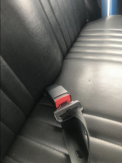

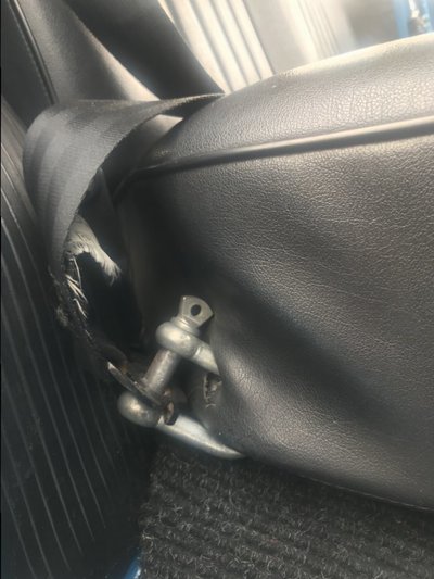

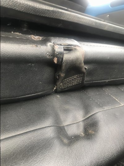

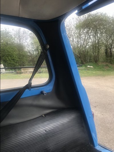

Okay Joop, today I had a closer look at the rear belt. You’re going to love this one...
So I have a 3-point belt on one side only in the rear. The keep for the buckle is fixed to a bracket on the seat back frame, which looks like a factory fit -
As pointed out to me, the upper mounting is bolted to the window frame, which isn’t standard -

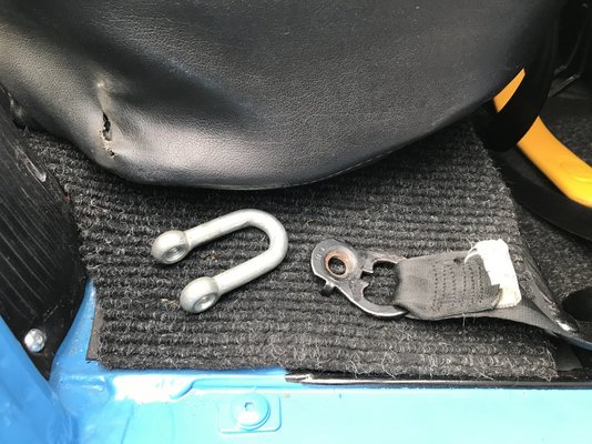

At the other end of the belt I found this mounting arrangement -
What a shocking bodge!
At this point I decided to remove it from the car. I can’t imagine it would have much safety benefit.
My feeling was reinforced when I undid the top mounting bolt. Didn’t hear a nut clatter down the back and there’s no captive one - I think it was just threaded into the metal of the window frame :o

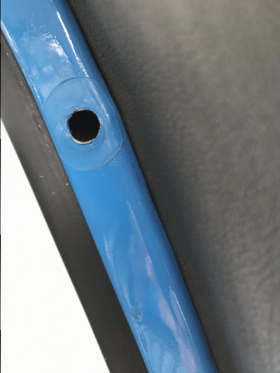

Removal took only a couple of minutes. Nice uncluttered back seat now and no illusions about safety kit :)
Just a small tear left in the seat base -
And hole in the window frame I can live with -

Well Simon, just bizar for words that back seat belt "construction" luckily you don't need rear seat belts or at least I don't have them on my GTL.
Question still remains how such a construction ever could pass a Portugese MOT...
Maybe with a mere 50 euro, pounds or what ever in the ashtray for the inspector? :D

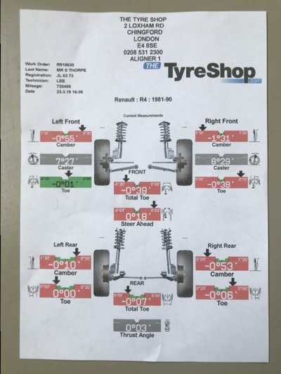

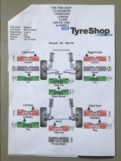

So last weekend I took João up to a local tyre shop to get the wheel alignment checked. He’d been consistently pulling to the left, and the steering wheel was misaligned at straight-ahead, making indicating right turns difficult as they immediately cancel.
Pleased to report after 30 min and £40 both problems are solved :)
Before and after readings below - one front wheel was well out.
Have a good weekend everyone - Simon.
