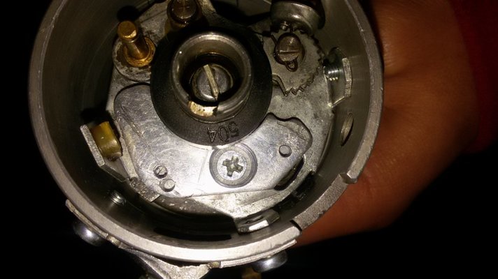

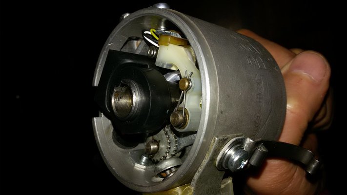

I need help I just refurbish the all dizzy and assemble the electronic ignition but Im unable to make the ring go down :doh: any sugestion?

Did you turn ring in right direction?
Shaft is not round but have 4 slots.
So you should alighn slots on ring with slots on shaft.

The problem is on the base plate, the halls to attatch the sensor are wrong they make the sensor too close to the ring.
I must make a new base plate.

#32
Does your kit still working?
Can you post some picture of your problem, and solution, so somebody else can see it and make necessery changes to fit this kit.

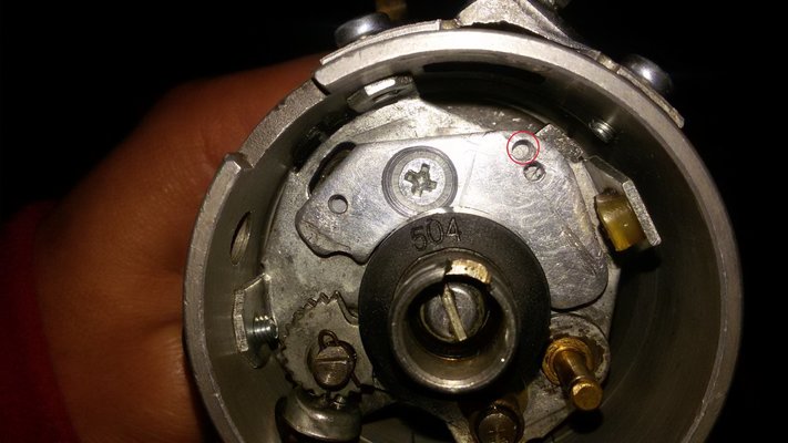

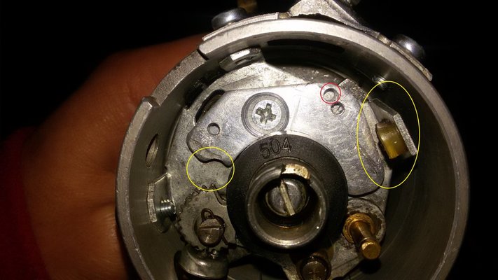

Definitly it would be nice to see pictures,as Fernando is in proces of dismantling and fiksing dizzy to fit accuspark.
petak
1,339
Vodice, Croatia
#36
That is perfect information.
Please just point which hole did you drill.
This way next person who would like to fit accuspark knows everything in advance and can be prepared for changes that must be done.
