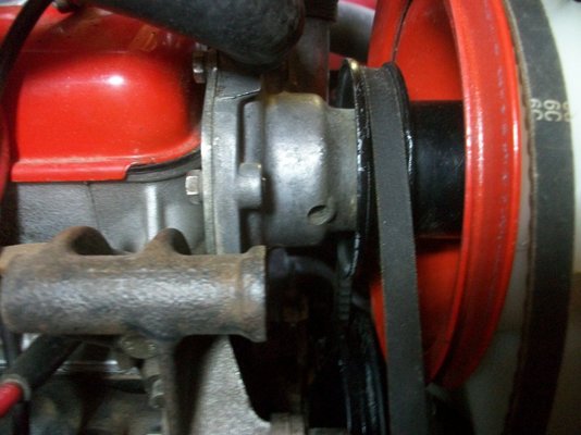

That crystals are from coolant, and that is not something to be scared for.

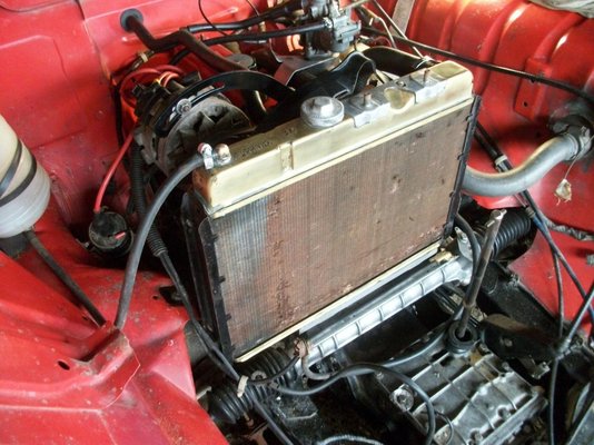

Believe that you need only to tight those clamps little bit more.
When you start engine it will take at least 0,5 lit more coolant, as water pump will start to move coolant and system get pressured
So definitely you will need to bleed system one more time.
I did, and system took coolant from max to min (and little bit below min) on expansion bottle marks (that is cca 0,5lit). Added coolant to the max and now it is fine.

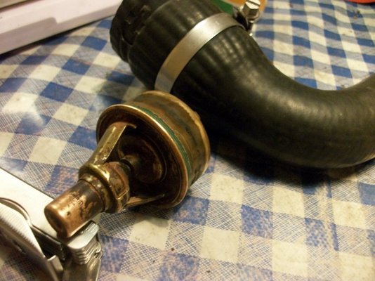

I would definitely recommend to change thermostat. It is not that expensive, and you know that it is working.
Lower temp thermostat will open circulation thru radiator sooner.
Is that better or not i can tell you as i did not agreed with my self what is better
On mine GTL (1100 engine) i have 86°C thermostat.
