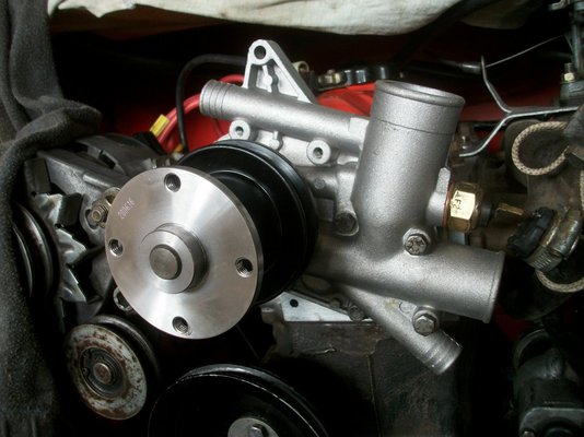

The hole underneath the pump is a vent for the seals and it will drip from there if it has got a problem do not worry too much about WD-40 damaging your clutch the water should drain out of the slot under the flywheel and the WD-40 Will Speed its progress
Try the boiling kettle trick
Or spend €50 euros on a new pump
I know what i would do
This is common problem on engines been standing few years
