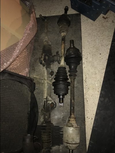

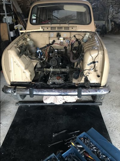

I had to down tools for a few months for various reasons, good to finally be cracking on, thanks to Harbourseal & Mojo for advice I've got the drive shafts & steering bits out, just the brake cable to undo & the engine mounts & I can lift out the engine!

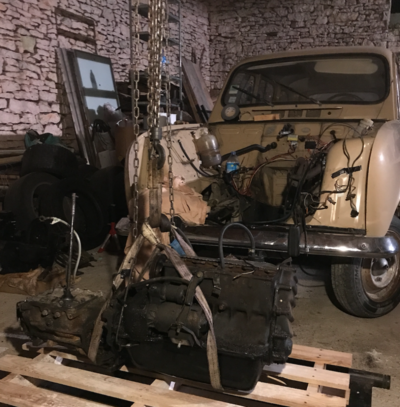

she's ready to be hoisted tomorrow morning & can I just say thanks to all of you who encouraged me to get the engine out, 1st time is always going to be the hardest, but I've already learnt how so many other bits fit together. Trying to clean inside the block was v difficult with the engine still in this way I can do a much better job, so cheers
