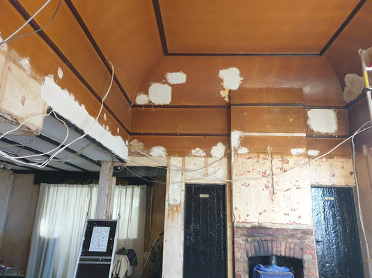

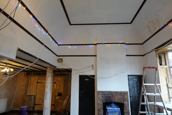

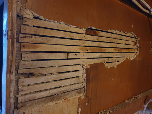

I've not been getting on with the F4 but I can report some progress repairing the big holes in my ballroom ceiling. Over the last 40 years many people have made many holes in the poor ceiling. It's a lath and plaster system (common before WW2) where the lath are bits of wood nailed onto supports and then plastered. My holes now have new lath.
They mostly have new plaster too. So many big holes, but soon I should be able to paint the ballroom ceiling. And then start getting on with the walls. :doh:

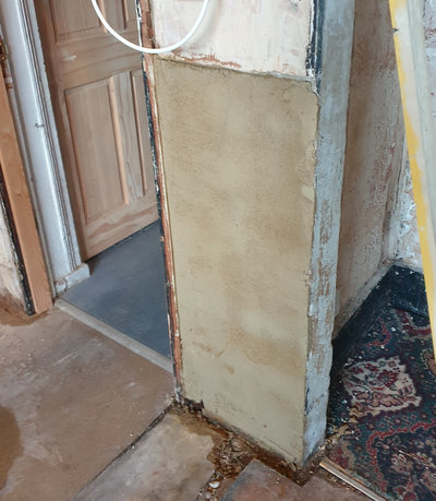

Actually I've already started the walls, and at the base of this one I found some rotten parquet wood floor. It's under the concrete floor. This is the house that keeps giving. :laughing:

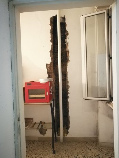

I'm working in my house too, even if my ongoing restoring is not as extensive as your...

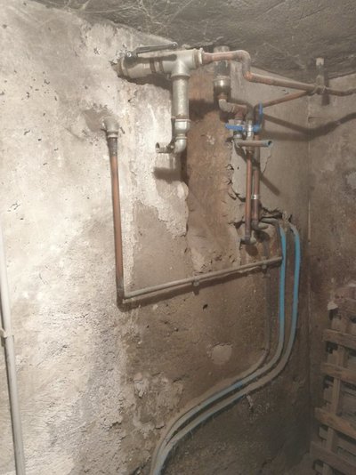

Yesterday I found the old chimney from the basement, took off the old eternit (! ) one and going to swap it with an inox one... Plans are to fit a wooden stove in the basement for the house heating... IMG_20201122_184844.jpgIMG_20201122_183200.jpg
Good luck with the plumbing :artist:
I think I'll do by myself just the cold/warm water pipelines, since now I teared down a small wall and they have to change road (now they basically hang on the middle of nowhere), the stove plumping is a work for the plumber (even legally speaking I'm not allowed to do such a job)... My main concern now is installing the new chimney, that is slightly bigger than the old one (18 cm diameter) and needs a bit of uncomfortable diggind further in the wall....

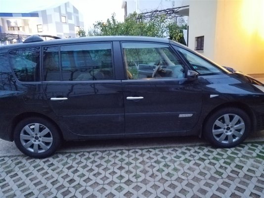

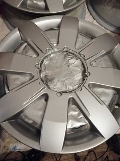

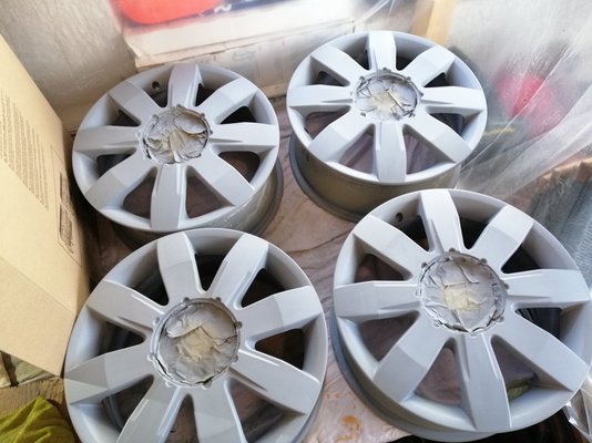

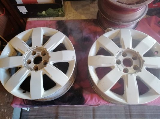

Boght 4 Wheels for Espace as winter set up in bad shape. Badly paintrd in white by previous owner. Paint started to fall off.

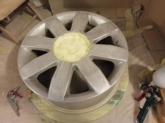

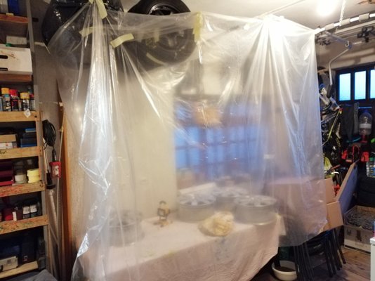

Made small paint booth so i can play with sprey gun
Strip them to bear metal with paint striper

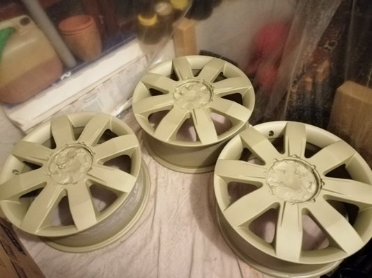

First coat Wash Primer for aluminium in three layers
Second coat Mobihel Primer in three layers

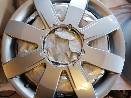

Third coat Mobihel paint in two layers
Fourth coat Mobihel Clear coat in two layera

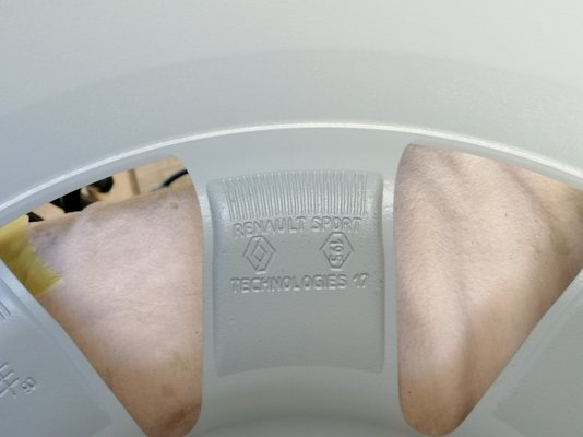

Job is done from inside and outside.
Need to leave it for few days so that clear coat get fully dried.
Put winter tires and on car.
Learned something new (first time i am using sprey gun for painting) , and realised that preparation of the surface is most important and hardest coat to put is last clear coat.

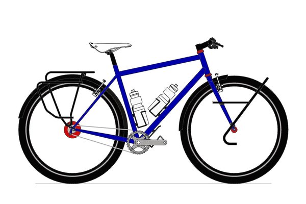

The eyelet for the derailleur is left in place as a precaution. My gearing is with a Rohloff speed hub, with 14 gears. And just one sprocket at the front on the crank. An eccentric bottom bracket is used for the tensioning of the chain.
If something fails I can put on a normal gearing system or a chain tensioner and continu my trip. This bike is for extended holidays abroad.
The frame builder does one frame at the time to get the best quality bike.
The end result should look like this.
