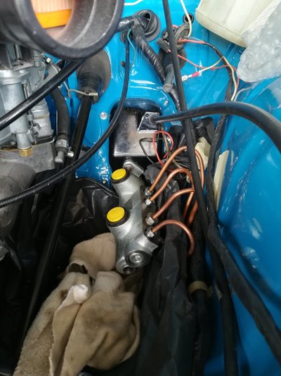

Today I fitted the new master brake cilinder and filled the system with brake fluid. OMG, I had to repair 5/6 leakages (I had to tighten the connections, I put on the brake lines almost 2 years ago...). One nasty litte bugger was the connection on the Mastercilinder, after some :mad: &:fighting: it had a good fit. Now I need to remove the air from the system, but I suppose this is a 2 man job with one pressing the brake pedal & bleeding the system.
Sequense like this right?
1-Rear right
2-Rear left
3-Front right
4-Front right
5-Mastercilinder bleeding nipple
6-Rear right
7-Rear left
8-Front right
9-Front right

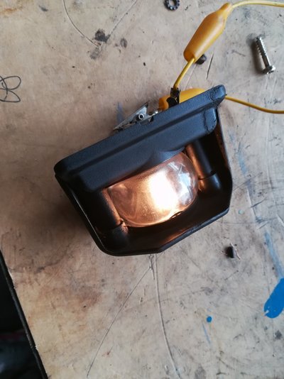

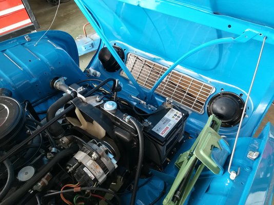

Today I did two small jobs. I fixed the rear numberplate light and I installed the window washsystem, which was a pain in the @$$. I used an aftermarket chrome spraywasher (franzose) but I couldn't attach the waterhose on it. No place behind the bodypanel.. In the end I used 2 rubber o-rings instead of a nut to hold in place. It suits the job..

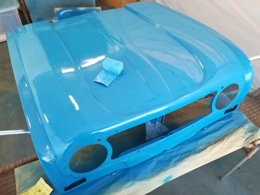

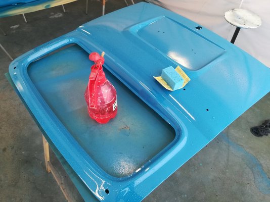

Next, painting tha hood. :)

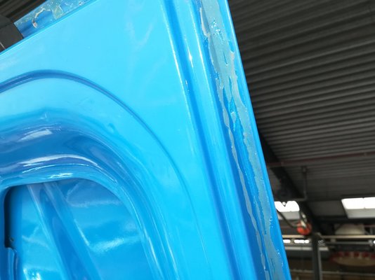

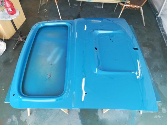

Well, I had some difficulties painting the rear door, unfortunately a few paintdrips. Aargh, need to sand it down & clear coat. In the meantime:IMG_20180723_125115.jpgIMG_20180723_161708.jpg IMG_20180723_135739.jpg
Keep you posted...

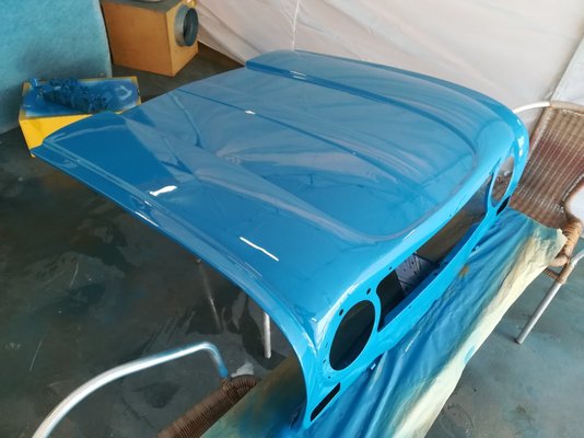

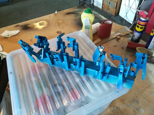

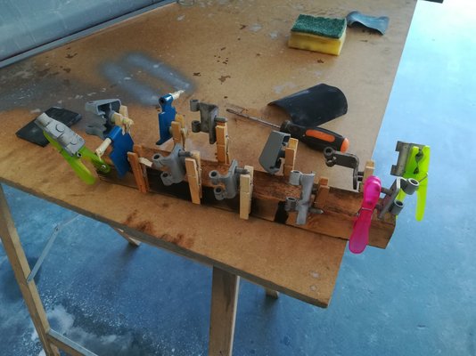

I decided it is too hot in the workshop to work on Louise. But I did some thingies! Fitted the bonnet and cleaned, blasted & painted the headlight holders. On one of then the adjustment lever has broken, so if someone has a spare one? :laughing:

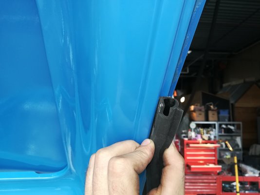

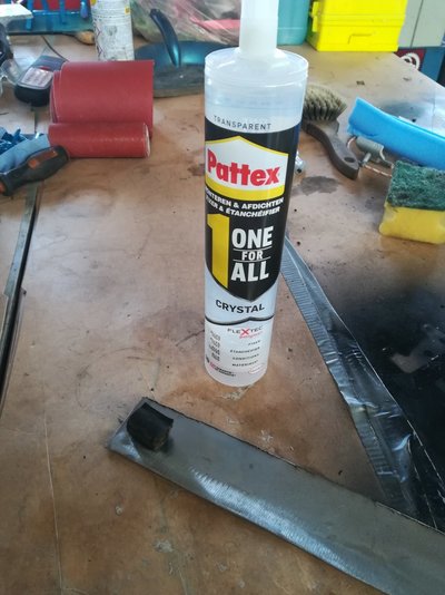

I wrongly glued the back doorrubber and the glue has not set properly. No more Pattex for me..
This is the correct position right? Maybe someone can share a photo? This is der Franzose rubber.
Aaargh......:vsad:
This rubber has a completely wrong profile to start with, so don't expect it to fit as well as the correct one should do.

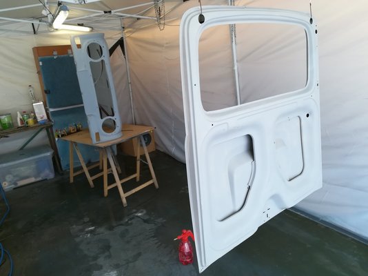

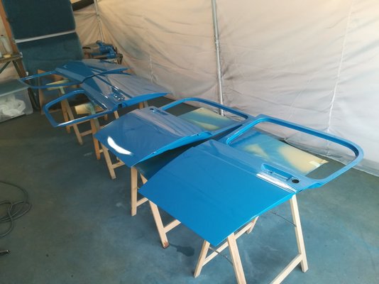

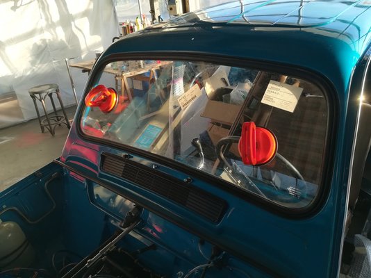

Last weeks I have been busy with all kinds of different things. Fixed the rear lighting, re-glued the rubber on backdoor, screenwipers, headlight adjustment lever and I painted the doors. We're getting there! IMG_20180825_184221.jpg

Well, I just need to keep it going. Last week I glued the doorrubbers, assembled the doorlocks and put the doors back on. It is becoming a car again! :laughing:

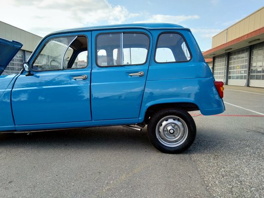

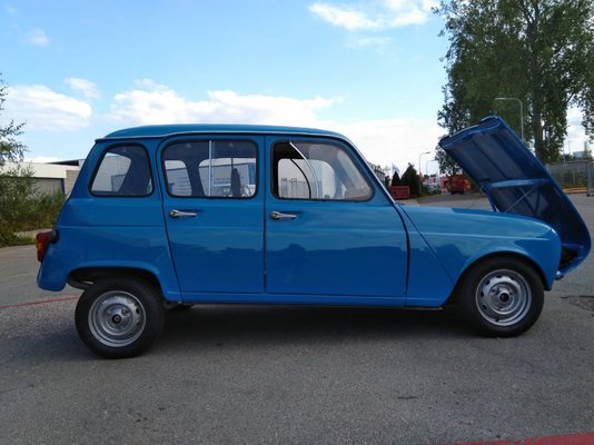

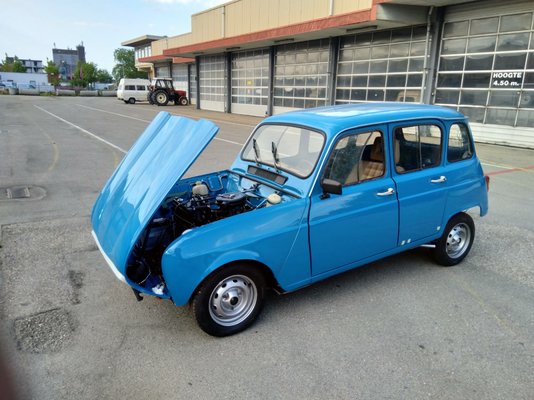

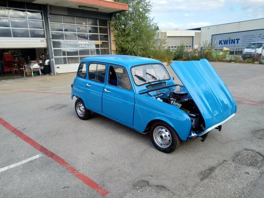

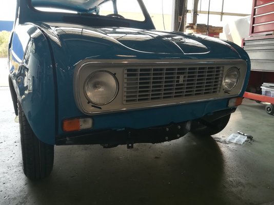

What do you think, need to lower the rear?
Raising the front is obvious, blehh
That wobble says nothing if you don’t fasten the distributor with the intended clamp. Try again but only the rotor axle after fastening it.
Idd raise the front.
I think you need to re do the front torsion bars.
What a beautiful car you have. Love the color.
