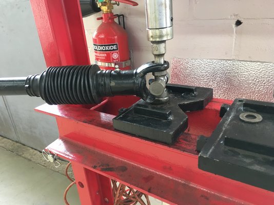

The down was that our bridge seized to do its job. After putting Robinette back on the floor and putting a Volvo 245 on it decided that it had enough after 10 centimeters it jammed.
The up was that after rebuilding the gearbox there was only one more job left to do.

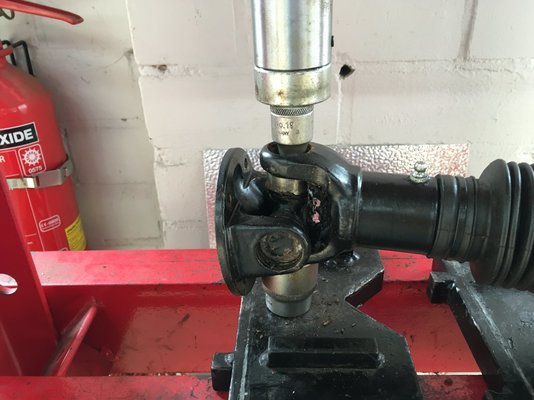

Putting in some new cross couplings on the right rear axle.
Undoing it from the car is easy.

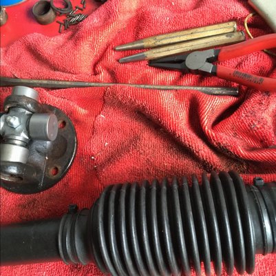

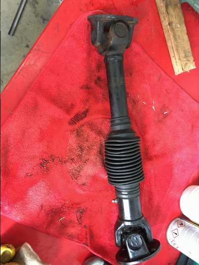

But then undoing the 50 year old couplings took some brute force with a hydraulic ram. 179D31AB-5A0C-4E75-8001-A758F329EF10.jpegThe rear drive shaft on the bench.
Pushing out the old coupling with a 27mm socket onderneath and a 10mm socket to push it through

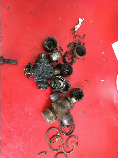

Old couplings all the cups had play in them.

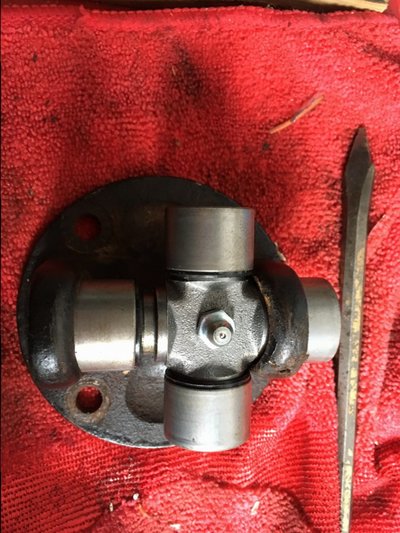

9E0AE2F8-8B93-4E3B-A0D6-7DA859434DD9.jpeg Placing the new coupling. 0A383914-42D9-47A7-B697-BDE203B98FAE.jpeg
Under the hydraulic ram.

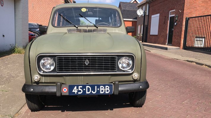

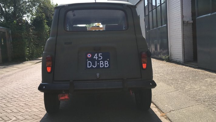

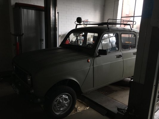

Today Robinette passed her MOT with flying colors after I put in two new headlight units and fixed a small hole in the right front axle gaiter.
I also put on some blue license plates

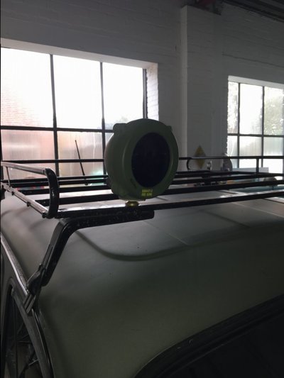

I went outside today in a blazing storm.
I had to do a test drive to see if my last attempt to seal de gearbox worked.
For now it seems to have helped.
Put the roof rack on and put the first of my military props on.
An infrared light. 4261A165-255A-4706-825D-6392F2A1C7BC.jpegF67C9555-F017-4549-B645-61DFC49DA546.jpeg

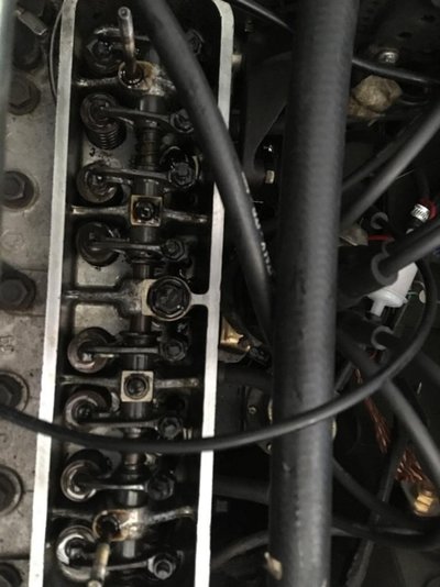

A month or so ago I did a mini service on Robinette.
Changed the oil checked the breaker points, and adjusted them. Put in new cables and bougies.
But I hadn’t had time to adjust the valve clearance.
The engine made some more noise then absolutely necessary and lacked a bit of power.
So yesterday I lifted the rocker cover and found the top of the head like I left it 2,5 years ago when I last checked and adjusted the valve clearance.EA149F90-1715-4166-AC4D-2543D3759AE6.jpeg
Nice and clean without any crud.
Adjusting the clearances went like a breeze.
Now she runs nice and smooth again.
Ready to drive to the south of France the coming summer.
