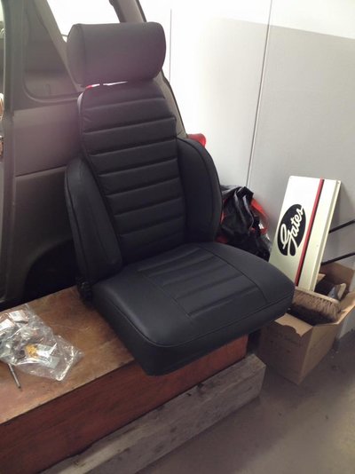

I've always liked those side indicators, were they on the original car as well?
Your seats are beautifully made and look extremely comfortable!!

The side indicators weren't on the original donor. But the fenders were so buckled that I had to find replacements. I found one together with an inside fender from an early R4 with the indicator hole in it.
Of course I didn't plug the hole. But I drilled a hole in the other fender to.
The craftsmanship on the chairs is outstanding and they sit extremely comfortable.

Chairs are fantastic!
Love fact that are from same era.
Definitely will help driving thru corners.
Can you tell are you sitting lower than on renault 4 chairs?

Hey Petak,
They are about 1cm lower than the original chairs. No real difference.
It's almost plug and play with the chairs. I drilled some holes in the lower frame and welded 4 m6 nuts at the top of the frame. Then just bolted the R4 rails agains the frame with some spacer rings from an original 70tees R4 chair I could do with the plastic spacers that come with the later chairs but they weren't at hand

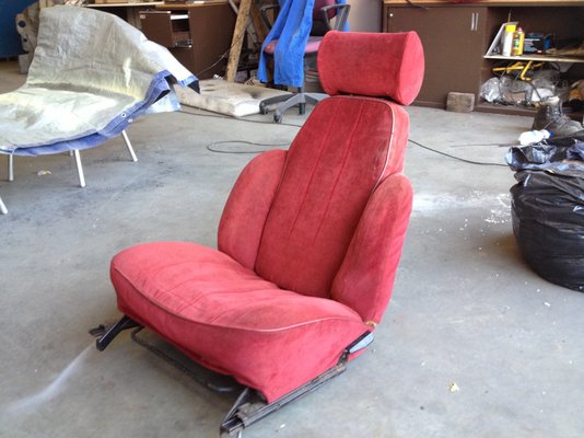

I just found a picture with the original upholstery
Before and after now

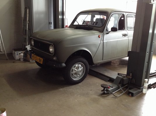

Last few week Ive been working to make my MOT deadline.
Very few pics but trust me many things still to be done. Minor setbacks like a leaking petrol tank, small coolant leaks, leaking brake pipes all have been fixed.
fortunately the wire harnas came out of the donor car undamaged. so everything is in working order.
Last week I started my rebuild engine for the first time. and today I tried the brakes and the Sinpar gearbox and 4wd. And it all works.
It needs some finetuning but it works fine

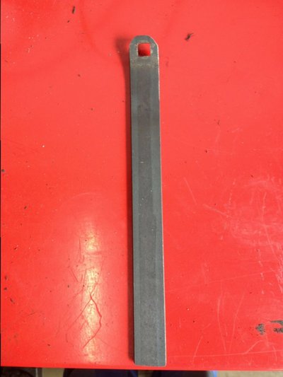

In order to het trough the MOT I needed to adjust the front and rear drum brakes.
They aren't the self adjusting types.
I have been looking for some time for the right Facom spanner with a square 3/4 hole in it.
Today I finally gave up and made one myself.
Adjusted the brakes without rounding the adjustment bolts.
Happy with my new tool.

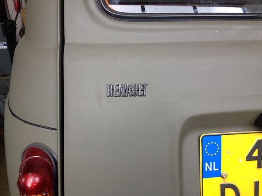

She's ready for MOT.

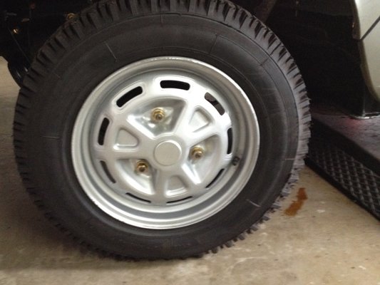

And after searching for 2,5 years I finally found the centre caps for the Gordini rims.
So hopefully Friday next week, I'll be driving a Sinpar Renault 4TL
