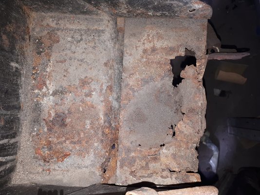

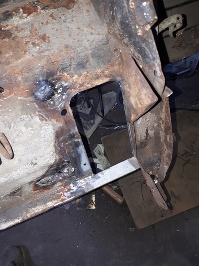

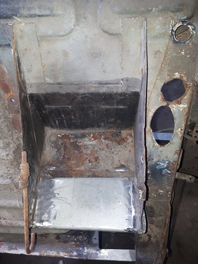

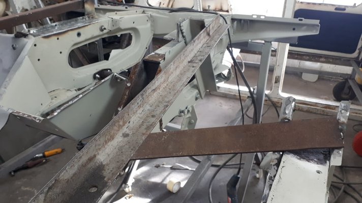

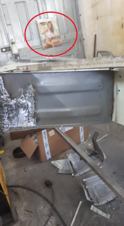

Any hints on this repair please?

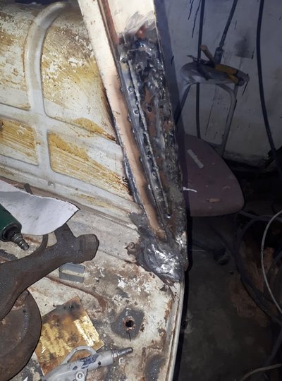

Do you have any link to it by any chance?ThanksThere is whole rear boot floor section available to buy as repair panel
Hi thanks still cant come to which part i should go forFranzose have it
Here is link to rear body repair panels.
Discover for Renault R4 | Oldtimer parts
Explore a wide range of for Renault R4. High-quality spare parts and fast delivery await you!www.franzose.de

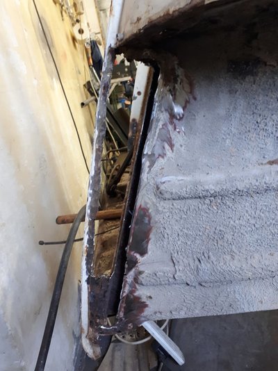

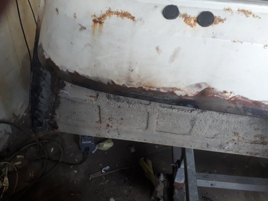

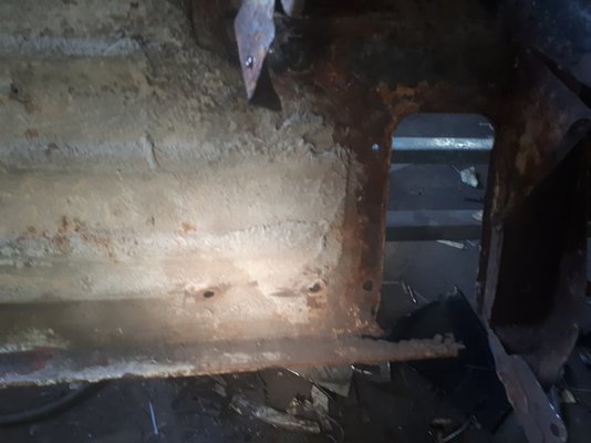

Thanks a lot very helpful!This is lower part. From outside. Under the booth
R4 rear panel repair sheet metal under the luggage compartment sill)
Fast deliver from our web shop! Suitable for Renault R4. Made in Europewww.franzose.de

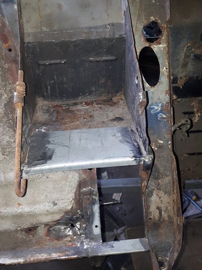

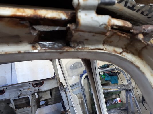

This is upper part. Inside the booth
R4 Rear end panel repair sheet metal luggage compartment edge rear
Fast deliver from our web shop! about 15cm deep). Suitable for Renault R4. Made in Europewww.franzose.de

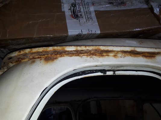

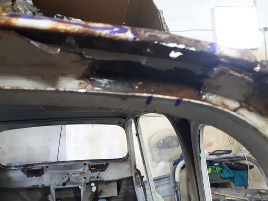

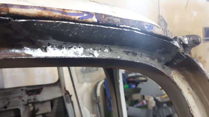

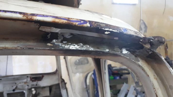

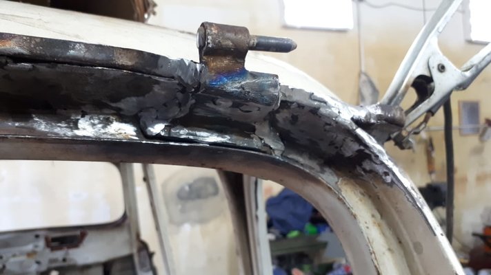

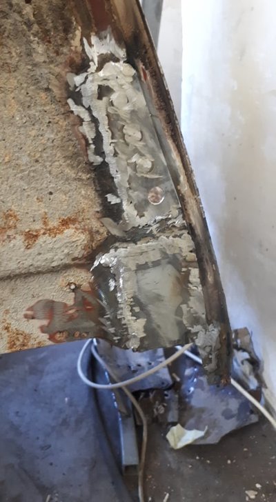

When i have needed to repair a gutter i have used a donor piece which goes into the roof about an inch and joggled the edge so that it goes underneath at roof edge and sits correctly,this gives a strong easily welded joint and is easier that rtraying to but weld. I do it this way as it being easy to hide in the roof area than to get a good appearance at the gutter. I did one whole side on a split screen VW once and you could not tell once completed and headlining in.What did you do for the roof gutters? It's a particularly hard place to fix.
The roof gutter was not damaged as only underneath it there was rust, so gutter remained untouched, in the last repair above the tailgate hinge i have rot on the gutter(haven't repaired it yet), what i usually do to repair gutters is to use a metal round bar shape/grind as close as possible to the factory shape and hammer sheet metal to give it shape.Hope that makes sense.What did you do for the roof gutters? It's a particularly hard place to fix.

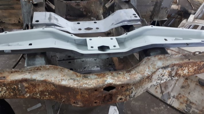

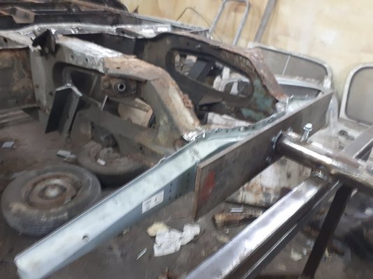

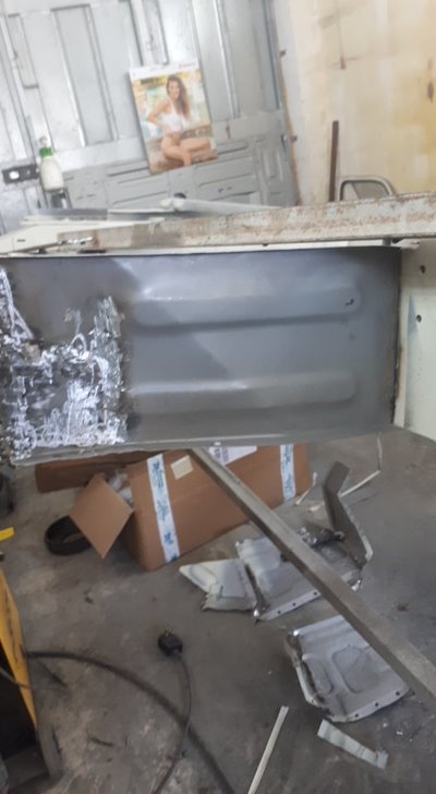

Thanks alot for your comments, i dont have much tools just the basics hammer/dolly,a good vice and a self made heavy duty bender on it, a mig welder, dent puller,spot welder and a shrinker/strecher whis i am still learning how to use.Nice progress and workmanship!
From Sweden myself so used to rotten metall due to salted roads and long snowy winters. It seems like Renaults here was given a serious rost protection before they were sold and the owners top it up during lifespan. All my cars seems to survive rot death better than a lot of cars from south Europe. Usually it's the other way around.
Very impressed with your skills and stamina. Would like to see more from how you make the new panels. What tools you are using, how your jigg is bolted to chassis etc etc.
