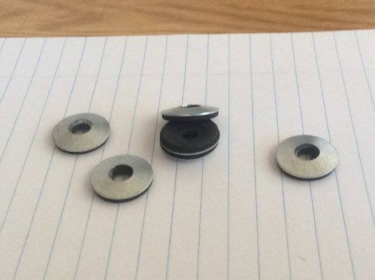

There are washers available at hardware stores here for roofing purposes that are like slightly domed spreadwashers with rubber bonded to the underside which is a tight fit over the thread, under a nut they provide a seal on the surface bolted to and thread, two may suit purpose.
Nuts are brass/copper nuts with a spread base.

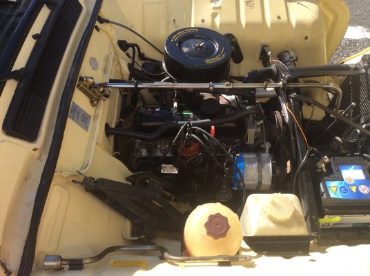

Pic. of washers mentioned earlier in thread,
Those look really impressive at stopping leaks better than normal french spec
