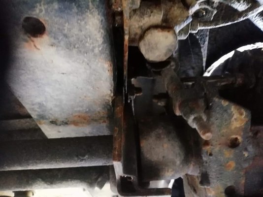

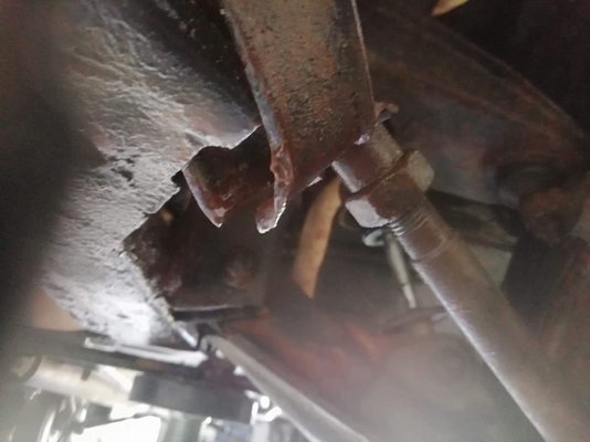

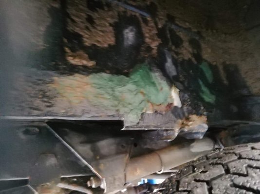

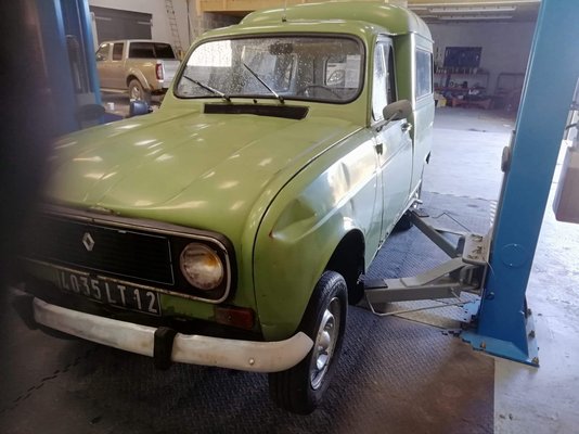

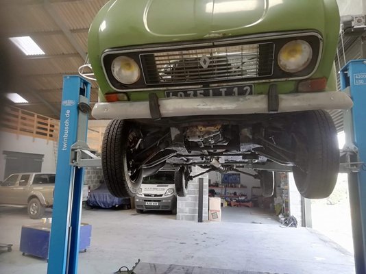

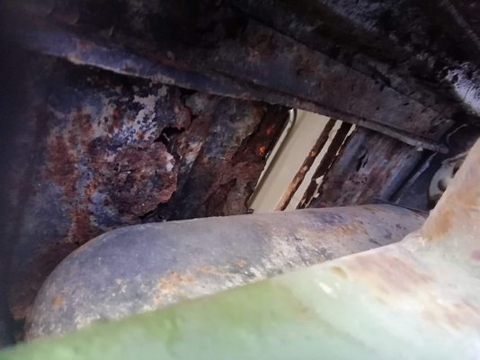

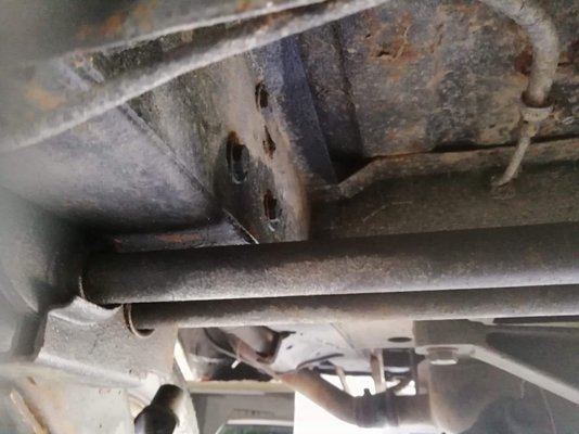

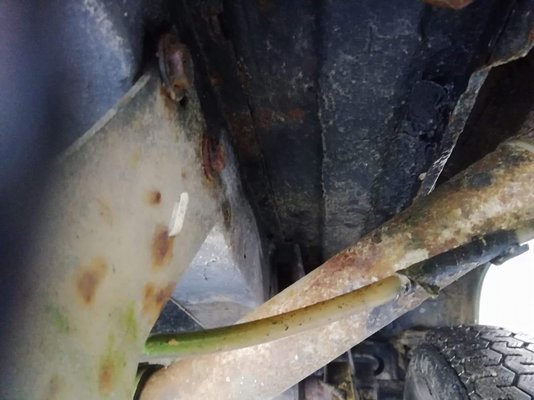

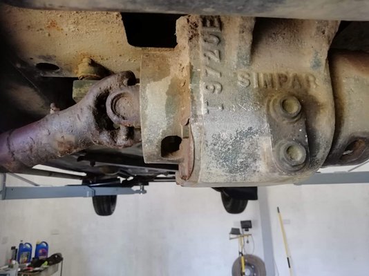

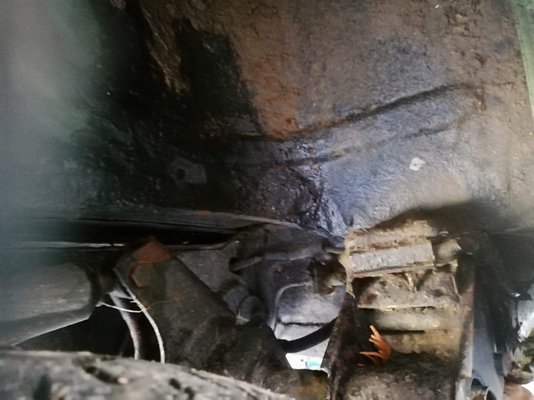

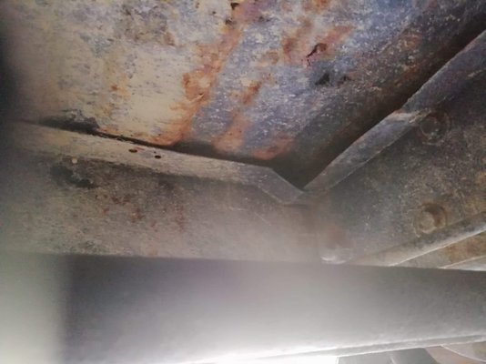

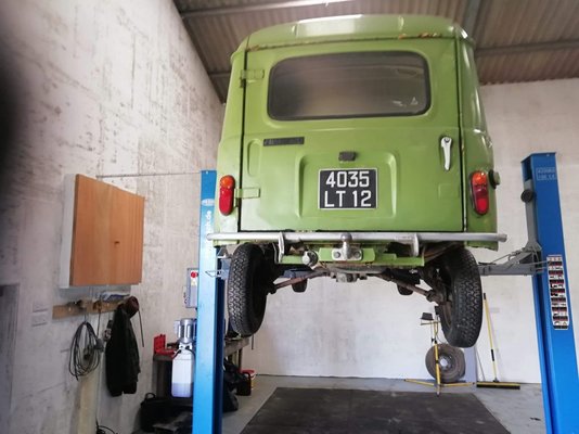

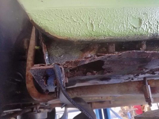

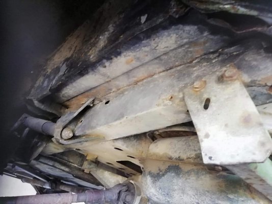

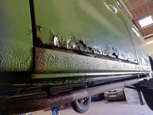

Lots of work ahead ,drive shaft removed,don't know why yet,would it be any use me posting regular updates with each problem found.

Good luck with all the work that lays ahead for you.
Now for the good news. You’ve got the faster version. Gear ratio in the back diff is 8x33. Don’t expect hair raising speeds. But on the road it will keep up with most oap’s;) But it is a little weaker in terrain.
