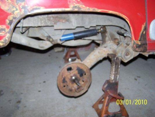

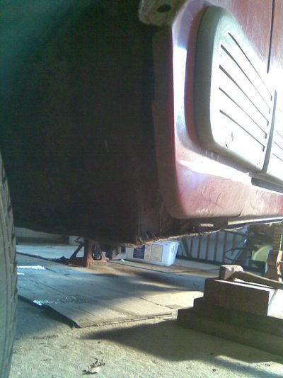

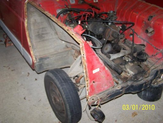

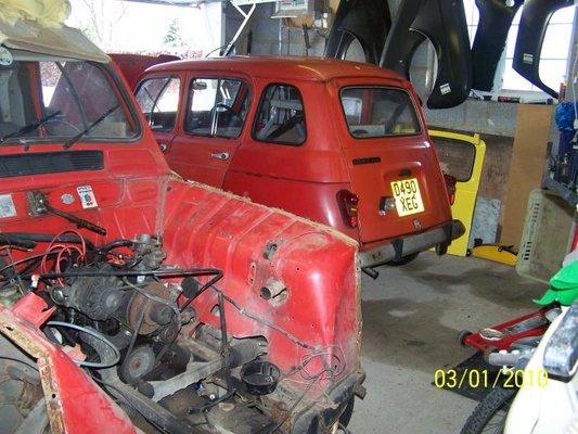

weathers been awful and it's been to cold in my garage ( it's not as plush as David's ) anyway it's getting warmer in there so i've made a start on my other R4, much too much needs doing ( 4 wings, all new brakes, pipes,wheel bearings, exhaust and a clutch ) should'nt take to long if the weather does'nt get to cold again.

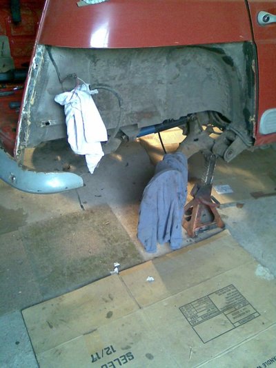

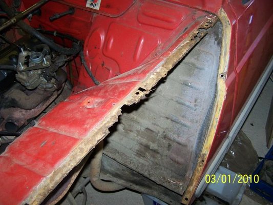

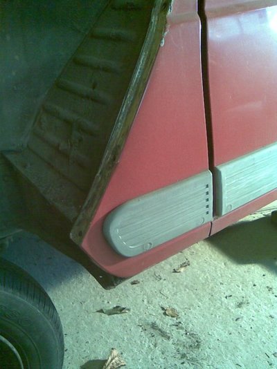

well, i've done the handbrake cables and bearings and brakes and now started to put a new rear wing on one side, also does anyone know the best way to repair the corner behind the front nearside A panel as space is very limited or do i have to take off the A panel ( which i think is going to be the best way ).

It's possible to bend the bottom of the apex panel out of the way for welding access. then bend it back again afterwards fairly neatly. The plastic side panels hide the bend surprisingly well.
I recall welding the front part of the chassis on Rosalie using that method, so well worth a look at her for how it would end up.
Body looks quite rust free - must have been on it's original wings?
Hi Malcolm, thanks, and i did think of that but was'nt sure if it would bend back neatly enough and yes i think they where all original wings, it has only the three small holes one at the front and two just inside on the boot floor and no repairs on the floorpan anywhere underneath.
