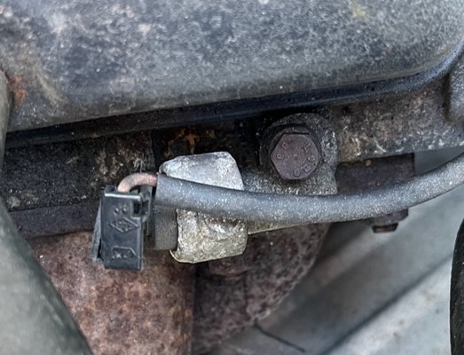

The temperature warning light comes on sometimes on our R4F6 (1108cc), but water levels in rad and expansion bottle are fine, not boiling or anything, fan kicks in too, so suspect an iffy sensor, pictured here, on near side of engine block. Anyone have a spare new one or know where to get one from to try? Seen one listed on ebay but looks a different fitting despite saying for a R4 1108 engine. Any help appreciated. Cheers Lou
Searching for part number 0855493500
https://www.palace-de-lancienne.com/products/sonde-indicatrice-de-surchauffe/ may also have it second hand and Huart Benoît is always friendly and helpfull.
Beware that the temperature sensor from a Cleon engine is different than from a Billancourt engine!
Never buy from all4renault that company is a fraud.
Thanks, got a used one coming, hopefully does the trick. Messaged Huart too, yes helpful and can get used from there too. Cheers
