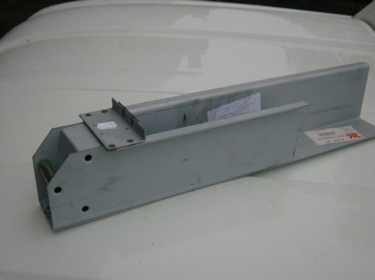

Are these rear ends available

wind classics nl list these bits for 68.50 eros (pic coutesy of website)no mention of longerons :confused:
so do warny in belgium no price i could find though
(dont you read the sticky threads malcolm has kindly put up for us )
think you need to be pretty accurate measuring if you replace these bits as rear alignment is pretty important much easier with body off though - must learn to weld someday

I'd tend to repair that sort of thing if the rest of the chassis is good. Those repair sections MrReno posted would be a good idea as otherwise you'd be cutting out and fabricating about the same amount of metal. Here's one I did earlier (home fabricating rather than using repair sections).

I should hold onto it but don't repair it unless you need to use it. I've got a couple of chassis leaning against the wall of the lean to, one of which I've robbed the front crossmember. They don't take up much space when you have the suspension off.
Oh - got the jist now. For my "as new renovation" I'm go around all the double skinned bits and replacing them with single skin. A bit of rust gives you a head start.
i think malcolm means removing patch work repairs (over rusty bits) commonly done to quick fix mot rust patches as cutting too many rusty bits away on low value cars gets scary and underseal is much cheaper

Double skins were only put in for manufacturing reasons - like to have a strong piece of chassis without making the whole chassis really heavy. I have a habit of cutting both skins out and replacing them with a single thicker skin. See http://www.renault4.co.uk/renault-4-restoration.htm for the sort of thing I tend to do.
There would be issues with doing this in high fatigue areas, but better than a big rusty mess which is what double skins leave you with after a very few years without showing external signs of the failure.
