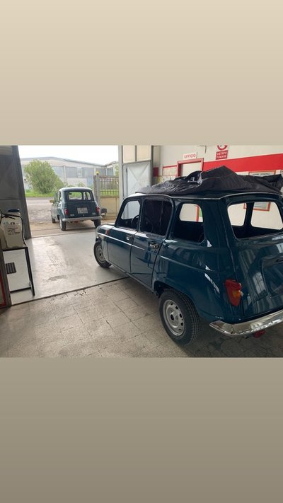

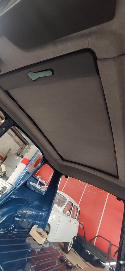

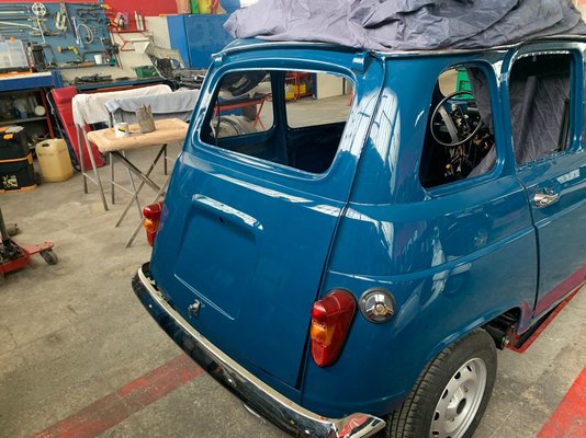

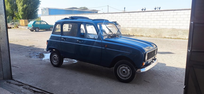

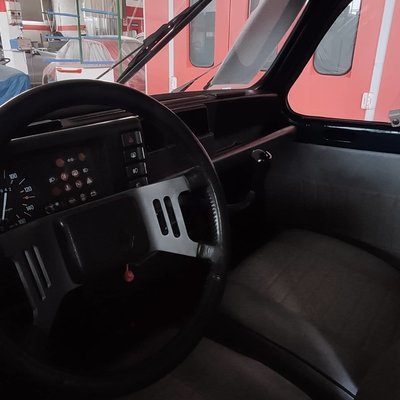

I finally put the roof lining together.
I asked for a gray colour to match the interior of the Twingo sunroof.

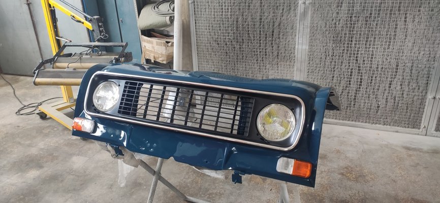

The car was born with the reverse lights on the rear bonnet, but I wanted a clean bonnet and a reverse light, so I found a reverse light to match the original fog light in my car and I designed and printed a couple of supports:
In the end I managed to install all the bits on the bonnet, I really like the black grille!

Must agree with Malcolm
That roof lining is great.
How did you do it?
On one R4 that have twingo roof guy left everithing else without lining and i did not like that.
Even thinking to make some for rear part of F4s roof as i would like to cover bear metal and put some insulation between.

Thank you all!
Honestly it isn't a big job, as soon as I decided to install the sunroof I took away all the bits for the original fabric lining on the body of the car.
I found a good older plastic roof lining, cut it to being able to install it with the twingo sunroof and made it painting in gray like the sunroof interior.
The lining around the roof are the original twingo one, I just put some spacer on the joints (obviosuly, i printed them :laughing: ) to make it follow the roof.
