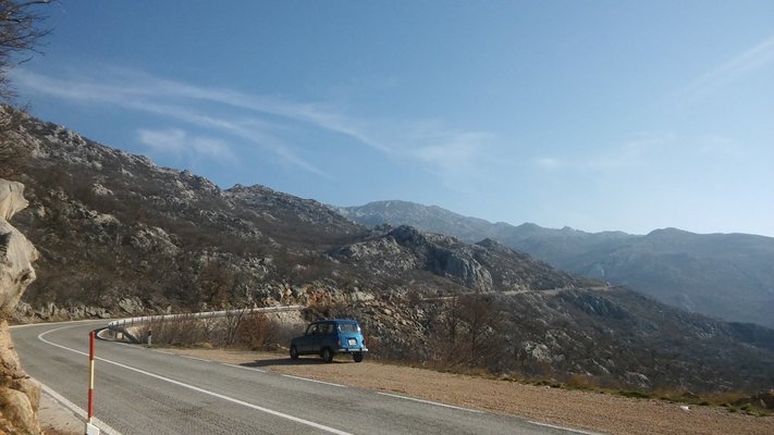

One picture on my way to Zagreb between Obrovac and Gračac...long steep uphill and downhill over Velebit mountain with hard corners and road that is carved into Velebit mountain.
