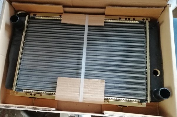

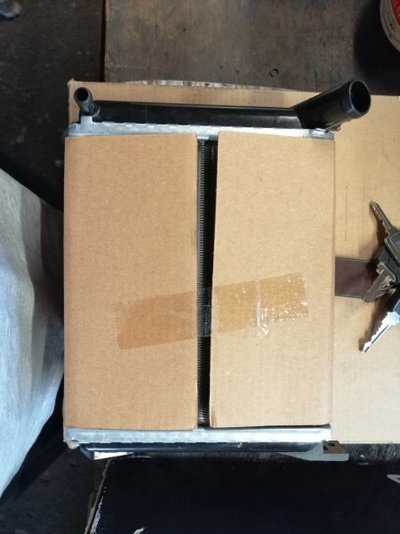

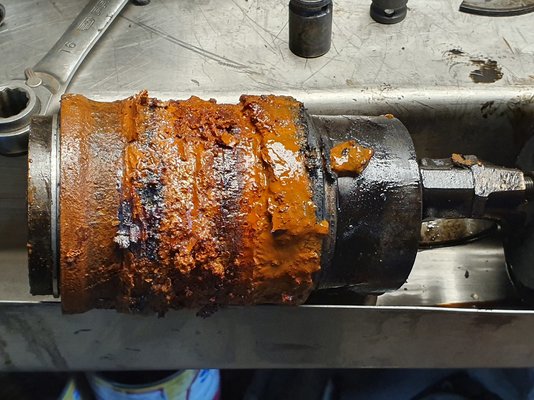

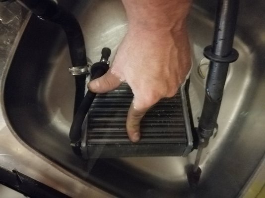

Radiator change on menu

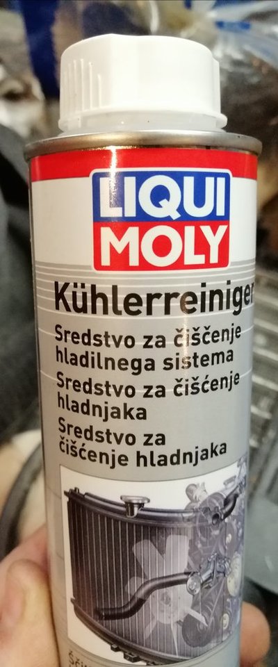

But before that i decided to flush cooling system with Liqui Moly
Bottle is enought for 10 liters. R4's cooling system is cca 4 liters so I had enough for two flushing.
Third flush i have done with destiled water.
After flushing i take off old radiator and put new one.

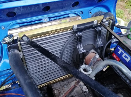

Here, everithing is finished already.
New radiator in place, antifriz put inside, system bleeded, ventilator is happily start to spin at 94-95°

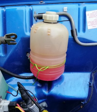

Fresh pink antifriz inside bottle. Will see how long will stay pink.

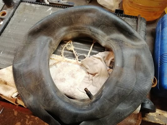

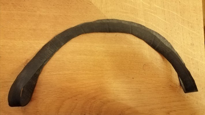

Also used oportunity to make new rubber stripe for bottle. Out of troley wheel inner tube
Rubber stripe
