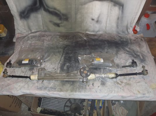

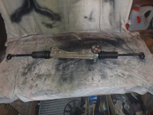

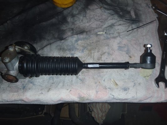

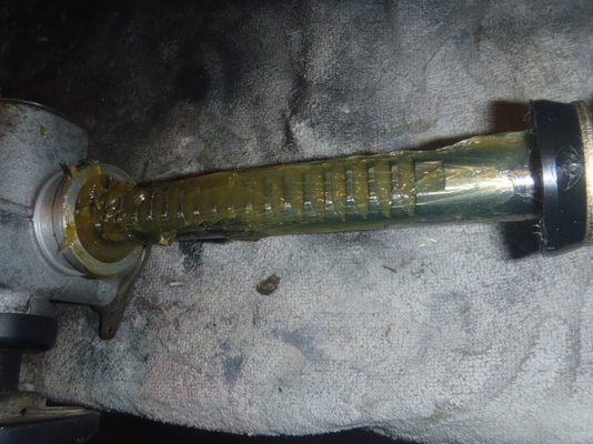

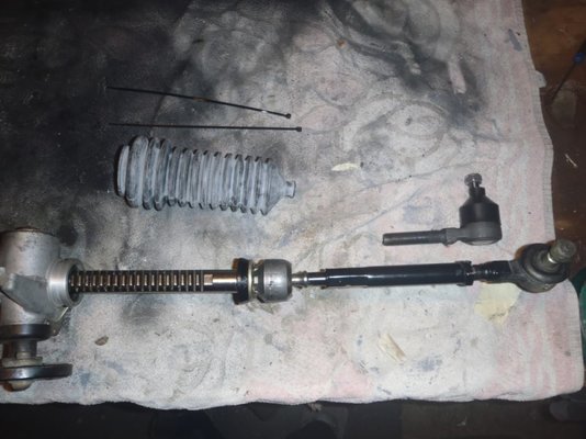

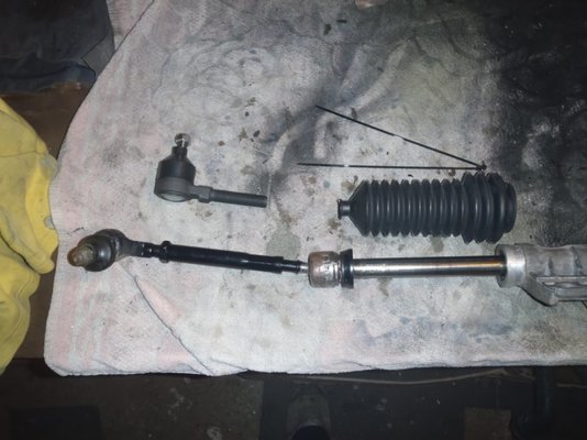

Steering rack

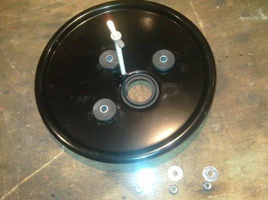

Still did not mounted it on car because i am waiting nuts and bolt to get back from galvanizing

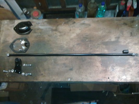

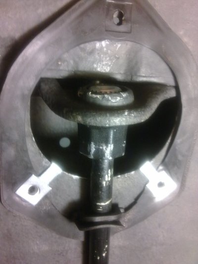

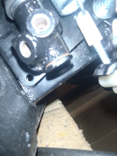

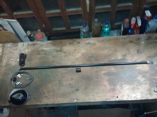

rear brake compensator in place

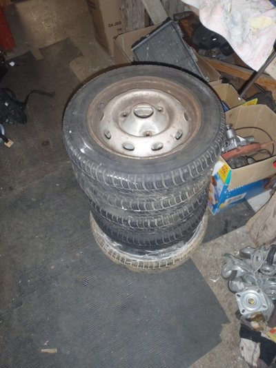

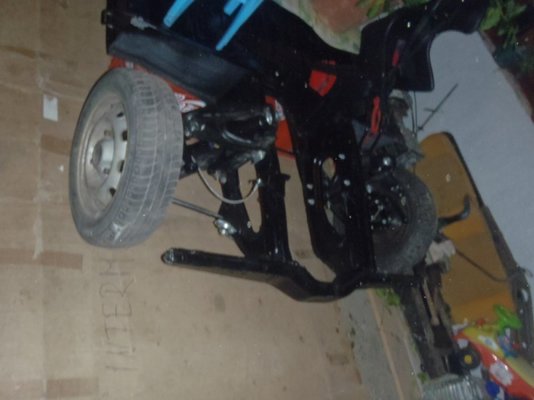

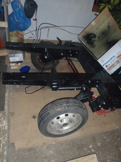

Wheels for chassis
rear end
front end
At the moment car is looking ridiculous.
Rear end is far to much in the air, and front end basically at the floor.
I still did not put front torsion bars, but planing to do so right away after Christmas

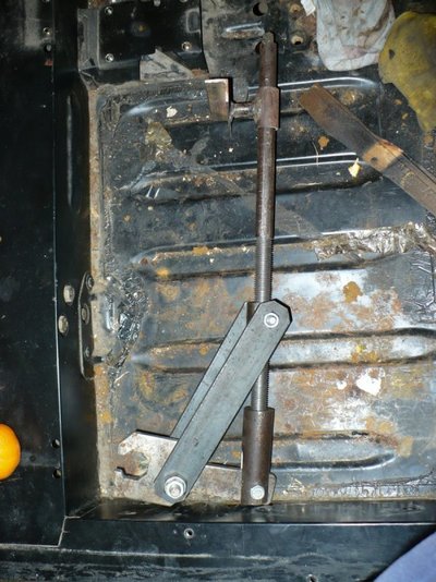

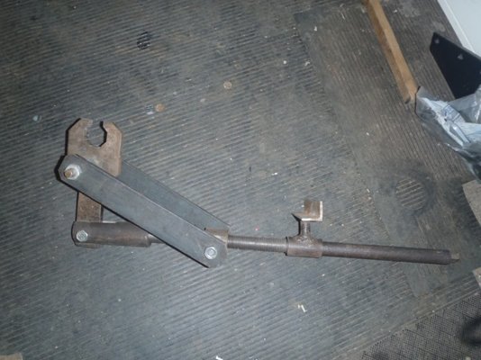

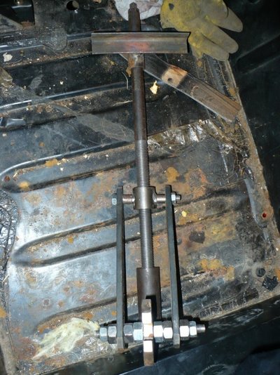

Even get myself THE "tool"
Made by friend of mine here in Šibenik who is also freak for R4

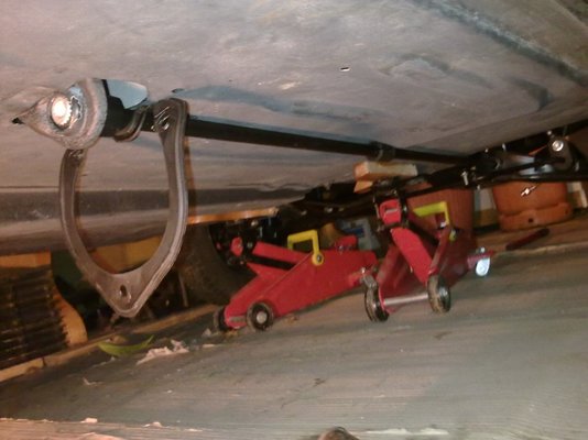

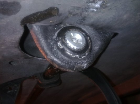

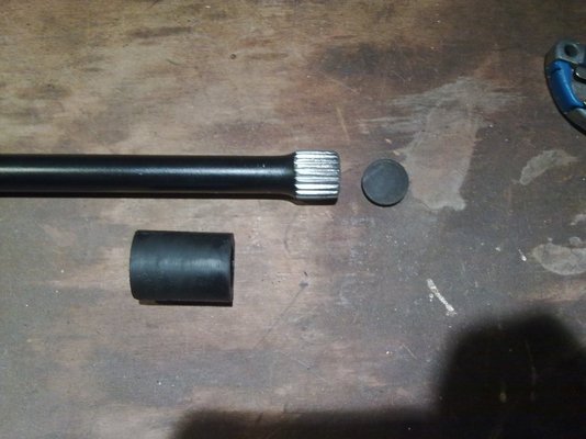

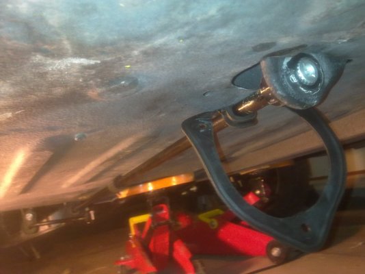

font torsion bars are in place!

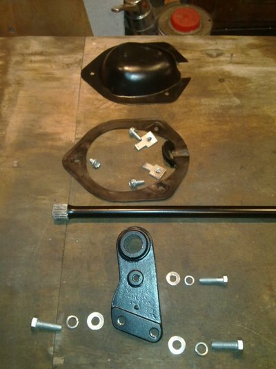

Right one. All necessary bits prepared
In place
closing rear bracket
Finished
Left one!

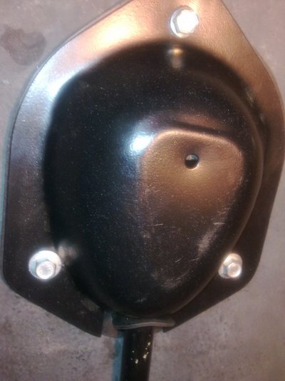

Bits and peaces
mounted on chassis
Final touch
I must say that it was very easy to mount torsion bars.
Maybe due to fact that chassis is empty.
Maybe because i had "THE" tool
There is still to see how hight adjustment will go after everything is in place

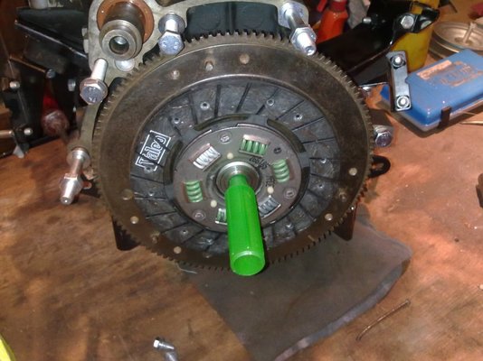

Next step is to put flywheel, clutch kit on engine and connect gearbox to engine.
Have some doughs about flywheel.
How to position flywheel correctly?

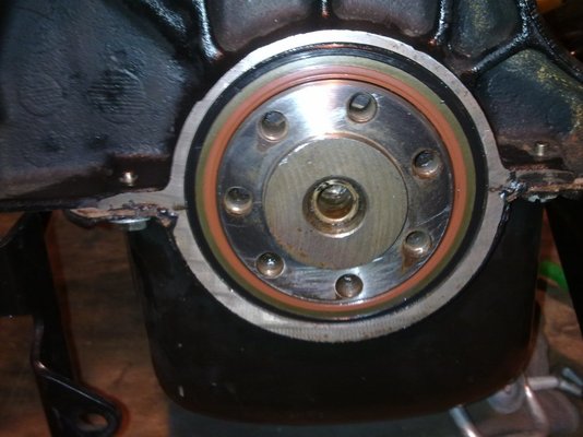

And I need to change seal around crankshaft
Happy news!

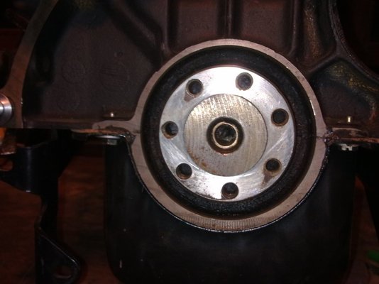

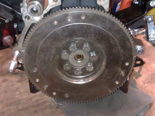

On 688 engine flywheel can fit only in one way.
Bolt hols are not simetircal so there is only one position to put flywheel and put all 6 bolts in place.
Yesterday was an easy day for my R4 puzzle game.

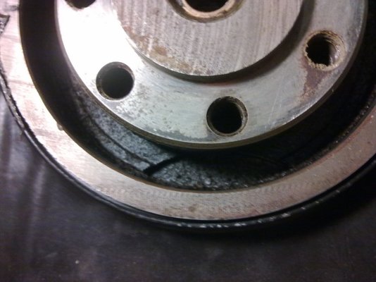

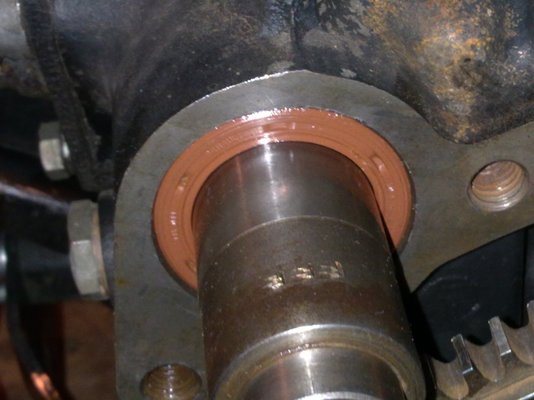

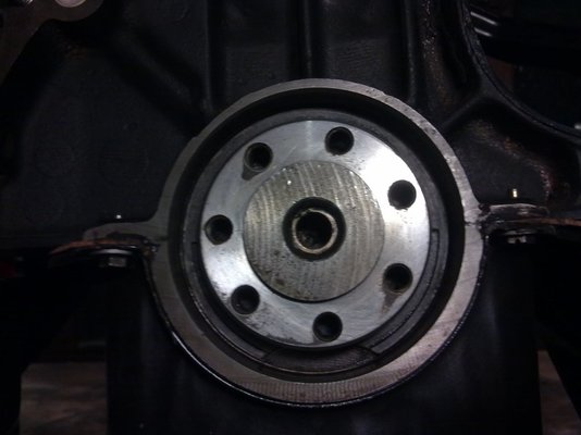

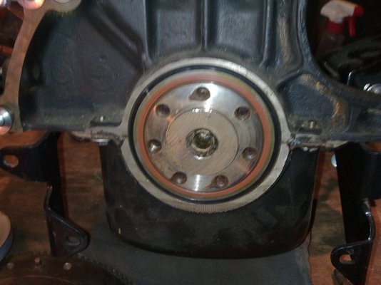

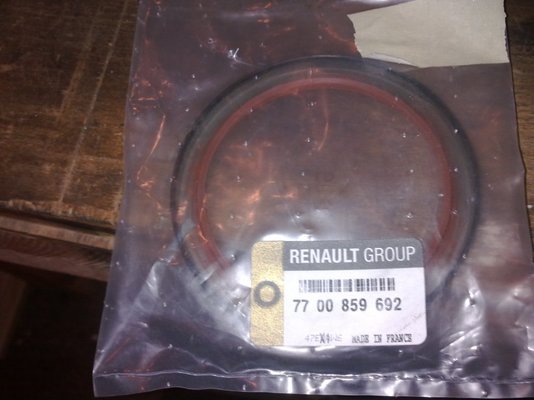

Crankshaft and camshaft seal change, flywheel and clutch installation.
Old cam shaft seal
old crankshaft seal
Actually, they were looking alright to me, but i have changed them just to be on safe side.
I would hate myself if i found out that engine is drooling oil after all this work.
Now all seals around engine are new.
new camshaft seal
crankshaft without seal
new camshaft seal

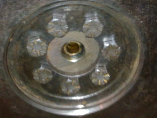

flywheel in place

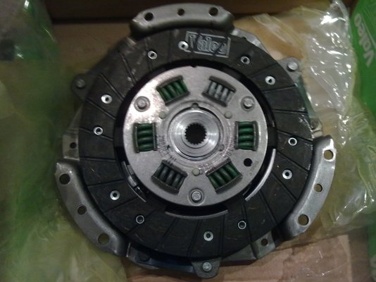

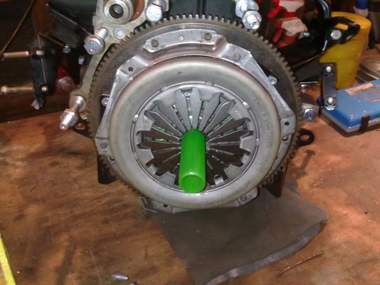

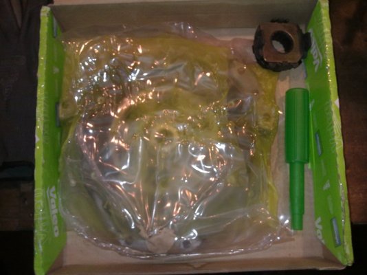

Valeo 3 piece clutch kit
Clutch alignment

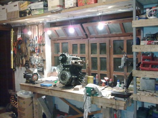

My workstation with beauty!

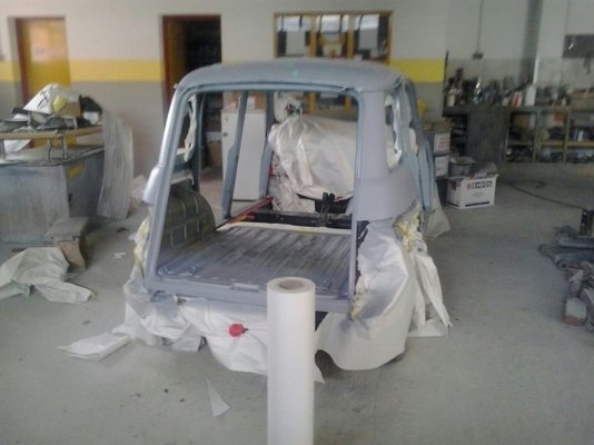

At the moment i have few small things to finish before i can take chassis back to body worker so that he can put body back on chassis and align all doors, bonnet, front fenders

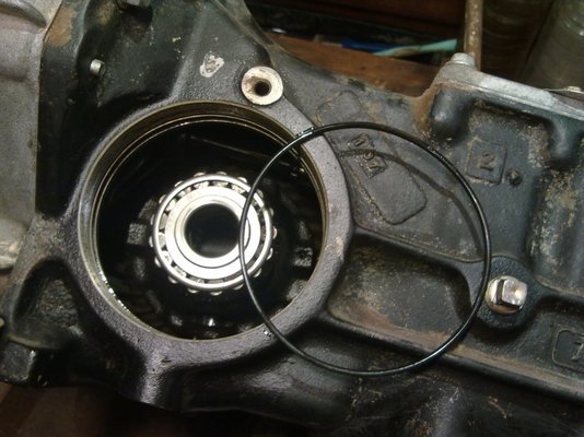

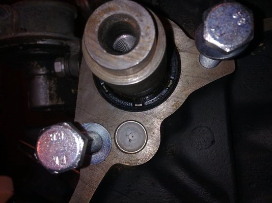

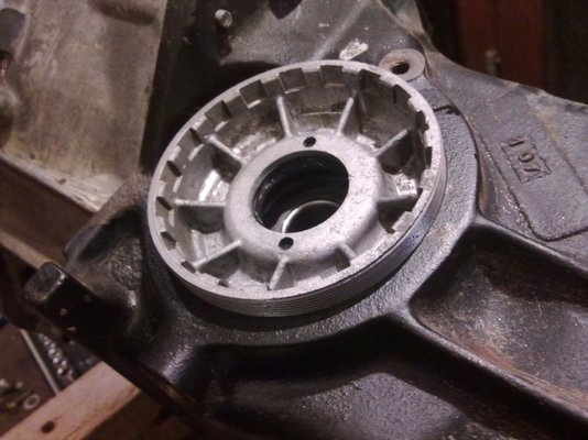

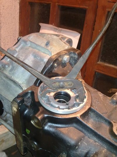

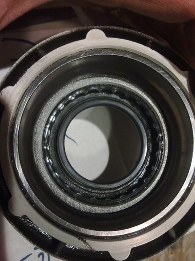

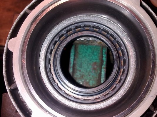

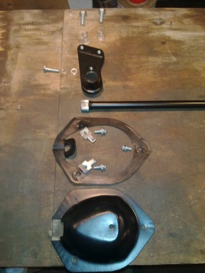

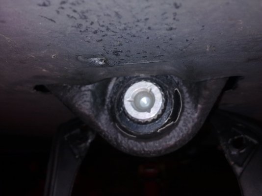

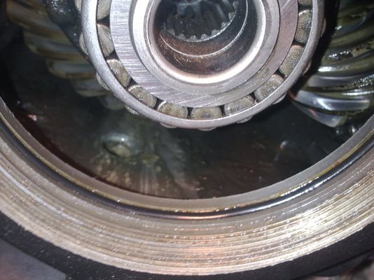

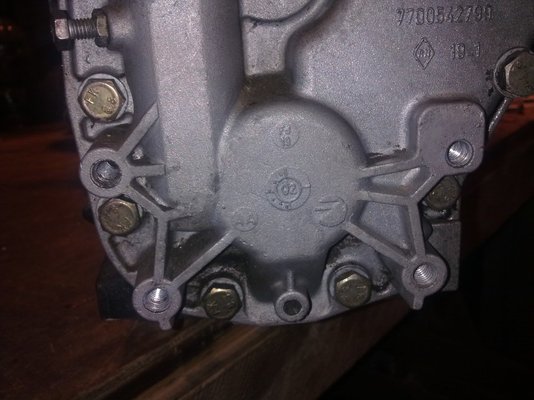

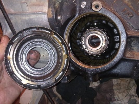

Changed semering and oil seal on gearbox where driveshafts are coming
Before start
"Tool" for opening and closing
Opened
Closer look

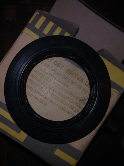

Semering
Oil seal
Closing

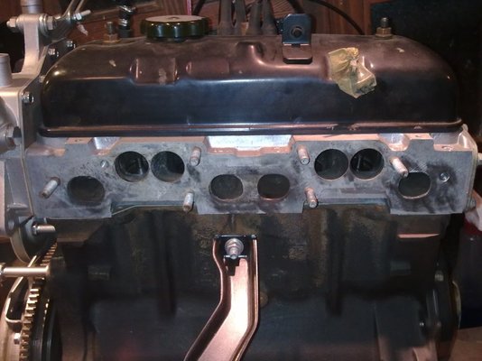

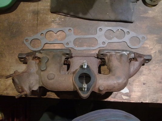

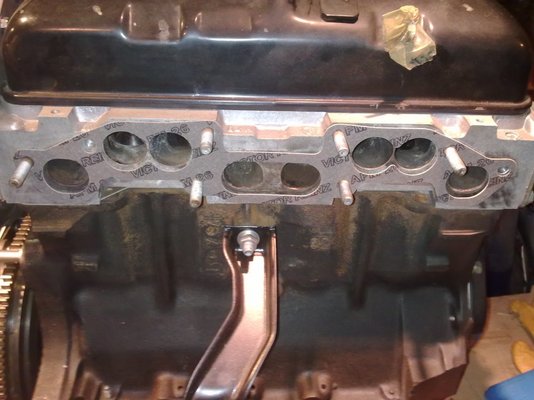

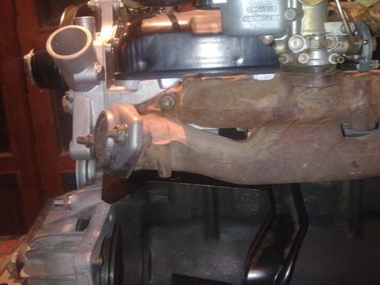

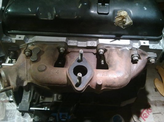

Installation of inlet/exhaust manifold
Peace and gasket
Place for mounting
Gasket in place
Manifold in place
Heat protection (do not know real purpose of it)
Protection in place (little hard to notice because it is behind manifold)

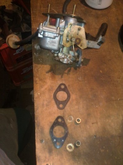

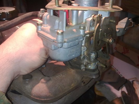

Carburetor put in place
Gaskets
In place

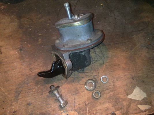

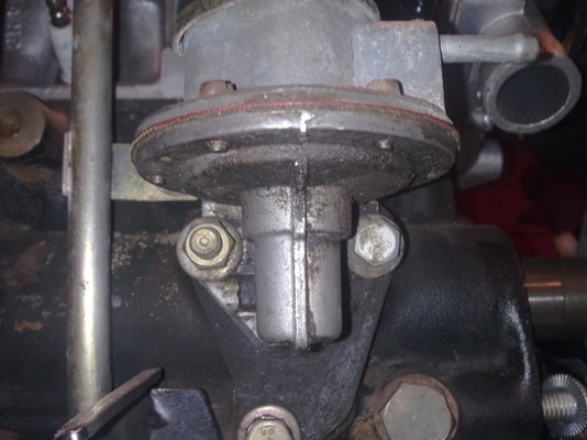

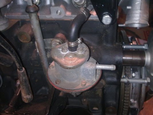

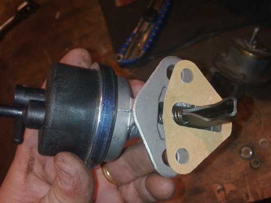

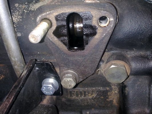

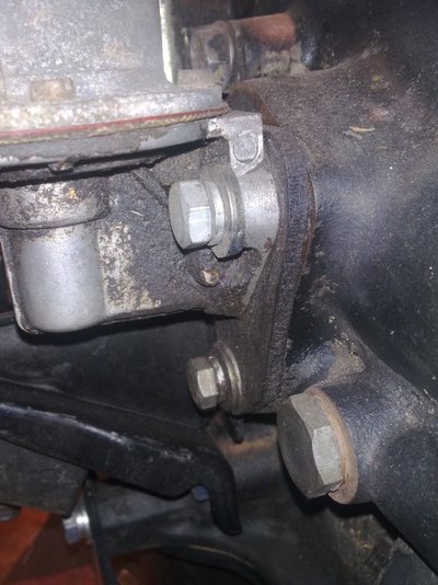

Fuel pump changed
Old one on engine
Hole in engine for fuel pump
Old pump on her own
New fuel pump with gasket

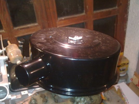

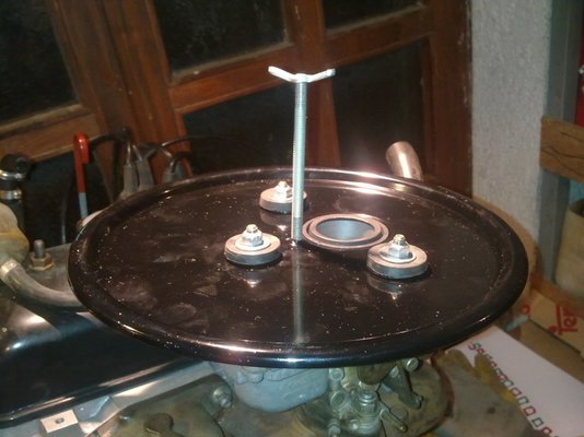

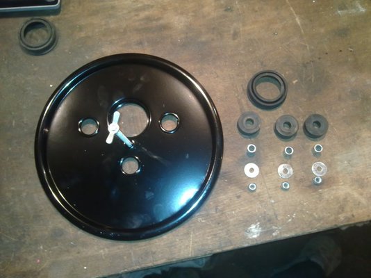

Filter housing (old paint striped down, send to galvanizing, and powder coating)
Rubbers in place
In place
With cower

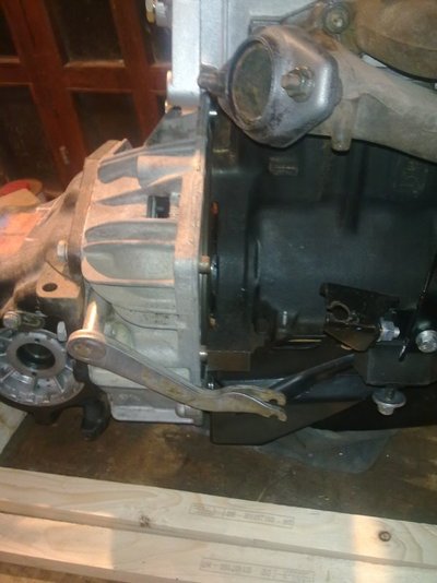

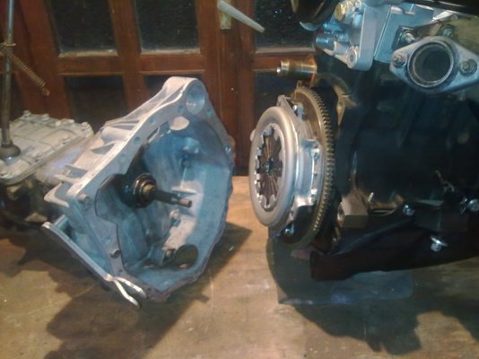

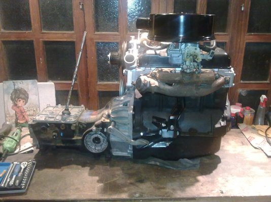

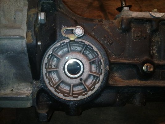

gearbox and engine join together after more than two years
Looking each other
Joint
Bolted on

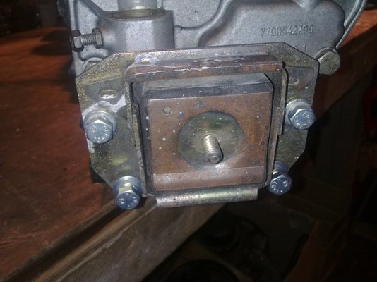

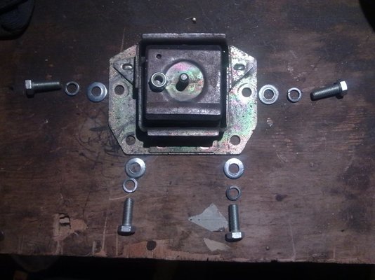

Front mounting
Place to bolt mounting on gearbox
everything in place

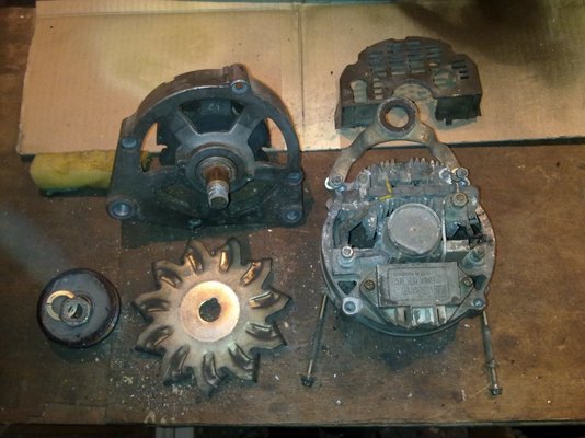

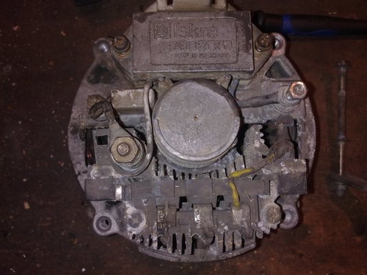

Some work on electricity

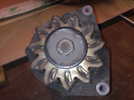

Alternator
In peaces
