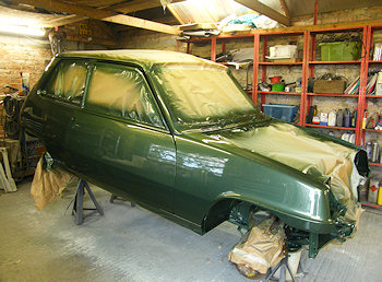

Painting
The best time to paint a car is the summer, but somehow paint always organises itself into a mid winter timeslot.
Preparation took as long as the rest of the project so far, but the paint went on in a day in mid October before it got too cold and wet. Normally I'll have some paint disaster that will hold me up for months but this one went really well.
Painting

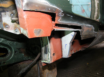

Battery tray and longeron welding
Ideally you'd aim to finish all of the welding before starting paint. I've still got a few bits to finish off on the battery tray and longerons (but to be fair I've not painted those bits yet).
The plan is to complete the welding and paint the underside, then refit the interior before starting on the engine. To me welding and metal bothering is fun but the engine rebuilding stuff is a chore so it's good to put it off a little longer.
More welding - battery tray and longerons
