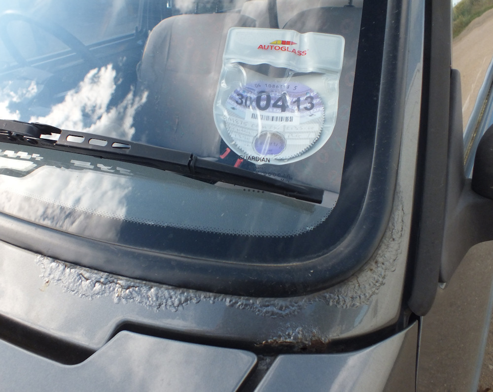

The leaks are from around the windscreen. Some monkey replaced it in the past very badly. The sealant is all over the place and the screen surround must have been left in bare metal after they hacked the old screen out. It will be a right pain to fix the rust so the car might be dead.
Oddly enough the tax disc holder was provided by a windscreen replacement company.

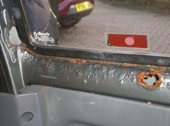

It had failed the MOT on rust around the rear side window too close to the seatbelt mounting. I fixed that in a couple of hours, replaced the rear brakes and a wheel bearing, and put the car through the MOT. At some point I might do an oil change too as the engine will go in a Renault 4 if the R5 ever dies.

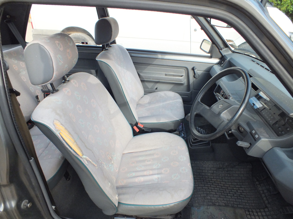

The interior is surprisingly worn for a 65,000 mile car. The steering wheel is cracked and the fabric has worn away from the seat bolster. The front seats are both water stained too.

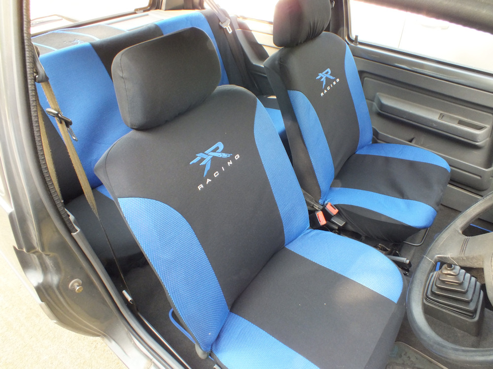

I fixed the interior by adding some seat covers. They come with matching floor mats for £20 on eBay and add something of a boy racer look to the car.
