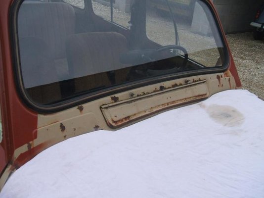

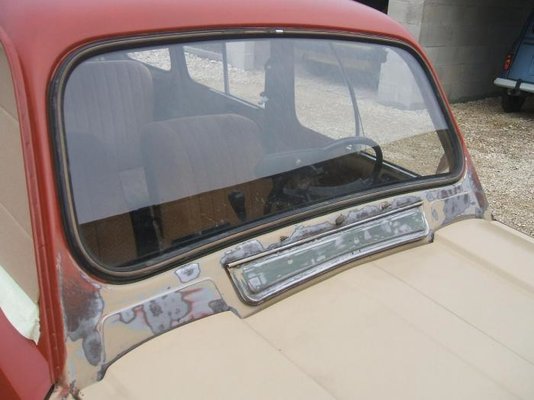

Today the temperature was exceptionaly "hot", 10°C :cool: :cool: So I sanded the other rusty parts: the rear panel and the bulkhead, under the windscreen:
Contrary to the doors I made that by hand, and only with eccentric sander, 80, 120 and 180; the result is the surface is smooth and without defect or hollows. Good job but longer than last times with the grinder :shock:

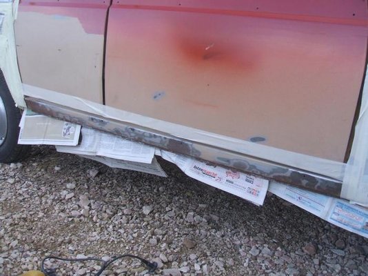

Today the temperature was about 10°C, so I decided to finish the job with the Rustol, I started to sand the right rocker panel, bad surprises on it, during sanding several little holes appeared :mad:

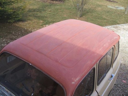

The surface of the roof also didn't suit me, so I sanded it with 180 before applying a last thin coat of Rustol.

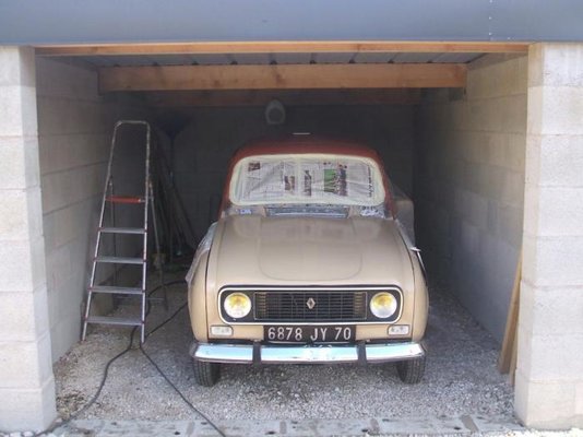

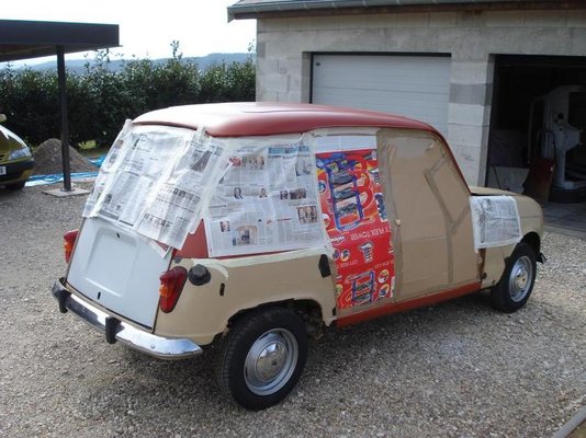

The wind was very strong today, so I painted the car in my outer little garage.

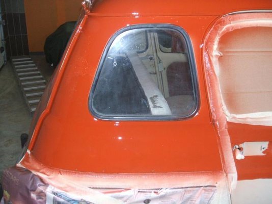

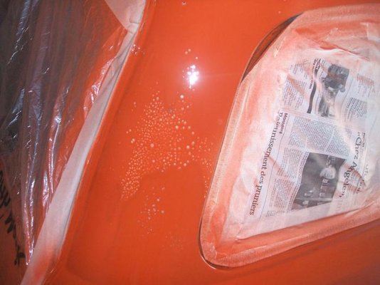

Few minutes after starting the job... disaster on the top of the rear panel :eek: :eek:

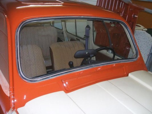

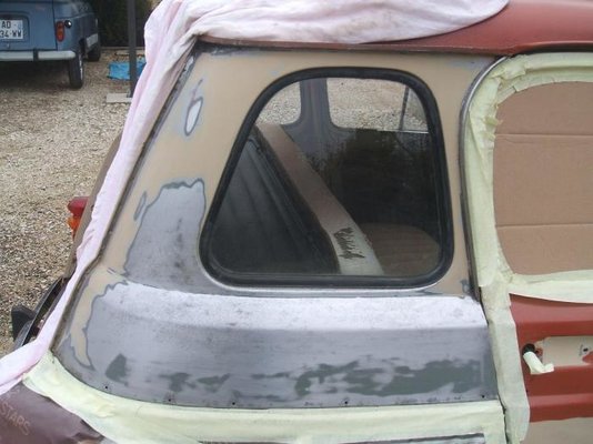

I finished the job before parking the car in the house garage, I'm going to leave the paint drying before applying a primer.
Can anybody here tell me what I can do with problem exposed above ??...
Hey Alexandre, that looks an awful lot like silicone contamination! The dots in paint that are caused by silicone contamination are often referred to as "fisheyes". Those are caused by silicone on the surface that you want to paint. The paint doesn't attach to silicone and it actually repulsed by silicone, leaving little dots where no paint sticks on.
You can avoid fisheyes in your paint by using a good degreasingproduct with silicon remover in it. I used M600, which is a degreasingproduct from Motip, don't know if that brand is known outside the Netherlands. But that also takes care of silicone contamination.
It might also be caused by some other source of contamination. Can you remember using any kind of spray or cleaning/polishing product on that spot of your car? It might well be that you didn't fully manage to remove it. What do you use for cleaning and degreasing your car before painting?
PS: Polishing products may be especially nasty to remove from surfaces you want to paint. I used one that, even after i thouroughly removed it, left fisheye-like spots on that particular panel.
Oh, about any sulotion to the problem ...
I think you best wait till the paint dries, then clean the surface really well with some degreaser/silicone remover, then sand the area down again so you remove all the contamination and then respray it.

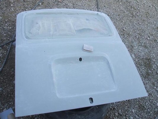

recently I decided to make a test on the rear door, considering I still really don't know how to correct the little holes due to rust, I wanted to see if I could apply this famous filler primer on my Rustol whithout problem...
The rear door is damaged inside, I will have to cut the rusty areas and make patches in steel sheet, so if my test is a disaster, it doesn't matter :rolleyes:

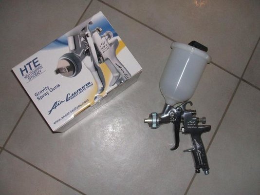

I bought a gravity spray gun with 2,5 mm nozzle to make good job, then I started to sand the Rustol with 240 dry paper to improve the adherence of the filler primer:

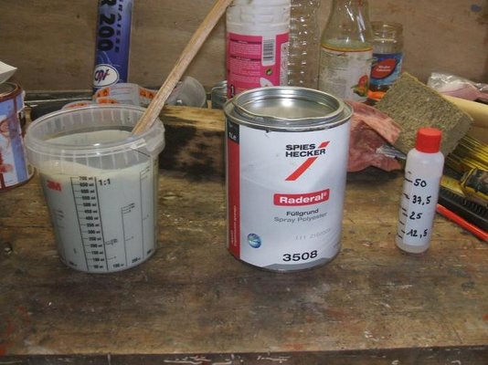

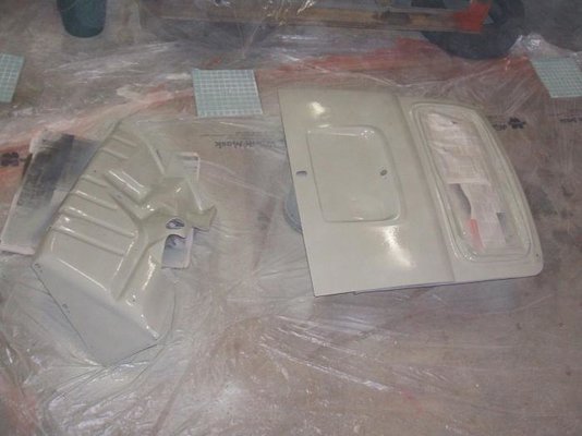

Here is the product I used, the Raderal 3508 from Spies Hecker, I spayed the rear door of my 77 in the same time than the fiberglas wings and inner wings of my GTL:

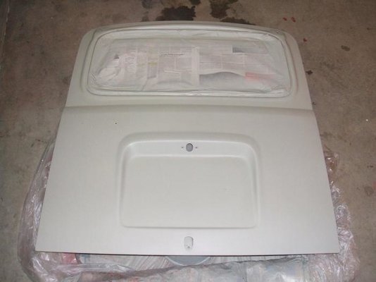

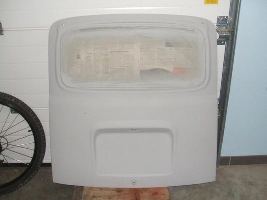

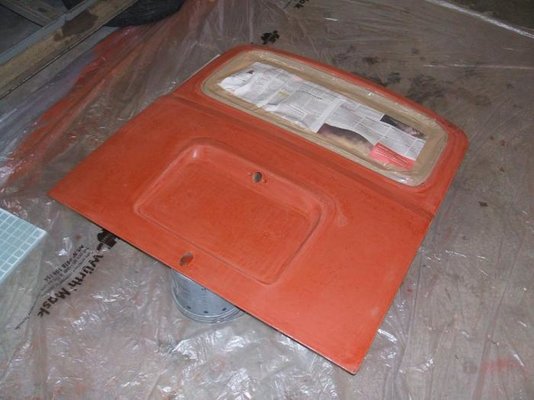

After 2 coats with about 15 min between each one, the rear door is now primary coated, and the good surprise, contrary to the speech of the seller, the Rustol doesn't peel off, all seems to be ok :D :D And the famous result I waited for is that the holes disappeared under this "liquid filler" :hug: :hug:
After fews days I sanded it with 240, and then 400 dry paper before applying the final coat of PPG primer, it is now ready to paint, I hope it won't have reaction in long time, actually none fault is present...

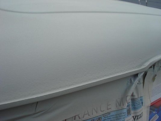

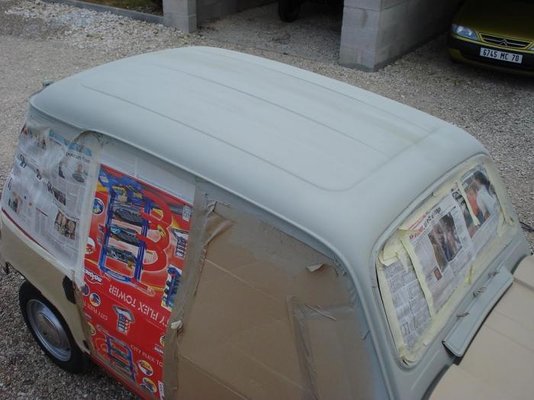

This saturday I decided to make the same job on the roof, so I did the same as the rear door:
Some holes are still present but I think when I will sand the primer, its thickness will allow to remove them.
We use a product called stopper here to fill what we call pitting, if isn't quite a hole but needs to be smoothed out otherwise it will really show through in the top coats!
It's looking really good! I would use ordinary body filler on the rust pitting as the primer won't be thick enough to hide the pitting.
My experience is that those fillers are pretty thick and if you don't mind spending some money on it, it might be worthwile to apply a few coats of it, sanding each one of them down to flatten out the surface, before applying the next coat. At least, if there is a big surface affected by pitting. Might actually safe a lot of time compared to using regular body filler (knifing putty) because you can make nice, even layers.
I'm curious about the eventual result and I hope the whole 2k-on-top-of-Rustol thing will turn out to also not cause problems in the future!
