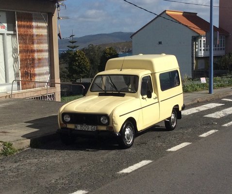

Finally commited myself to a weekend on foot, so tint now installed on rear windows, happy its not too dark, passenger seems content with no tint..47C03155-9E4A-401A-A135-0D80F4121C32.jpeg

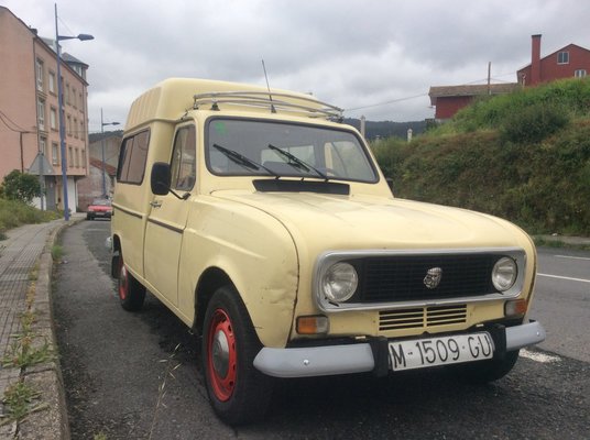

My ‘classified ads photo’ for Mr. Magoo, (wash and take pic before its dry, sun and water to give it an unreal shine ;) ), all I need now is an ‘Arthur Dayley car sales’ sticker for back window.

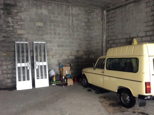

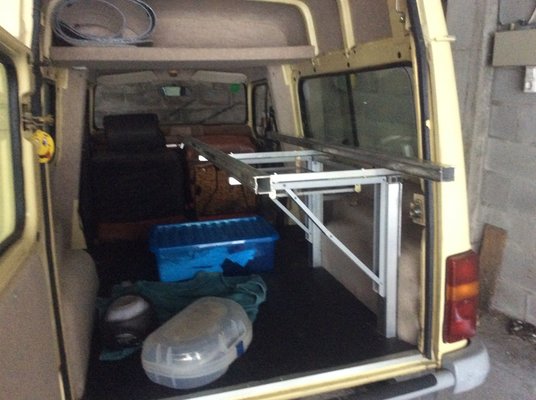

Well after trolling round aluminium supply yards here and not being too impressed with the thickness ( ie strength) of the various tubing/boxing on offer to constuct the intended stretcher bed for rear of van, bit of left field thinking, bought these today for the princely sum of €15, ( been walking through shop/cafe doors thinking ‘ thats what I need), bit of deconstruction before construction and probably double or more of the amount of necessary material, happier with the intergral strength, its thicker, reasuringly they both fitted in the van in the intended placement for the finished article and there longer than req.
With glass and double amount they didnt affect the driving/handling on return journey, looks like the lightweight camper plan will come together.
Time to make my bed so I can lie in it.

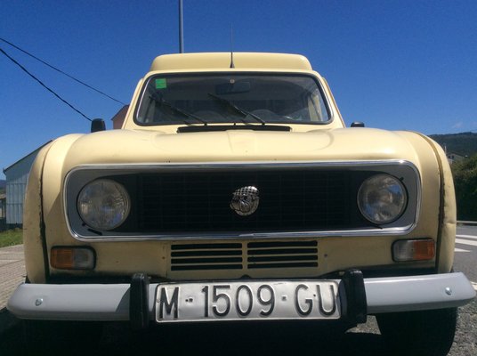

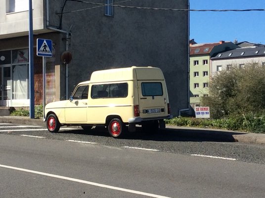

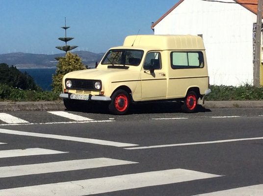

Decided to brighten up Mr. Magoo, never liked the black bumpers so there now grey,straightened front bumper mounts, fitted two good overriders that came in ‘magic bag’ with van, moved no plate onto bumper to make use of bonnet grill ( summers coming:clapping:), black on top of rear bumpers anti skid tape ( cheaper than vet dental bills when the dogs loose grip using bumper as slippy step to a wack on the chin ), previous owner also sent me some red anodized valve caps with temp gauge, so Mr Magoos got some ‘Madrid’ red running shoes now to match the caps;)
Ally doors now in a constructive pile, headscratching stage over, will be fitting it all in the not to distant future ( design and all fixings for bed complete, but its currently in the final finish/fit stage ), no photo, would just look like a pile of cut up doors atm.
Had it 6 months now, 4000km, these 4s really do get more appealing when owned, not less so.

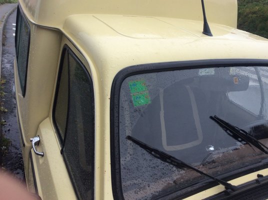

Well today, unlike the plane Lorraine Chase used for her Campari ads, the rain was here.., ITV day, checked van over, all seemed OK, drove a very wet 20 mins to test centre, and Fail!!, front UK offside indicator bulb blew on journey ( the law of sod returns ), so bulb changed and retest without the odometer reading changing and a pass with no advisories, every cloud has a silver.....6832B54E-9624-4665-9B08-857ED634DACB.jpeg04CB78A9-0964-4F14-A09B-F2AC394FBA85.jpeg717A3FC7-3C8D-4B83-AE76-7214052B3798.jpeg
lining, especially when you tweak the mixture screw to lean pre-test :laughing:

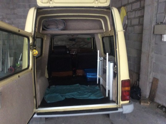

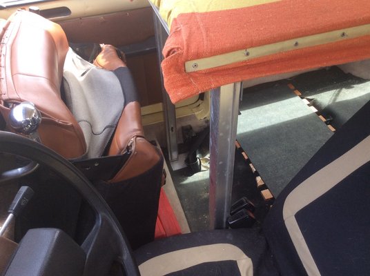

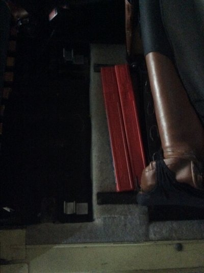

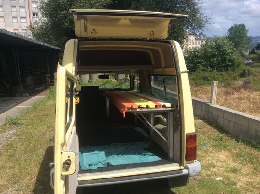

Started installing camping arrangement I’ve been pondering over the last few days, heres some photos to get an idea, I’ve made a false floor to cover the rear seat footspace, this is hinged using the original rear seat hinges ( teak too, whats a holiday home with no teak decking...), the photo of under front seat area is just to show position of brackets that front bed legs slot into, I’m not planning on furniture as such any more than is in photos, I will be using a various array of the stackable plastic boxs in pics, as seen the fold up table is for cooking from ( from in or out of van, through rear door, or even side window), the two brackets also support the main two stretcher bed supports aswell as front support legs. Apart from area covered by containers ( the now level area behind seats, hidden storage for tools etc under hinged floor) the floor space remains clear even with table and/or bed in place, the fittings etc for install coming in weight wise probably less or similar weight as the now removed rear seat.
Although not quite finished in photos, the support for bed will fold and roll up, all storing on the shelf that in pic has window blinds rolled up on. The overall size of bed is 60 cm X 190cm when up.

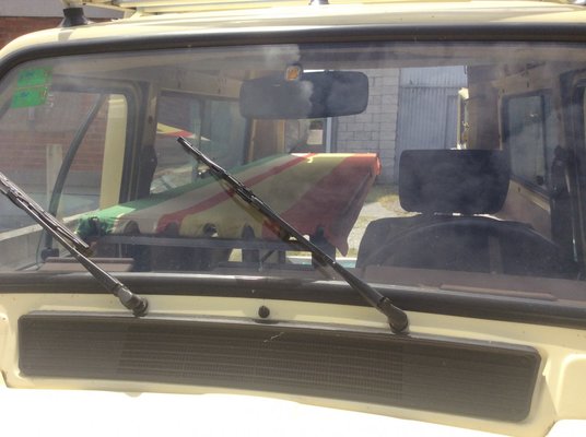

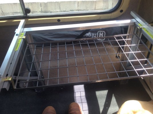

Been final fitting the sleeping arrangement, was initially planning to use the material from a tent I’ve got, but when I took it out of bag, put it up, its just too good to cut up..75D70676-92D6-422D-AF2D-C7340F305D0D.jpeg
So after much searching local shops for a plan b, plan x came into play, spotted hanging in the local Chinese cheap shop a hammock, that’s now not, but still serving its intended purpose.
Both sides are hinged in a ‘z’ arrangement, so you slot it into front fixings ( modified internal corner brakets from orginal doors), drop the hinged table to rest position, put bed lengths onto table and lift, lock a few fixings into place and its up.75D70676-92D6-422D-AF2D-C7340F305D0D.jpeg616AA5F2-E6EC-4B23-B8DA-CCFC2D047B8D.jpego
The crossbraces at each end are now gone, they were to tension material during fitment of fixings to the table/ bed support. The ‘table’ itself luckily worked out to be a nigh on perfect fit for the re-use of a top layer off of a folding camping kitchen set-up, so although in photos just appears to be grid I have the base and if necessary the splash/wind guard when using to cook, sitting on opposite wheel arch its just right..

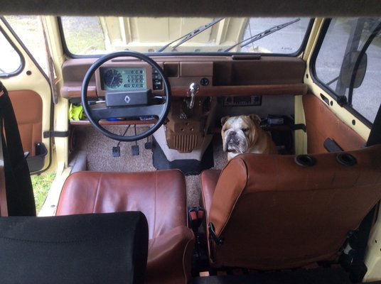

Started going through a few things that I wanted to sort, minors, the shelf in rear above where seat would be holds all the bed stuff/blinds etc., started to bow slightly, so fixed a few alloy supports to hold dead straight, also a few hidden fixings to stop any movement over rough surfaces, these also double to hold folded bed frame in a secure position when traveling ( pet hate is rattles, had to be done)

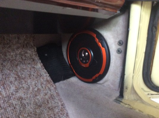

Made some enclosed speaker pods up to go in footwells, used MDF cut into a series of rings,screwed/glued fitted into panels made that use the door hinge bolts to fix, pleased with the sound.871E6DDF-1C99-416A-AF98-59D582BBB1F1.jpeg
There covered in same material as throughout van. There connected to a ‘retro’ look bluetooth radio, remote for when in back, b/t connected to iPad for tunes when ((for me) the radio stations talk in strange languages to my ears.
Then while ‘tinkering’ ( rainy days!!) though I would have a go at the instrument cluster, here's the result
Its the same grey as bumpers, but tinted outer lense same as rear windows, silvered part of facia around warning lights/fuel gauge etc., gives off a nice green glow at night. ( helps differentiate the headlights from dashlights when tooling along dark country lanes :whistle: )

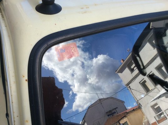

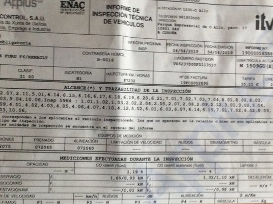

Had the mixture screw half a turn out this time for test CO came in a pass at1.65/0.98 kN.
Back on the road again!!:laughing:image.jpg
