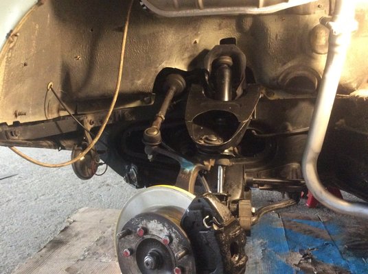

Since getting it home and putting it back into daily use from a period of little use ive had a few( not unexpected )small issues pop up, one, a noisy wheel bearing, Ive also started to overhaul the brakes ( it has had new cylinders on back,shoes,pads before it became mine),changed discs for new, then started having problems with calipers sticking, they have now been rebuilt, the cause was sediment actually in the calipers themslelves, probably a known problem on forum, think the brake fluid eats into the non machined part of the cast caliper casing behind. the piston whilst sitting not in use (mines got Bendix discs), so dissasembled ,cleaned and new seals.also fitted new flexes, originals may have passed last ITV but to my eyes wouldnt go through another.
Also the silencer developed a blow just where you cant really efficently weld a repair, by the exit downpipe so its had a new silencer, took whole system off and cleaned and painted it same time.
Whilst under the front wings gave it all a quick wipe over and couldnt belive how well it all came up, put some yellow hammerite on the edges of the new discs just to give me a visual check to see if the brakes bind, saves burning fingertips looking to see if paints discoloured, dont expect them to but hey-ho.

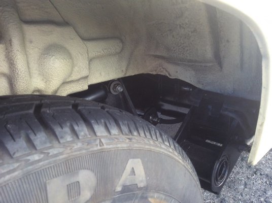

This weekend its the turn of the rear flexes.

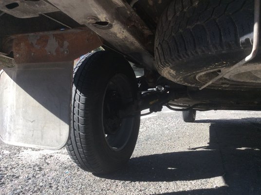

Rear brakes flexes done, would say ‘ fiddley’ is an apt description. Same time again cleaned arch areas to see what I’m dealing with, which is luckily no visable rust whatsoever and what appears to be factory paint.

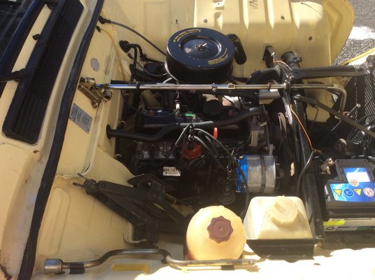

Gave engine bay quick once over,checking all the vacum hoses, fuel lines etc., got an ITV test coming up at 2.00pm today, so I see if I have any problems I’ve overlooked ( running as lean as I can get it atm;)).

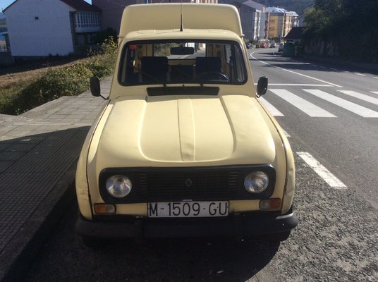

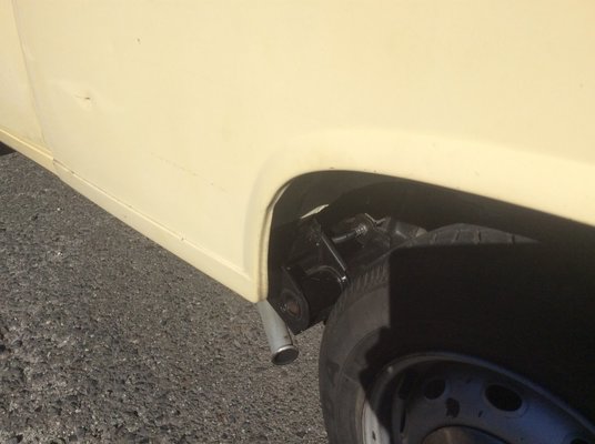

Heres some pics..969105DD-CCEB-442E-B3E3-6F7C46422749.jpeg83D0B2D7-FF30-4238-92A9-5624C05368BE.jpeg980C607C-6CE3-48A1-AABF-96F344F30726.jpeg1195DC10-A769-499F-A0AB-CD348A9D795A.jpegFAB0647E-E71B-42CC-9DFB-839650210E66.jpeg

Heres some pics..View attachment 21854View attachment 21855View attachment 21856View attachment 21857View attachment 21858

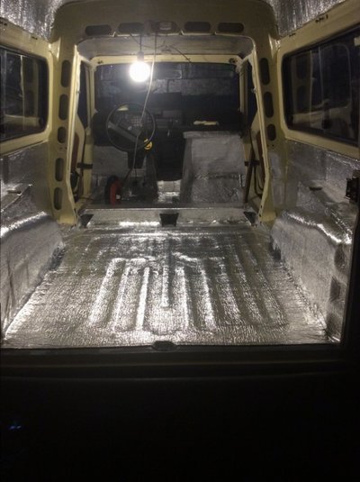

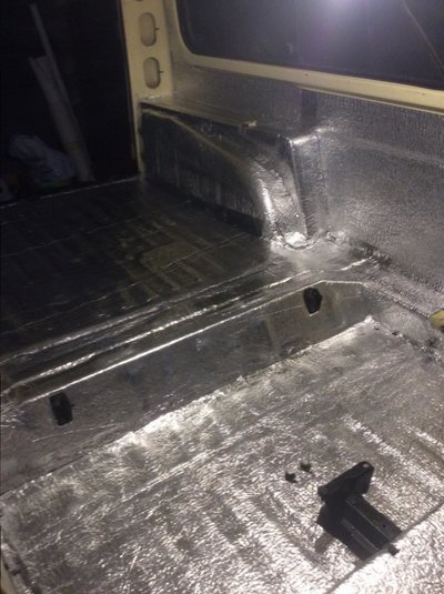

Also arrived, some LOW-E insulation, plan on lining the whole of the interior metal work ( floors,bulkhead, sides and roof and door interiors ) in this, after previously lining another vechicle with this hope it has the same effect with road/engine and rain(!) noise, also insulates, waterproof and mildew repellant. Will apply this with trim fix spray glue, going to be putting van lining carpet on top of this,same way sides/roof.
Tomorrow looks like a good day for some project progress:laughing:
Back rolling with a speedo working!, also pretty took back how sprightley a cap/rotor and points has made it, lot smoother too.

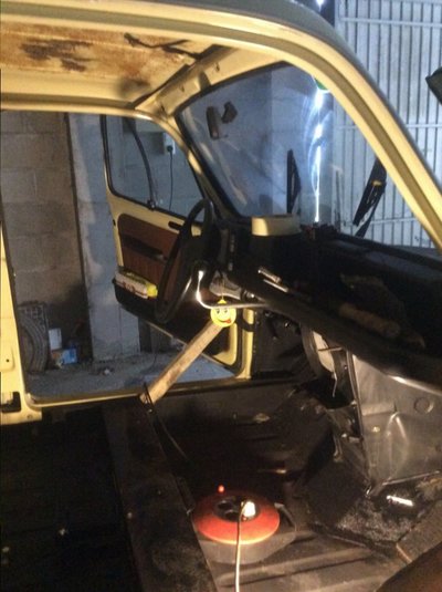

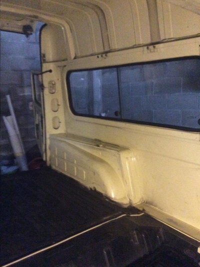

Stripped interior :-
And have got this far CA5DF3EE-244A-4375-BCC5-AEEBD99F0EC0.jpegD4B5BCB8-8358-4873-AA9E-C6958A756C0E.jpeg
Just been for a run with it as is plus drivers seat/seat belt and mats in, noise levels are noticabley lower, definitely stops the ‘ boonyness ‘ of the f6 on deacceleration in gears etc, pleased, as I havent reinstalled the rear roof strengthening bars etc. yet and the carpet trim should add to result, more progress due shortley, the carpet trim just arrived..

Further to above post, drove it to a vets appointment and back yesterday, about 80km in a torrential windy downpour, got to say I’m amazed at difference, prior to insulation I’d only driven it once in similar rain and couldnt believe how loud it was, almost to the stage your minds telling you to duck your head to keep dry, in yesterdays weather,van at same stage, the loudest noise was the rain on the windsceen/windows, at 80/90 kph I could talk to my dog without raising my voice ;), really has transformed van.

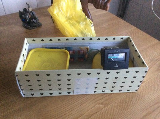

Few bulb sets, some valve caps and a temperature gauge, got to find a sender now, dont think if I searched a 1000 dashboards in dismantelers yards or trolled ebay etc for a while I could find a more suitable reason to stop the coin holder throwing coins at me, now to find a sender...

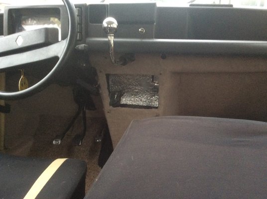

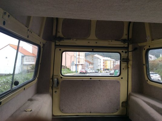

Quite simply the smallest piece insulation/soundproofing I’ve fitted and the result from this is nothing short of incredible, even without matrix back in and just tape over the hose holes the engine noise reduction inside the car amazing, to the extent if your interested in reducing engine noise in the car try this if you haven’t, truly gobsmacked at the difference9DF58344-040D-4AAF-9026-80FDE6798164.jpeg52F76624-BEEB-4561-80E5-6559BDC80C51.jpeg
Also fitted the lining carpet over the insulation on roof/ bulkhead and sides,

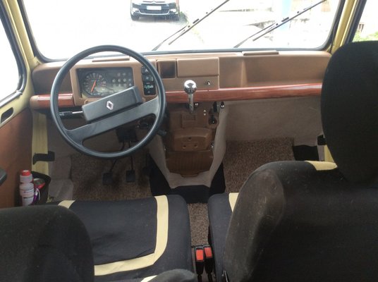

Van got a tidied dash for Xmas, found a space for temp. gauge where spare switches used to reside, paints a textured dark brown terracotta, real life looks more like colour of fan housing in photoC8F4B599-9A14-400C-92CD-1CCA02E63D06.jpeg
Possibly a bit ‘ Marmite’, but I like the results.
What model of temp guage is that, would like to install the same in mine, looks nice and neat
Not too sure on model, it was passed onto me by former owner, on casing there’s really only the polarity stamps by connectons on back with Veilga, made in Spain, will mail guy after holidays and ask where/what its from, to fit just had to file horizontal bar and enlarge to slot dial in,gauge sits just slightly to the left of centre of switch rectangle,but full display visable,had to file two slots in binacle cowl rectangle for dial face so cowl clicks flush.
Closer pic of dial few posts up. (Possibly same era-ish Seat/Fiat?)
Afraid I’ve not been able to determine the source of gauge @Richnd74, previous owner took it out of a Citroen AX owned by his son when sold with the intent on installing it in the F6, but looking through ‘google’ at AX dash pics just can’t see it in the pics, have searched 80s dashes and just cant see it in any, so its earlier or aftermarket..:dontknow:

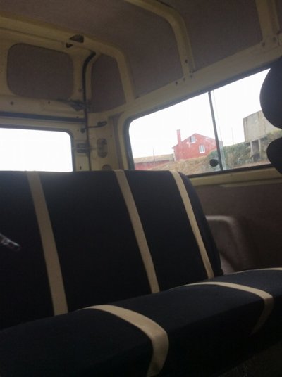

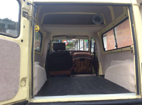

Little bit more finished in the rear interior, made a shelf for the front section of roof space, trimed the 4 corner verticals with carpet, fitted a one piece 3 mm rubber mat from rear door to seat crossmember ( lot easier to keep clean with the dogs in and out just sweeping from front to back, also made window blinds out of same insulation material used throughout,the roll on shelf affixes with velcro tabs ( black dots round windows) same time made a panel for rear door4850669B-0D9D-47CC-836B-CB33C9B02C3C.jpeg85613A4E-DD84-49D3-B758-AD9CC97FA7B2.jpeg for rear door
Next on the list is tinting of rear glass ( already have the tint film, a light green with UV protection), have to plan round this as van will be unusable for a few days..) and making/ designing a bed for rear, intention is to make a stretcher type bed from front to rear passenger side, initial thought was to have a clip in brace between front pilars and a right angle brace at rear, alloy poles (two pieces each length, sleeve join in middle) forming bed at window level, still the plan but instead of cross brace method Im going to make a foldable frame for front that uses the passenger seat rear mounts,with a small brace to front mount in middle for rigidity, the rear possibly original thoughts or just two fixngs for poles one on rear door,one pillar, made the rear door card out of 12mm ply in case I go this route, (want it window level so my Bulldogs cant climb up!).The idea is that it will all fold and store inside van without too much hassle, also the ITV here restricts what you can do, so I’m trying to design/build it so come ITV time its all out of sight, out of mind...

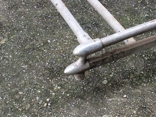

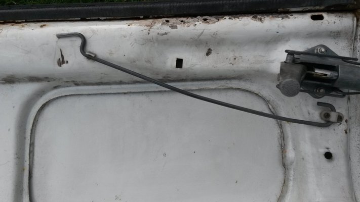

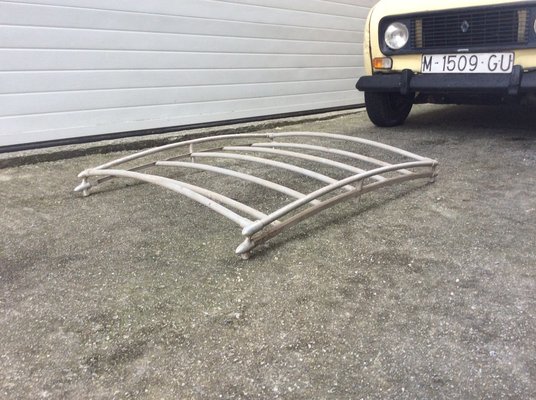

On a side note, I’m missing the giraffe roof braces, has anyone got a photo of one so I can make up some?
Hi Ian
The van looks great - I really like the slightly higher Spanish version with the side windows.
Thanks Andy,
Ah, so thats what they look like and how they fix/work!,

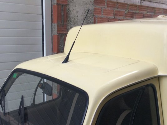

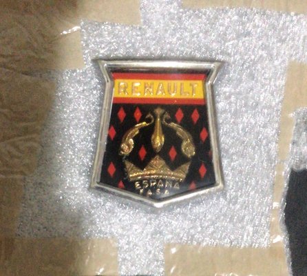

Been thrown a curveball on the to do list today , couldn’t refuse it as I really like the shape of the mouldings, saw this hanging in a neighbours garage said I liked mouldings and was given it, now feel liable to make it fit, but its not a straight forward thing, heres a pic of the new project within the project..
All is possible with adjustment !, it just needs shortening, narrowing to fit here....:whistle:C70907CA-208A-49E0-8840-BE2E7E2A2C0D.jpeg
Then an old luggage case fitted to hide a stubbier aerial in, after I can find/make a suitable form of clamping it to gutter , after I find some suitable rubber feet..., and then it will look a bit silly without a matching ally grill instead of the plastic one, and chrome side strips instead of black rubber, peep mirrors instead of black plastic..for a roofrack:doh:....
Very nice laxeian, it wouldn't look out of place on a 50s Chevy Nomad. You can't beat a bit of retro, so good luck hunting out the goodies you need to make your lovely F6 "old school".
