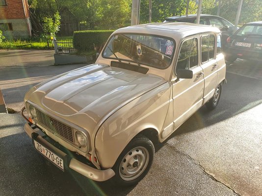

1990 Renault 4 GTL

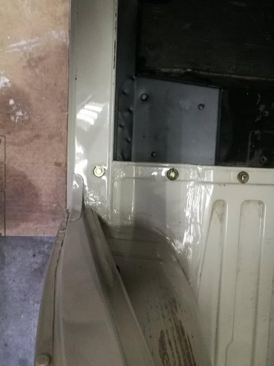

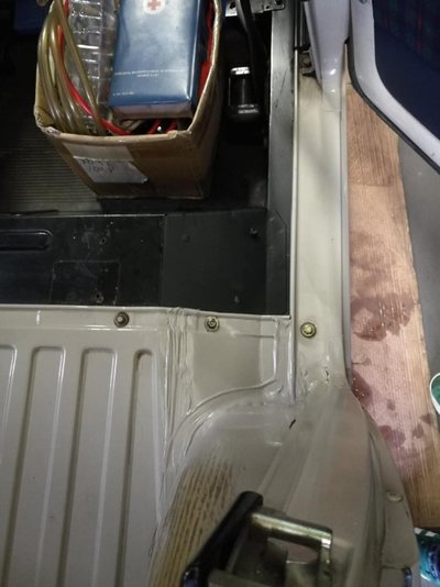

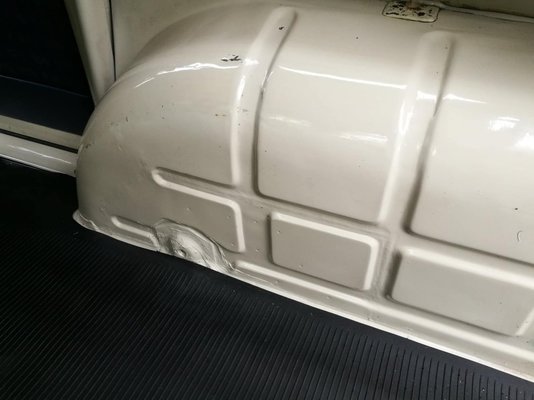

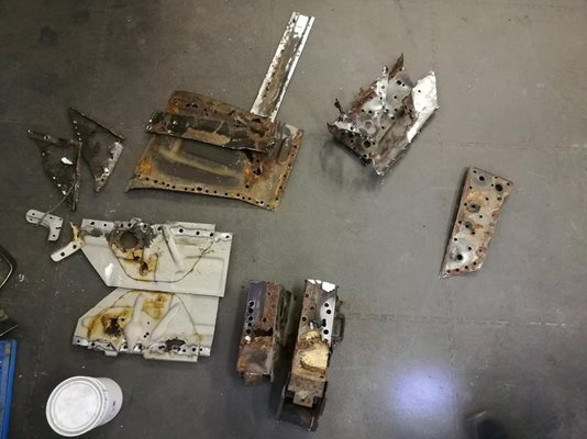

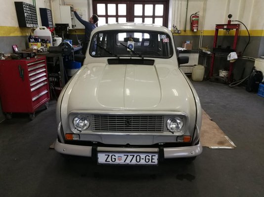

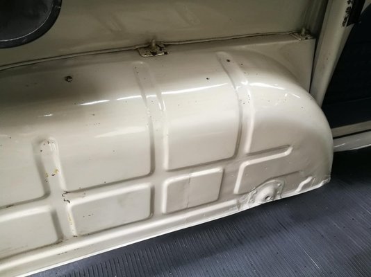

Yesterday was a long day. We went to Žiri at 7:30, and by 10 we were there. This is what I first saw

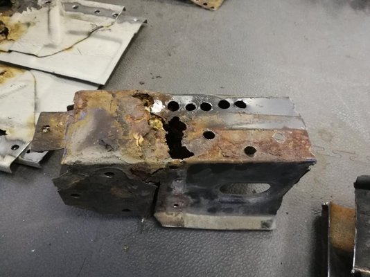

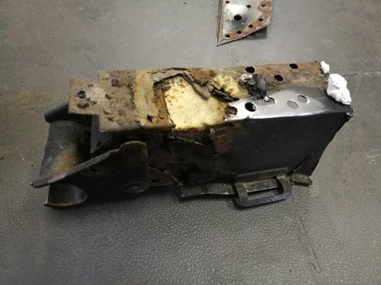

Rear pillars
Some of the parts that were cut out
I am very happy with this job, everything was like I wanted, everything was as agreed, Jan`s commitment to quality of work is on a very high level. He also set valves and change both inner cuffs.

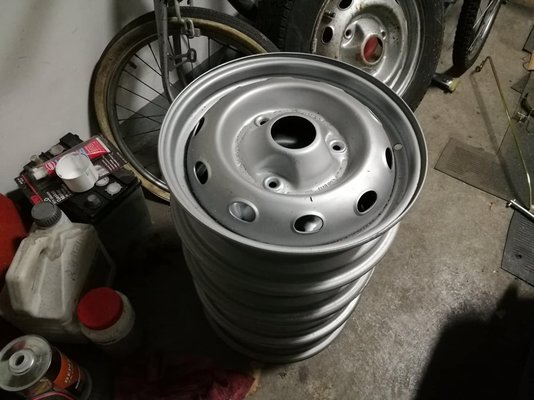

I also bought new wheels from him
An on the end, handing the keys :D
Now I have to change front left tie rod, do a wheel alignment, change wheels and tires polish it and then I`ll have a brand new R4 :D

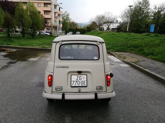

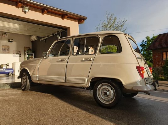

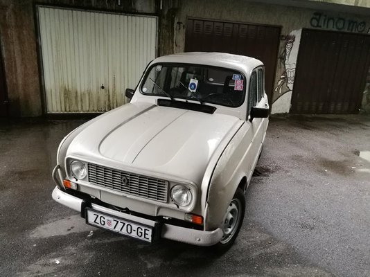

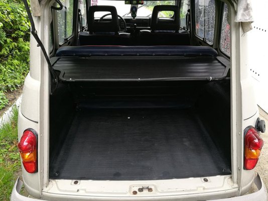

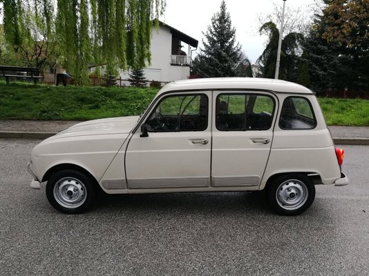

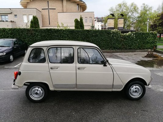

Yesterday I put back all the carpets and seats, cleaned everything and today I changed tie rod, put new wheels and summer tires and went to wheel alignment. It was heavy rain today in Zagreb, but I couldn`t help myself but make some photos :D

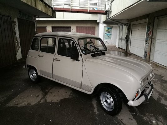

Yesterday car was polished, and here you can see how it`s shining now :D I`m very happy with the results :cool:

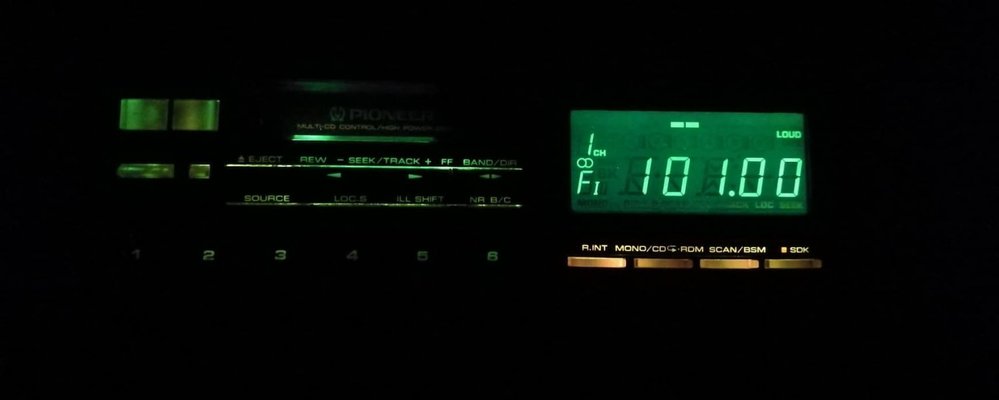

Today I finally put in my car something I wanted for a long time :D Until now, I had regular low-cost sharp stereo with broken cassette player. But today I got this :cool:
It`s majesty- the early 90s high end Pioneer KEH m7000 SDK
It has double illumination (green/orange), track seeking, antenna equalizer, station memory, CD changer plug (I have original Renault CD changer) and a lot of other functions .
A lot of wires, but I only needed +, earth, and speaker plugs.
Sound is beautiful, everything works like new. Now I only have to hide wires and connect illumination to ingnition lock in order to have illumination when radio is off, but car has contact.

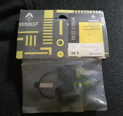

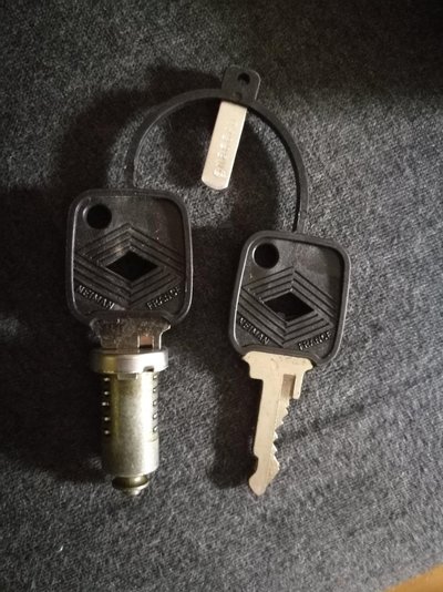

Yesterday came this
60976315_2311005029172263_7407608207981412352_n.jpg60602588_369960446977401_1971343809375633408_n.jpg
Now I have to redo all the locks to fit this new keys.

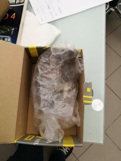

One more thing- I got brand new NOS license plate light, so I installed it- no photos though.
Now I`m waiting for reversing light lenses to come, not a brand new because I could not find them, but not broken like mine. I will clean and polish them and then it will be like brand new.

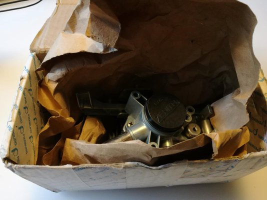

Yesterday came this
View attachment 23767View attachment 23766

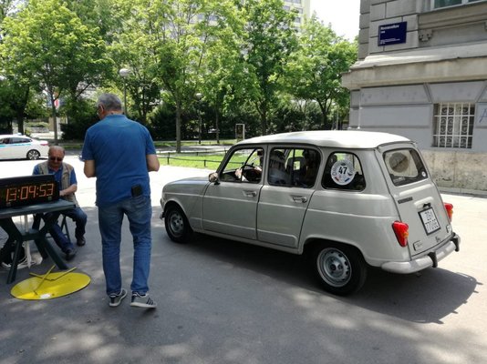

Last two weekends were quite busy :D Last weekend we were on Croatia Classic Marathon in organization of Oldtimer club "Stari kotači" (Old wheels). This marathon is part of Alpe Adria Classic Challenge which contains 6 oldtimer rallies in Italy, Austria, Slovenia and Croatia.
Weather was great, there were 79 cars and 3 motorcycles, route was really great with 130 kms of driving with checking points and accuracy tests on the route. And we had great result- 16th place of 82 :D Here are some photos

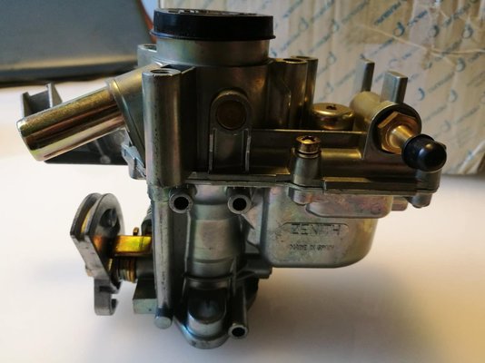

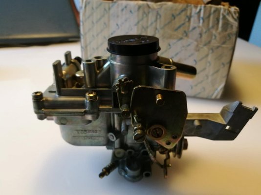

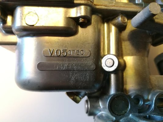

Always nice and good to see NOS parts. I expect you have a C1E engine in your GTL as the distributor is for a C1E engine.
Looking at the type number of the carburetor, it looks that one is for a TL not a GTL. There are many differences in the various Zenith 28IF carburetors mainly differences in the internal non adjustable jets
Yes, I have C1E engine- 688 D7/12. I`m not sure this carb is for TL since it`s from 1991. On my other carb I have the same type number, but date is 03/95.
On my GTL's 688 D7/12 the Zenith 28if V05078B is fitted and it easily reaches 140km/h.
Maybe this pdf can help and on this site there's info on which engine has a specific Zenith 28if.
