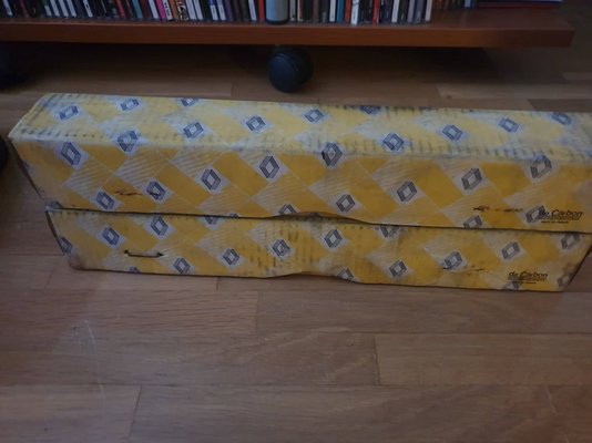

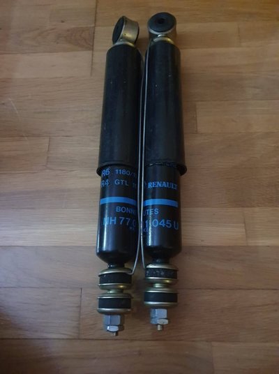

Today I changed rear shocks. Since I bought the car, I had trouble with throbbing at the rear end and when passing curves where the road isn`t good, the car jumped a bit. Anyway, I opened my NOS Renault parts secret cave
and pulled out some new shiny De Carbons that I purchase this summer on french ebay.

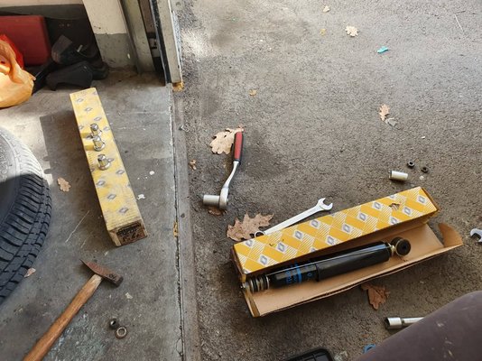

Prepared tool and new shocks

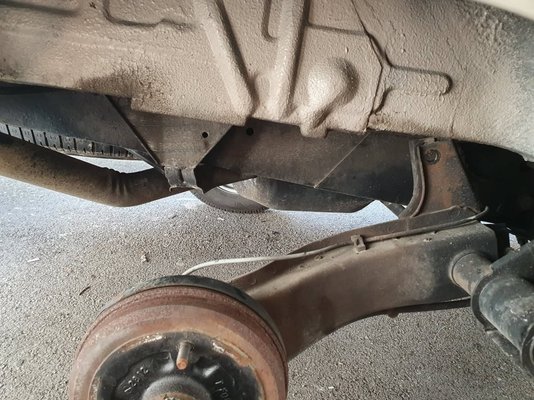

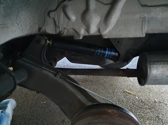

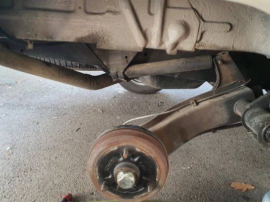

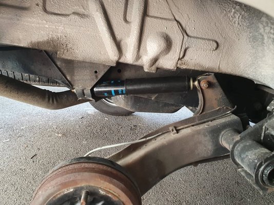

First I had to remove the old ones, so I lift the car on the jack and secure it. Then I removed the wheel and the old, tired grandpa showed up
Then I unscrew the nut on the upper part and then two nuts (thinner, securing the wider) on the lower part and released the pin from the top part. Then I lifted rear suspension with another jack to release the shock.
May be tricky to insert a new shock but if you lift the suspension just a little bit more, you will be able to put it inside because shocks on R4 works o different principle than on other cars- when the suspension goes up, the shock is stretching.
So I did exactly the same on the left side, but with a little more effort because one bolt was very very stubborn
and the exhaust pipe is getting in the way.
