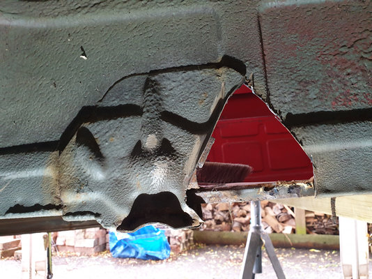

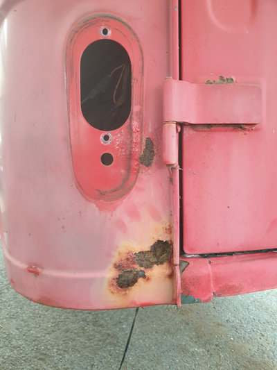

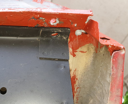

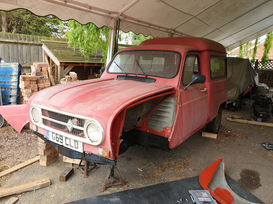

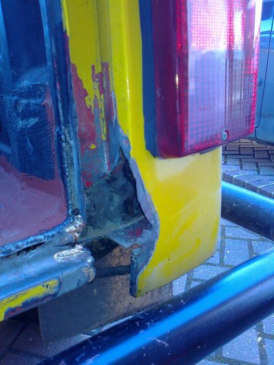

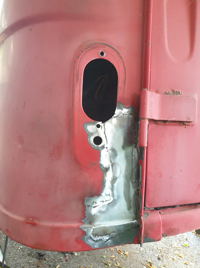

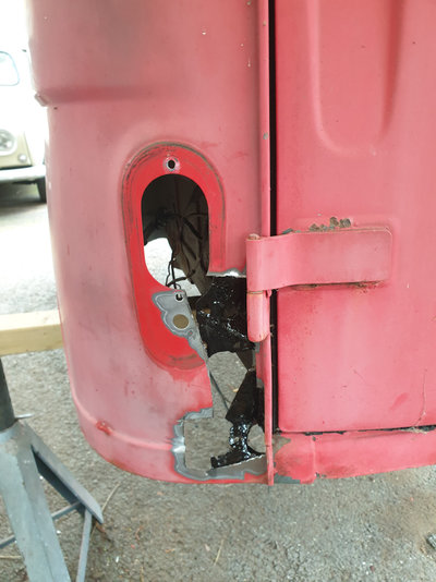

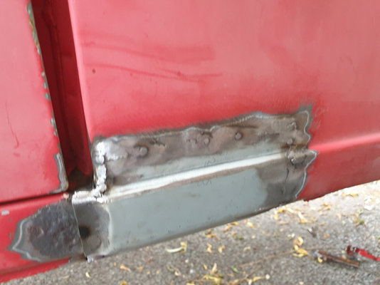

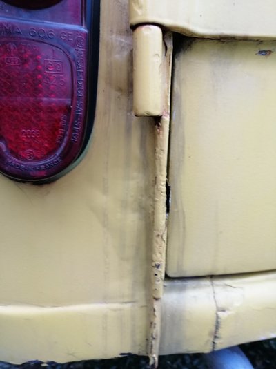

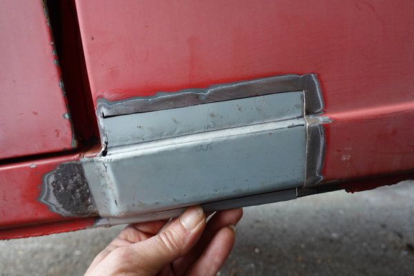

I have the same rotten corner on mine!Claude is taking up too much space in bits so I'm planning to weld up the body before putting the new chassis underneath. There are a lot of bits of rust that look really small and end up being big when the rust has been cut out. All of them are fiddly too so I'll not get rid of all the rust.
For everything the rust is where the spray-on sealant had gaps. I've ordered a lot of new sealant so will hopefully get everything sealed underneath while it is accessible.

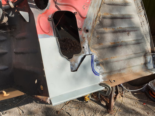

That corner seems especially a pain. Normally you would cut out to metal where there is no sign of rust, but there are double skinned panels running right the way up and just a little rust between them all the way. I guess the repair will be better than it was but I can see this as a place where rust will come back.I have the same rotten corner on mine!
Is the price reasonable?Mlinar brothers have that panel if you want to change it whole.
I do not remember.Is the price reasonable?
I've seen replacement panels for this part, don't remember where, but they were really expensive!

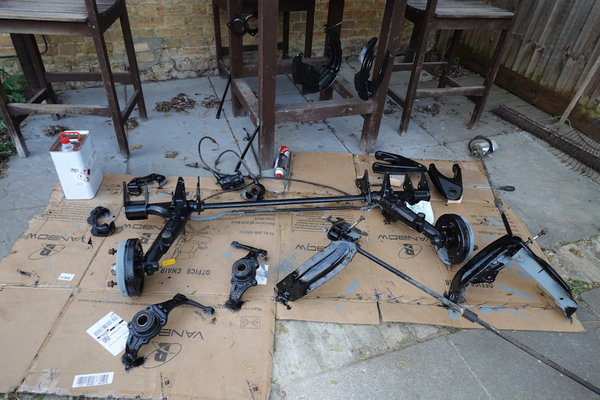

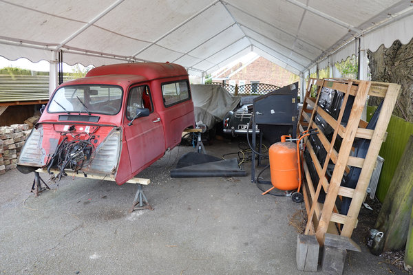

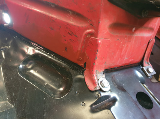

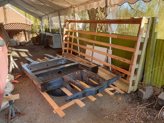

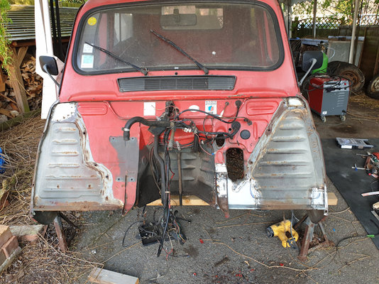

Not fun when buying somting to save time and effort. Seems like the manufacturing jig wasn't correct. Hope you can sort it somehow and still being happy.I've started fitting the new chassis. Ran into a couple of problems. One of the rear suspension bolts didn't fit through the hole. A hand file worked for making the hole bigger.

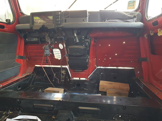

The front of the body doesn't fit at all well. With the bottom of the A-pillars sitting on the chassis sill sections the bulkhead is about 10mm too high. I can get the heater console bolts to line up with some assistance but the bulkhead is very stiff in the middle so I can't close the gap. I think I'll end up using spacers and a lot of sealant.

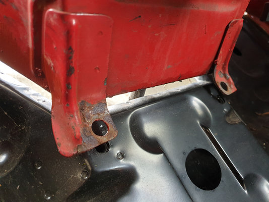

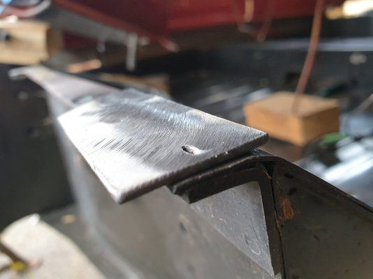

There is trouble on the outer part of the bulkhead too. The return at the top with the bolt holes for the body is at least 10mm shorter than the original. They have provided an M8 hole but the flange is so short there is no room for a nut. I can line the inner hole up but the outer hole has no chance of lining up. I think I'll need to extend the flange.
All of the other body mounting holes line up well - it's only the front that is a pain. With the front bolted as tight as it will go the inner and outer wings fit OK so it shouldn't be noticeable from outside.
