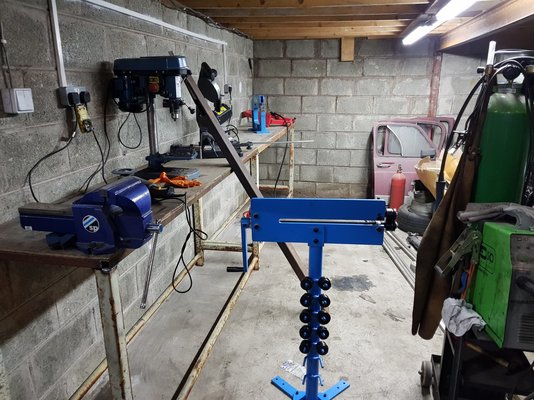

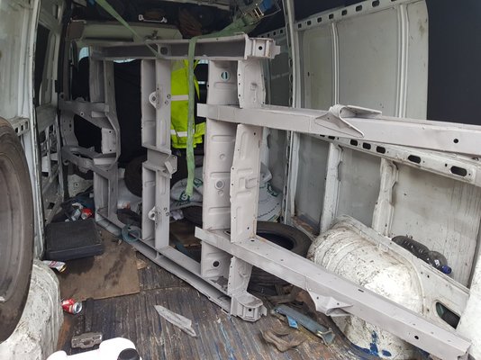

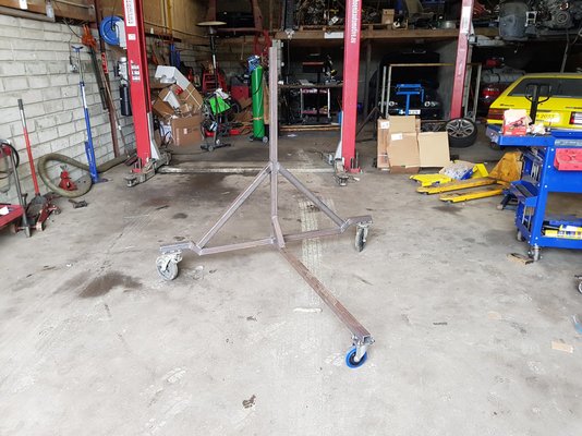

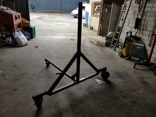

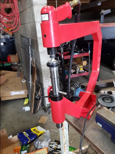

Not only for my renault , but I'mworking on my metal fabrication station :) I'm also building rotisserie ,

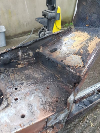

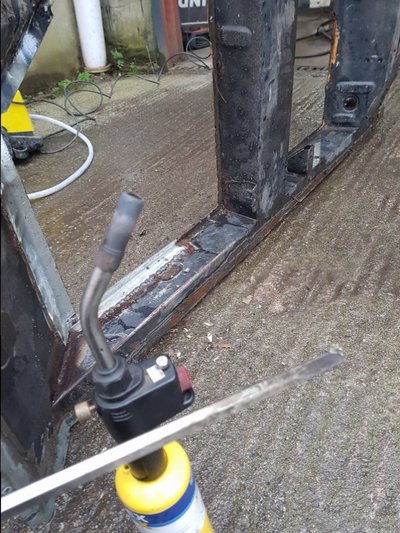

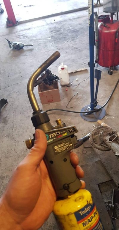

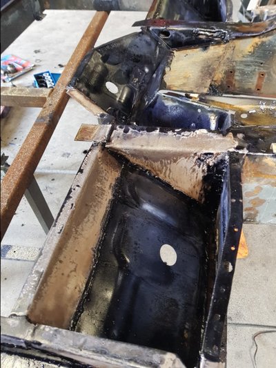

I also removed all the seam sealer from my chassis, blow torch , screwdriver and wirebrush did the job.

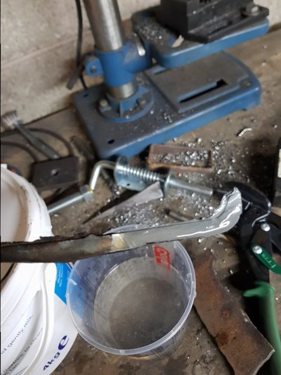

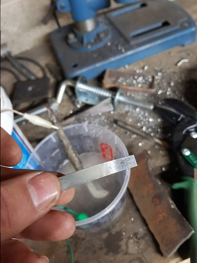

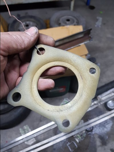

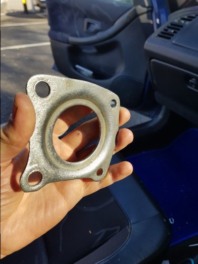

Successful experiment with zink plating ,
Now i need to up scale it , and i can plate all the bolts plates hubs and whatever i will lay my hands on :)
Bit better, now durability tests :)
Good work on the electrolytic galvanising but uhm durability test?
Leaving it in the rain for 5 years :D or spraying brine water for some days on it.
Will you do a final coat? e.g. passivate or chromate the galvanised part?
Regards, Joop
Regards, Joop
I have some sort of yellow chromate
I dipped it in it , but not for long and the chromate should be at about 30degree
So most of it came out with wire brush , there is very little of the yellow left in it and i need to buy some sortvof acid to dip it before galvanising it will improve coating .

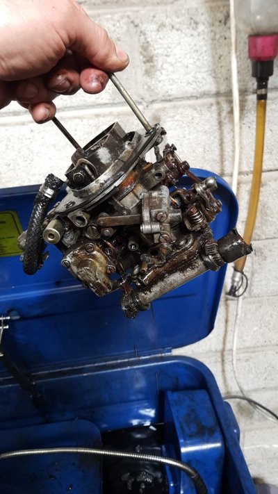

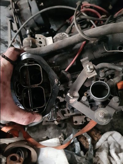

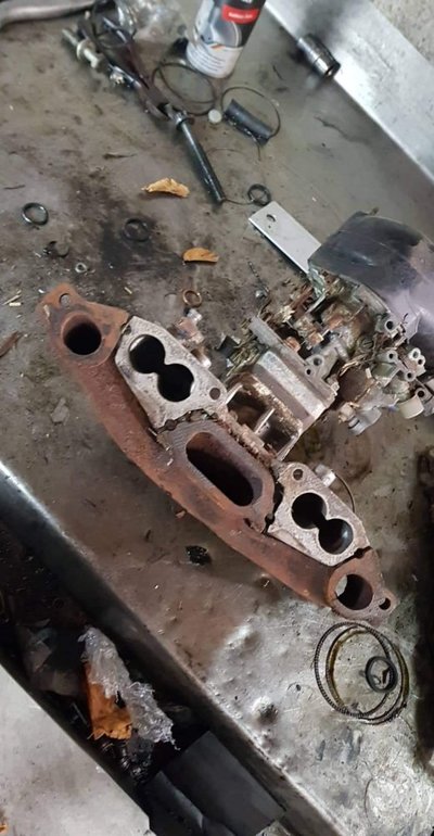

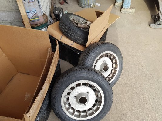

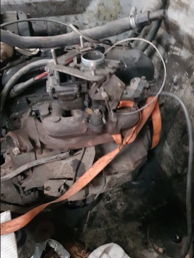

Loads of goodies arrived this week , my alloys , intake manifold from renault 5 ,

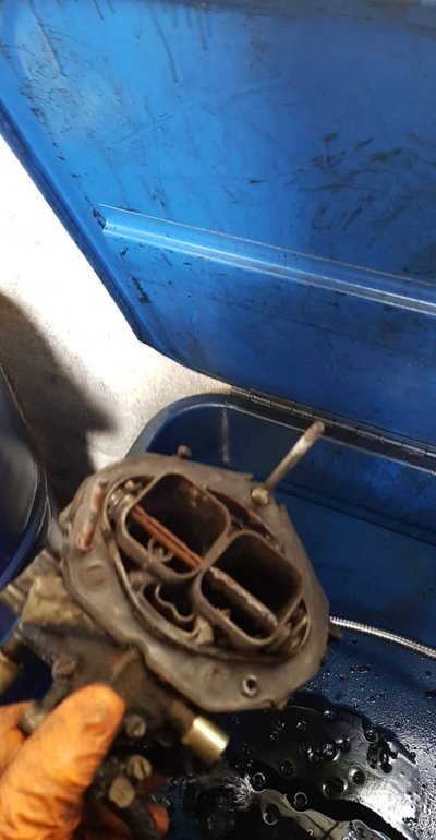

With twin barrel weber carb , at first it was seized , but after night in diesel all the parts are moving , so i will attempt to recondition it.

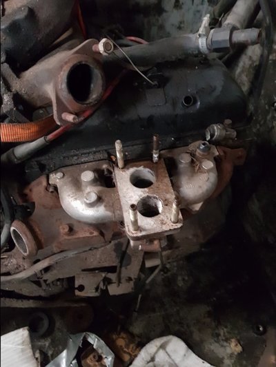

Lack of time dealys my restoration progress, but i finally found the time to test fit my new manifold, i also ordered repair kit for my weber.

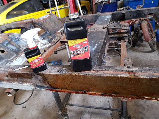

I got the point conversion kit , i also wet blastet part of the chassis ant treated it with fertan , does the nice job , but messy netx time i will bring it to the specialist :)

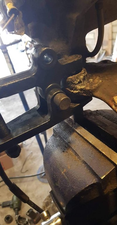

I decided to remove the torsion bars from rear axle , i used heavy duty ball joint tool an a bit of heat, first one is free now :)

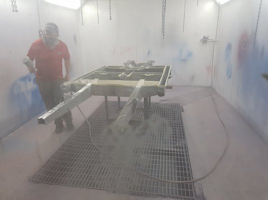

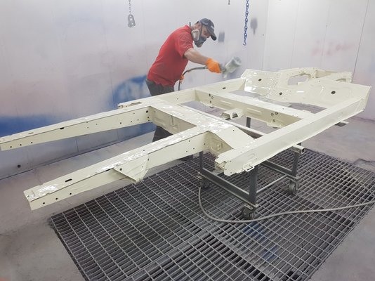

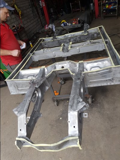

Finally i got my chassis blasted , the wet blasting does work , but it's too slow and messy, i will still be using it to blast elements wich won't fit in my blasting cabinet.

Quick question - I assume the engine is a 1100cc? And that's a dual barrel 32 weber right?
I'm wondering what power gains you can get from that. Had a deal to have one refactored for about 100€ but I passed at the time but now I regret doing that :/
