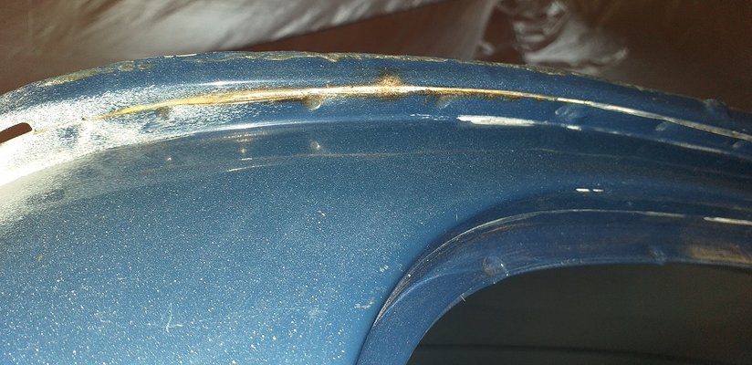

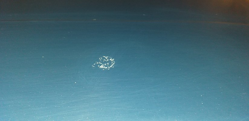

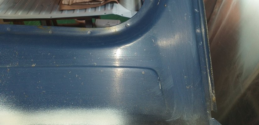

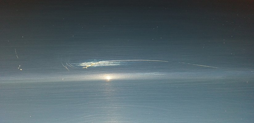

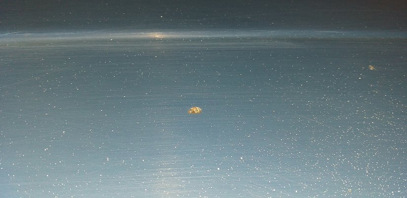

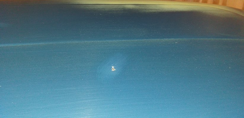

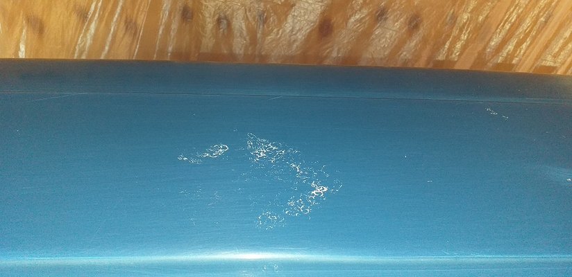

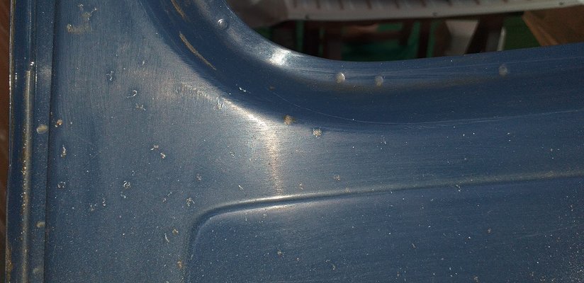

Further with preparation of the cars body in the "cleanroom".
It's amazing to see how many small scratches, paint wrinkles and pits caused by stone chips you encounter when you put your nose into it with preparatory sanding.
Still no rush with the paintjob as the weather still has to improve and time is not on our side.

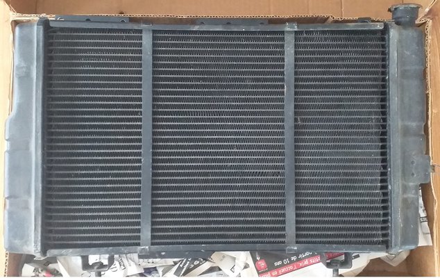

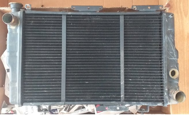

Meanwhile I was looking for more original and better parts for the rebuild, I'm in contact with a forum member about a part and just a package arrived with a very nice copper radiator which I bought from Leboncoin.
In my first GTL I also had a copper one when the original weak and cheaply produced factory one (aluminum with plastic pans) failed.

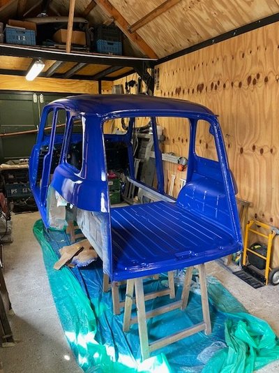

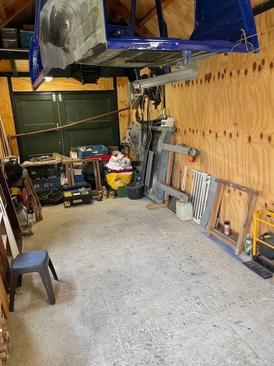

But since a month I picked it up and started with spraypainting. Two base coats and 2 clear coats were applied.
The improvised spraybooth has been torn down and here she is in the very nice purple/blue colour "Renault 417 Bleu Versailles".

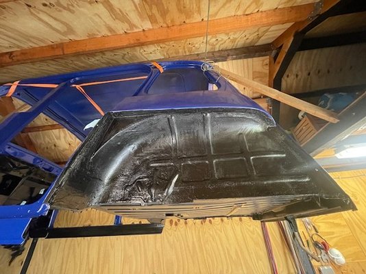

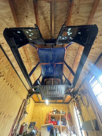

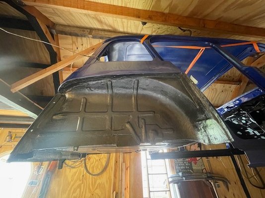

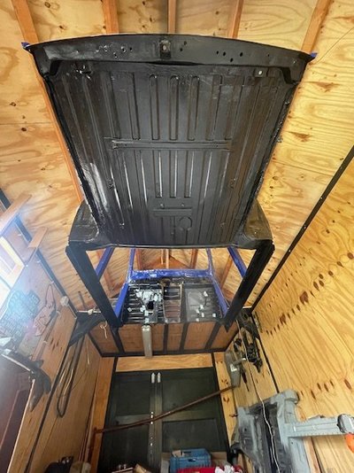

The body again hoisted back into the ridge and started to paint the underside as well as the wheel arches.

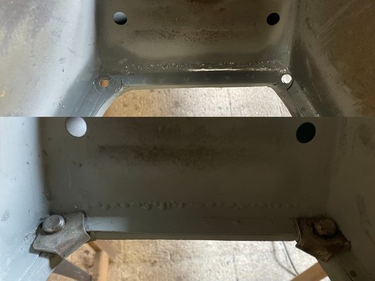

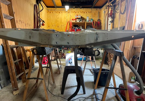

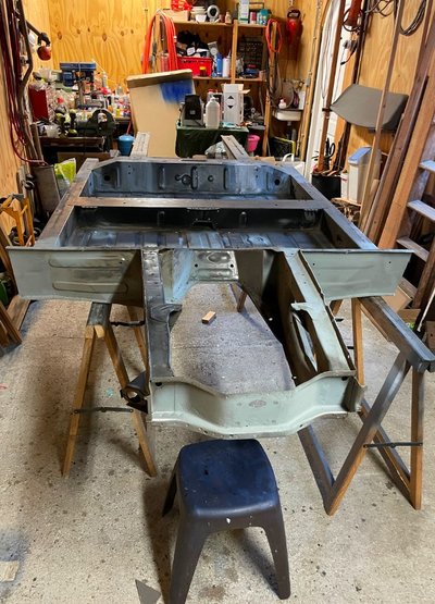

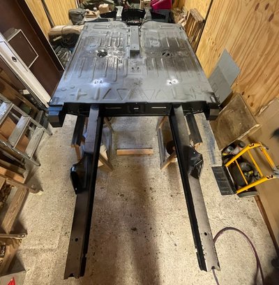

The chassis lifted onto the trestles en first some small welding on the floor lips from both the rear beams.

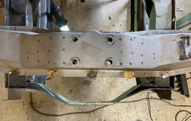

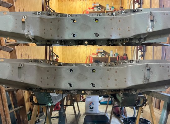

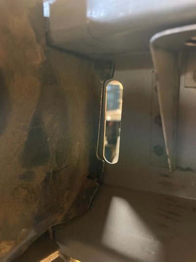

Next is the front beam which was collecting dust after all those years.

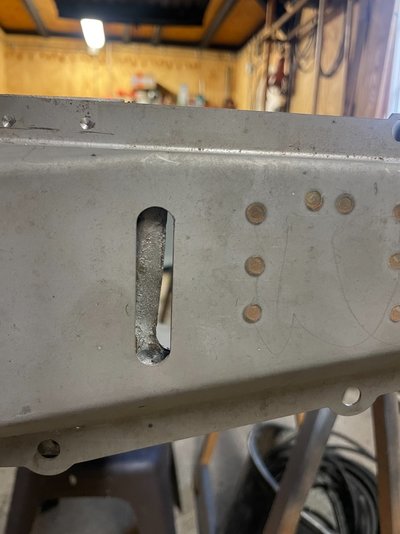

As expected with an aftermarket product it doesn't line up at several points.
On the right it lines up beautiful with the bumper support.
But on the left... well you can see.

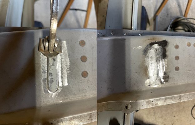

Time to cut an oval piece of steel and weld it in and make a new slot at a later moment.
Holes at the bottom didn't line up as well so again I'll close it and drill them out at a later moment.
View attachment 35395 View attachment 35408

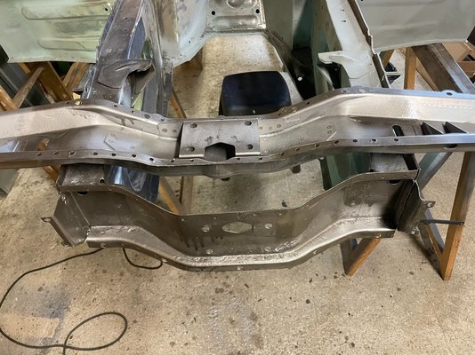

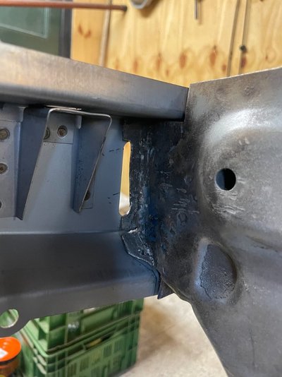

View attachment 35400 View attachment 35401
View attachment 35407 View attachment 35406

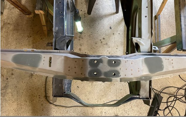

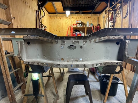

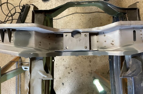

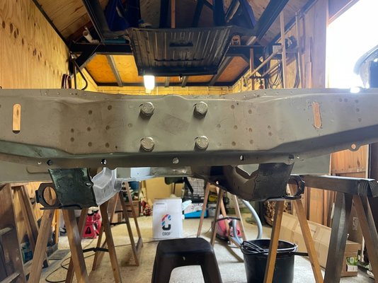

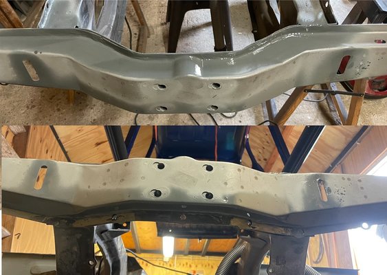

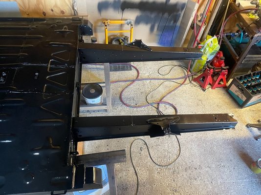

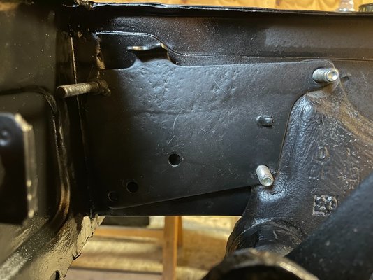

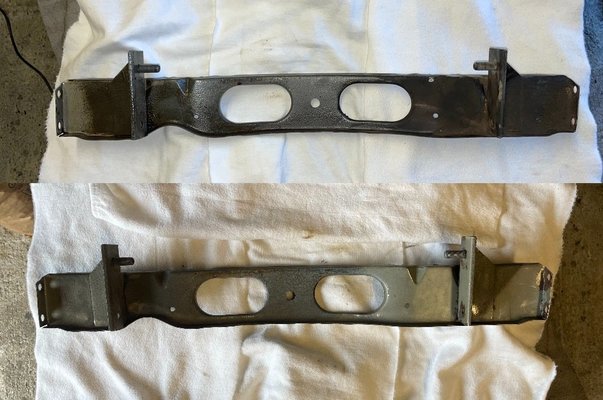

Continuing the work on the front beam.
Lining up the beam, maintain the symmetry with the chassis and drilling the holes at the bottom.

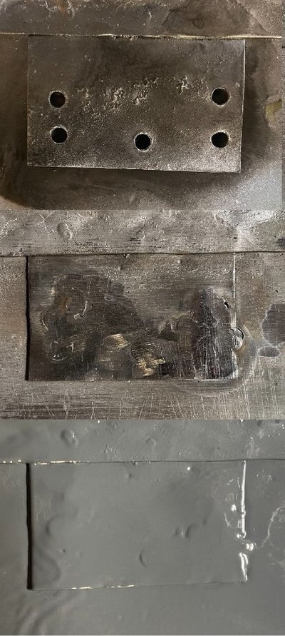

And next all the well known preparation steps for plug welding as there are drilling the holes, sanding away the zinc and applying the weld thru primer.
Plug welding starts, then grinding, the zinc protection and another job's done.

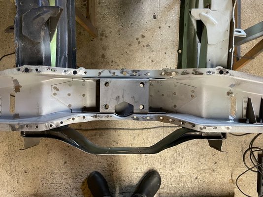

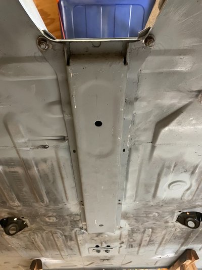

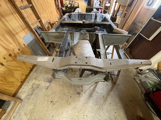

Next the floor protection beam is put back.
So I start to drill the holes and bolted it in and after that the plug welds.

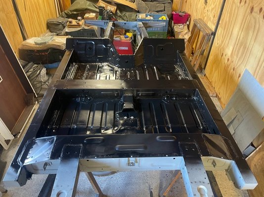

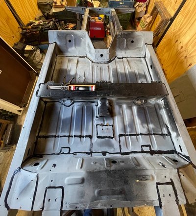

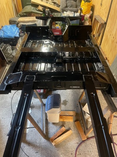

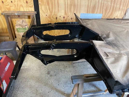

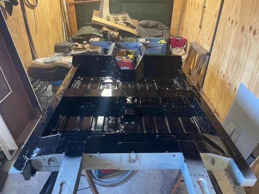

All welds of the chassis were sealed, primer (Brantho Nitrofest) was applied and finished with 2 coats of high-gloss paint (Brantho S-Glasur).
The inner part of the chassis was masked off and the outer parts of the chassis were painted with 3 layers of Brantho Korrux.

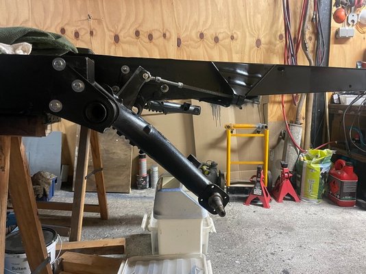

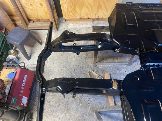

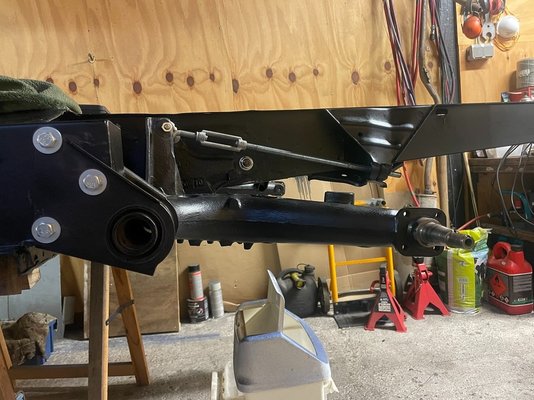

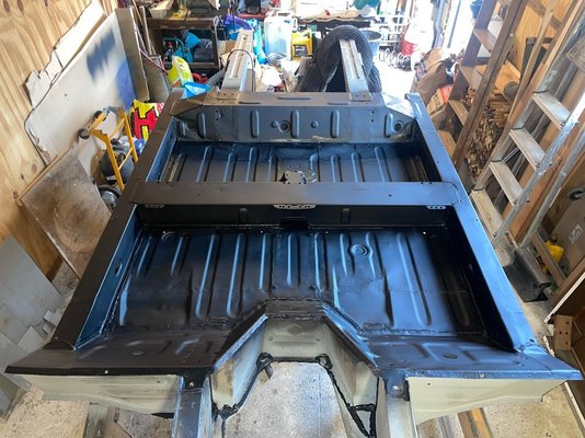

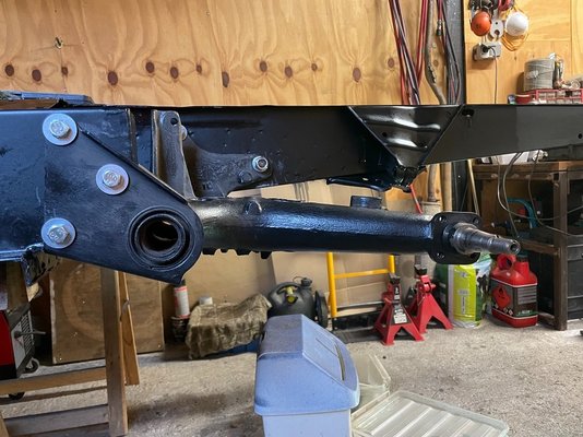

Flipped the chassis and again welds were sealed and 3 layers Brantho Korrux were applied.

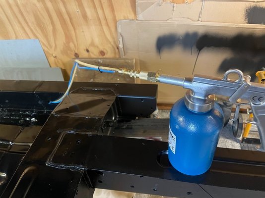

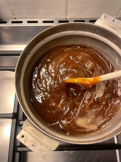

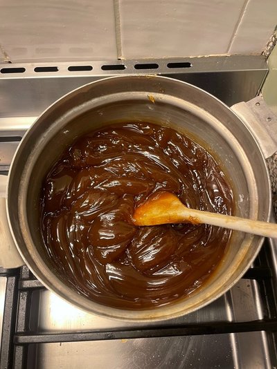

Then the work of preserving the cavities begins. Years ago I wrote that I would use Mike Sanders grease, but I opted for the Fluid Film brand instead.
Liquid A is a liquid version that seeps into every crevice, while Liquid AR is thick and viscous.
I first applied Liquid A while the chassis was still upside down, and after a day, I turned the chassis over so the liquid got everywhere...I hope.
Then I apply Liquid AR, but because it is thick we will heat it up first (what's cooking) and spray it in the cavities.

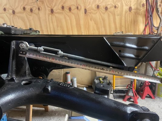

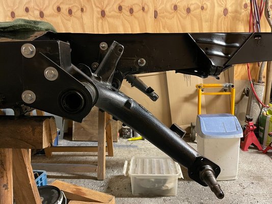

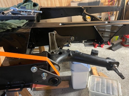

The chassis is now ready and we can start with reassembly.
Cheers
