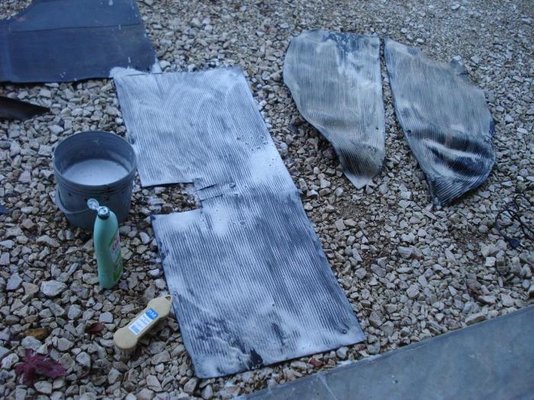

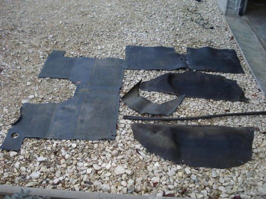

So... while waiting for the first try on the road, I continue to show you the following of the reassembly job; I started to clean all the carpets of the car, which are really dirty:

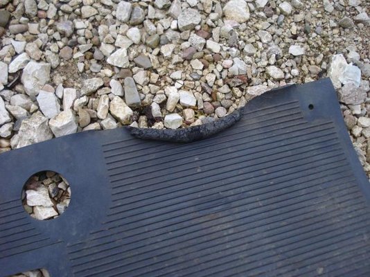

The car will not be perfect ;) I decided to keep this one, memory of the fire in the wiring loom in 1998:
I started the cleaning with hot water and a product called "Cif" which have the peculiarity to scratch the dirt:

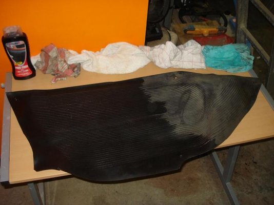

Then always the same product "Holts", notice the difference before/after :cool:

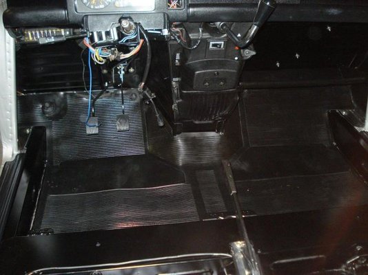

The front carpet is now in position, it looks like a new one :D

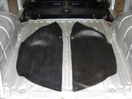

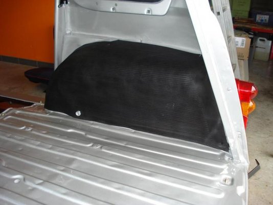

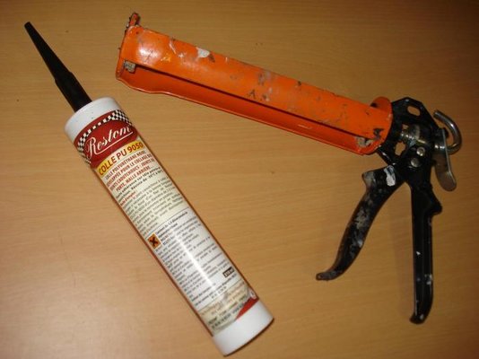

I bought a special glu to fix the wheelhouse carpets, it allows the repositioning of the part contrary to the neoprene glue:

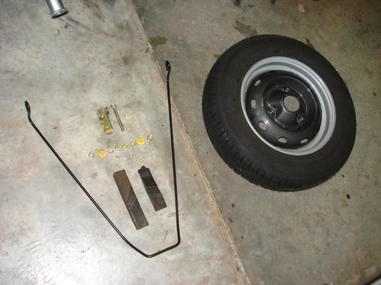

I also refit the spare wheels with naturally all the harware in new :rolleyes:

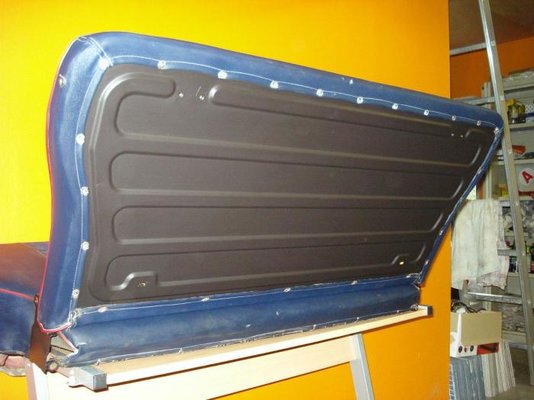

These days I reinstalled the back seat, after sanding it, I painted the back of the seat with two coats of black paint:

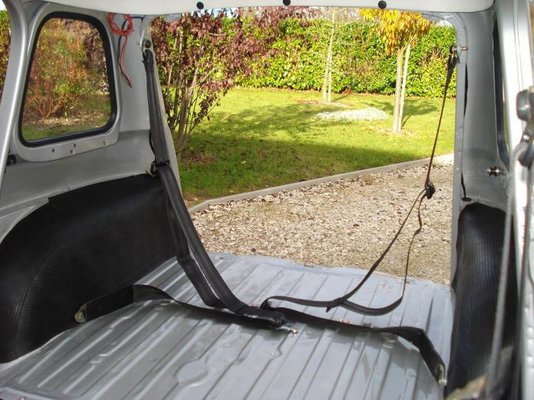

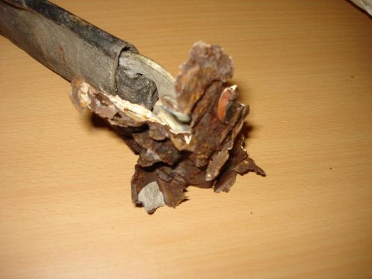

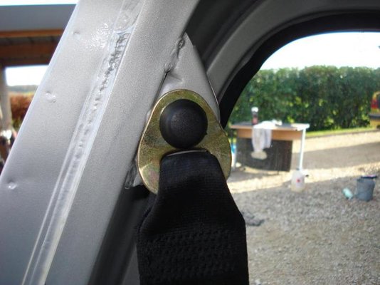

Before installing the seat, I went to a scrapyard to find rear seatbelts, mine were sold or lost for a very long time... I found a GTL with its seatbelts, but looking at the condition of the body I had to use a hammer and a chisel to take one of these belts :eek:

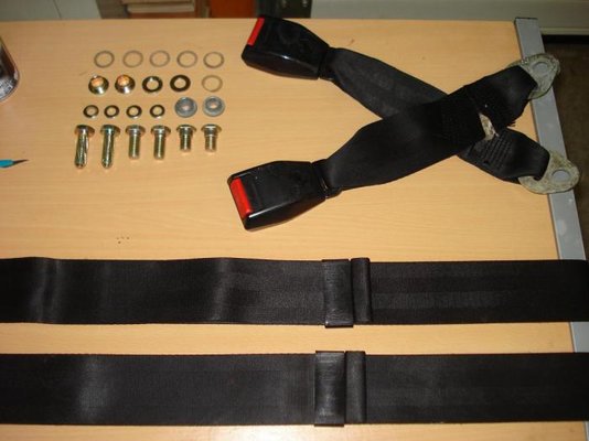

After cutting the rotten part with my grinder I carefully washed all the different parts and prepared them to fit on my car:

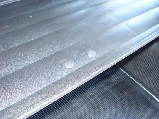

As I still like the small details, I put plastic covers on the head bolts at the rear of the body :cool:

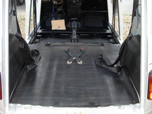

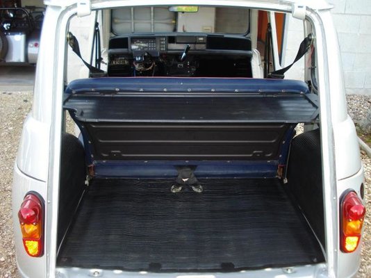

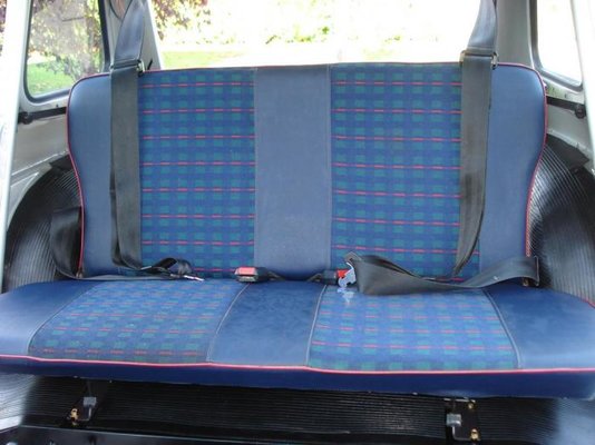

Then, the rear carpet and the back seat have been installed in the car:

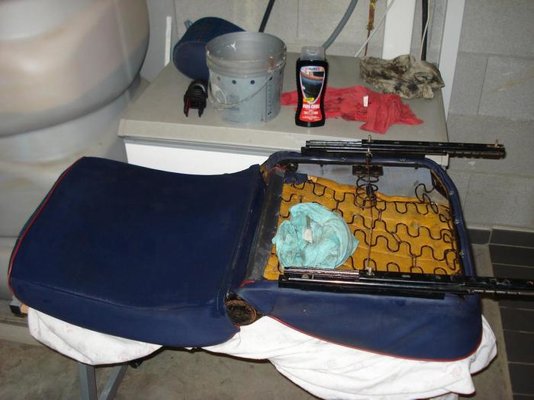

I also started the washing of the front seats, which are even dirtier than the rear one...

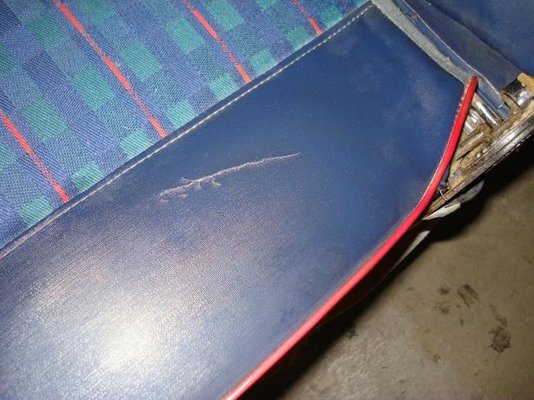

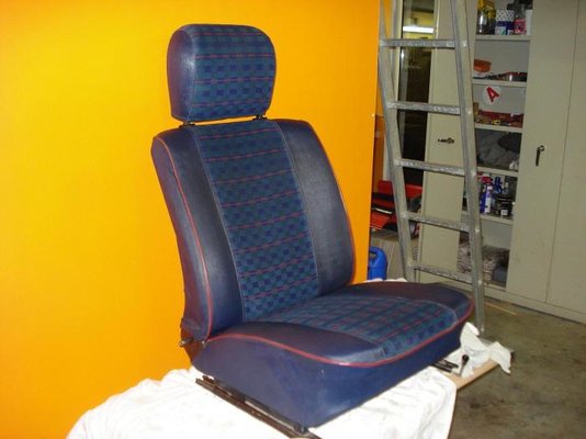

Finally I finished the washing of the front seat, even one of them has a little damaged on the basis, they appear in good condition :cool:

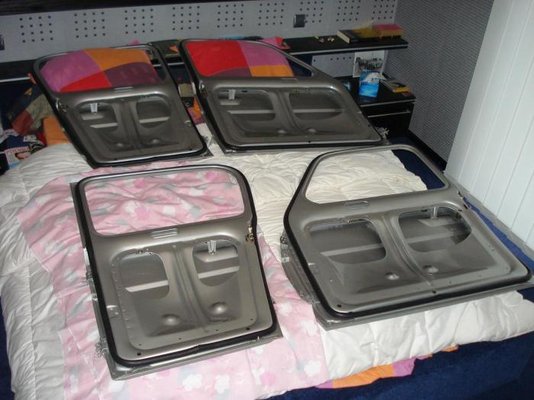

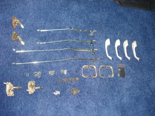

Then I sorted out all the hardware necessary to fit the doors on the car:
After having stuck the weatherstrips the doors are ready to be fitted, please notice that I made this job on the bed, the only place I was sure the paint would be not crossed off :rolleyes:

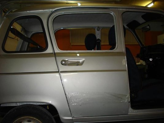

The first one to be fixed on the car was the right rear one, the regulation of the lock took me very long time before being satisfied of it, and of the distance with the body:

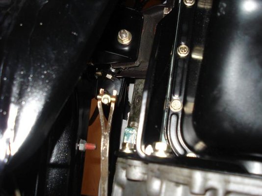

During this, I fitted the clutch cable and regulate it:

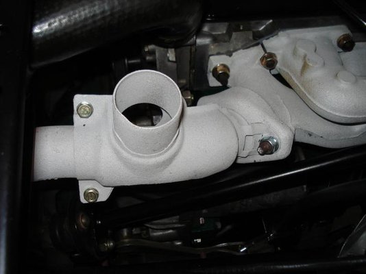

And this part on the manifold:

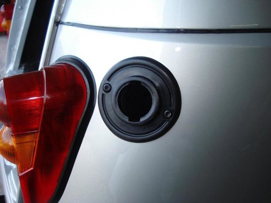

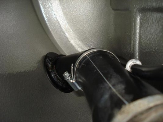

The fuel tank filler pipe was also very hard to adjust, but at the end it's also beautiful outside as inside :D
