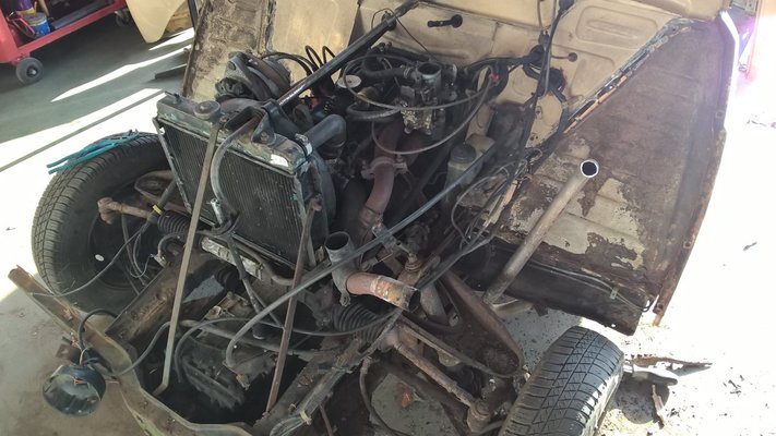

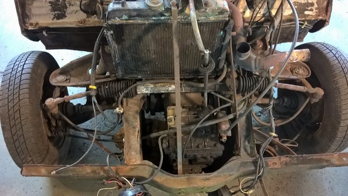

Short walkaround on our workshop:

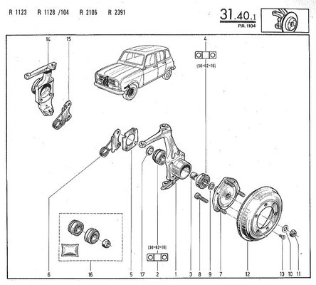

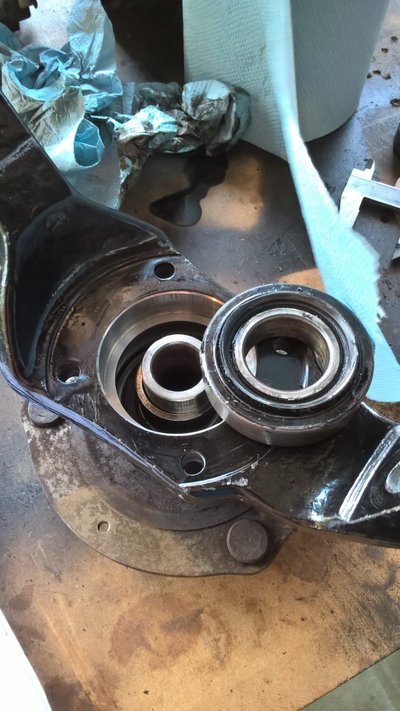

I ordered new bearings as the ones shown below are old and noisy. In what order do I need to put the parts together?
- 2 into 1
- 4 into 1
- 7 into 4

Great to see your amazing workshop. All being together like that means you can help each other out and it must be great for motivation too

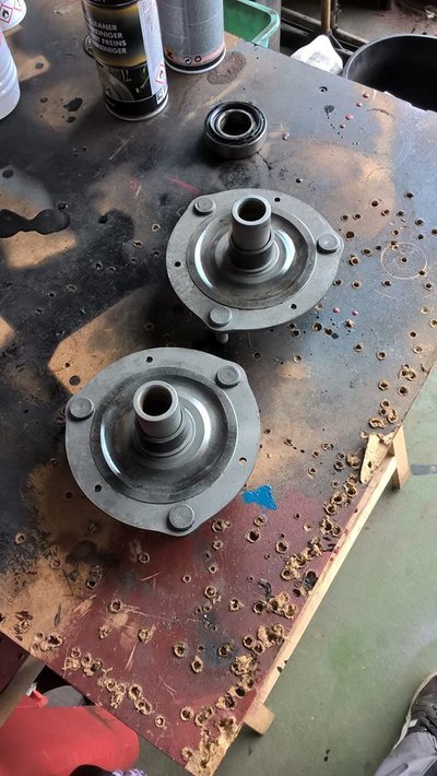

New front wheel bearings removed and pressed:

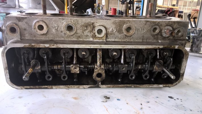

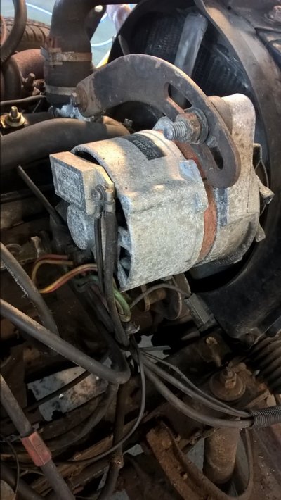

WP_20150925_17_44_52_Pro.jpg WP_20150925_17_45_01_Pro.jpg WP_20150926_13_52_53_Pro.jpg WP_20150926_13_52_59_Pro.jpg WP_20150926_13_53_05_Pro.jpg WP_20150926_13_53_10_Pro.jpg WP_20150926_13_53_20_Pro.jpg WP_20150926_13_53_29_Pro.jpg WP_20150926_13_53_35_Pro.jpg WP_20150926_13_53_51_Pro.jpg Hi Paul, thanks for your kind offer! I will first look in the Netherlands for the part. Must be someone who can help me out:waving:

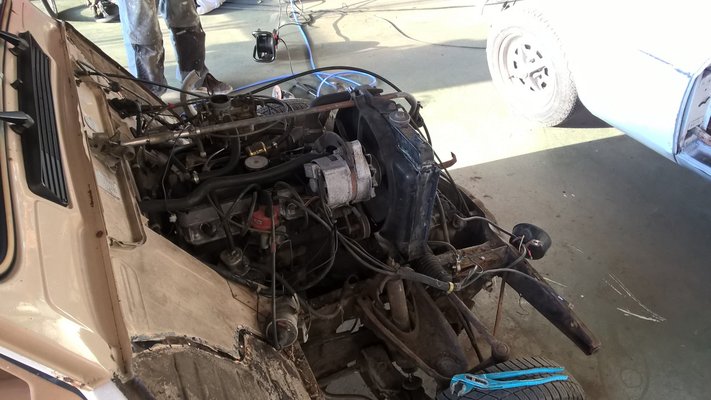

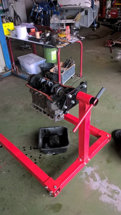

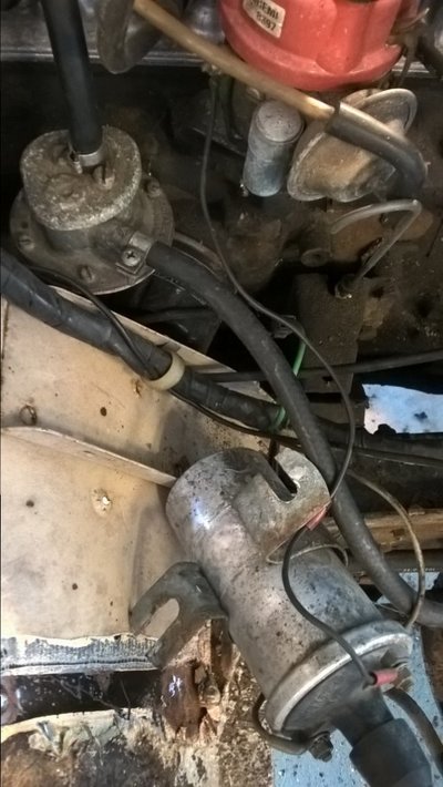

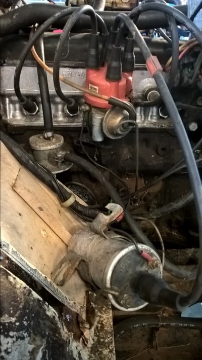

Some progress on cleaning the engine. First how it was on the car before I took it off

Great progress ! What size engine ? My GTL 688 engine looks different
mr-reno-139
AKA Paul Cunningham
2,216
lancing west sussex england
It's a ventoux engine 3 bearing runs opposite direction 845cc
More popular overseas than uk as after 79 nearly all uk cars and vans 1108 cc

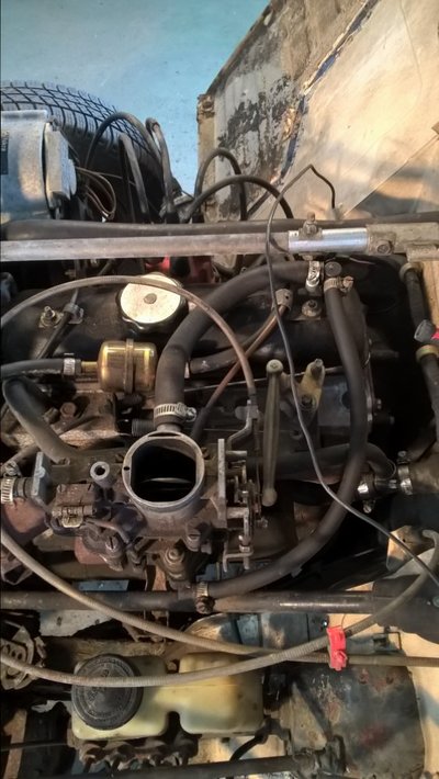

Hi,
motorcode is B1BD7/07:
I'm not sure: with the fly wheel in front of you, what direction is the engine running? Clockwise or anti-clockwise?
harbourseal
Renault R4 Lunatic
1,021
Breda The Netherlands
It runs anti-clockwise, but the dizzy runs clockwise. No trouble reconnecting the spark plug leads. 1342 beginning with the one closest to the alternator counting from the flywheel.

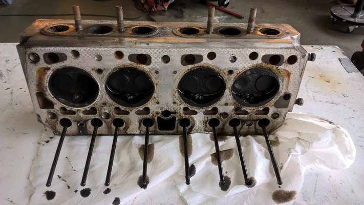

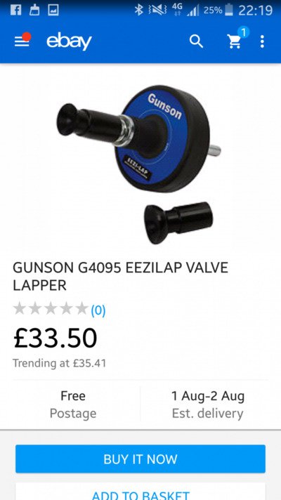

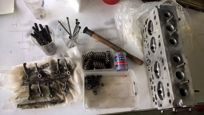

As you are supposed to rotate valves back and forward☺Screenshot_2016-07-27-22-19-54.png

... unless your drill has a reverse direction ... :whistle:

The tool I use also attached to electric drill but creates back and forth motion

Thanks for that tool! Seems like it is very useful.

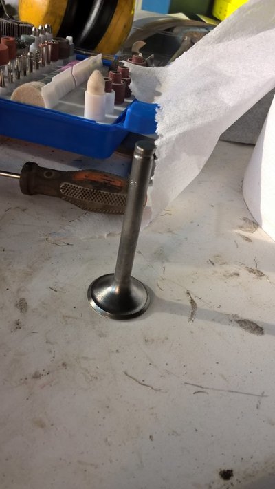

EDIT
Found this comment on a youtubevideo which also used a drill. Makes sense, learnful lesson for the next time:
ER You should NEVER rotary lap a valve in esp with a drill, it HAS to be a BACK AND FORTH action then LIFT OFF the seat to reset the valve paste on the seat, (as the paste grinding sound goes quieter usually 4 or 5 times ) then turn the valve a few degrees and then rept motion. like starting a fire but if you rotate it, you burn scars into the seat,, meaning the valve seat gets hotter and clogs with carbon deposits in these scars, which then burns the seat again meaning another head rebuild. And you start the VALVE Grinding with COARSE paste, then clean off and move to a SMOOTH grinding paste for a nice consistent groove free flat greyish looking seat ! The best way to check if it has worked is to use a soft pencil like a HB and scribe three vertical lines at 120 degrees apart on the seat when you refit the valve on the seat twist the valve when in contact with the seat and the 3 pencil marks will rub evenly along the seat, if not then the seats need regrinding again or you need new valves and or valve guides.,
This is for the lazy mechanics. EAZILAP by GUNSONS, been here 40 odd years, a DRILL ADAPTER, which oscillates back and forth ( )
http://www.ebay.co.uk/itm/Gunson-G4...nds-Grinder-22-28mm-Sucker-Head-/310719942809
