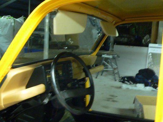

Hey all,

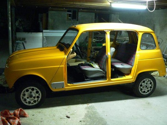

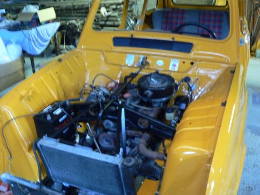

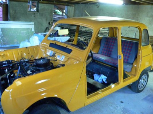

Did some work on my 4 yesterday again. A friend of mine helped me during the morning. We installed the cabletree (right word?) and we attached the backlid. My friend inspected the main brake cilinder, which turned out to be usable luckily. Later on I installed the backseat, the rest of the dashboard (fuses etc.) as well as the gearshifting mechanism and some other enginebay components. A few (bad) pictures below.
You're doing a great job there Rutger, it's going together well. For cabletree read wiring-loom. Regards Brian.

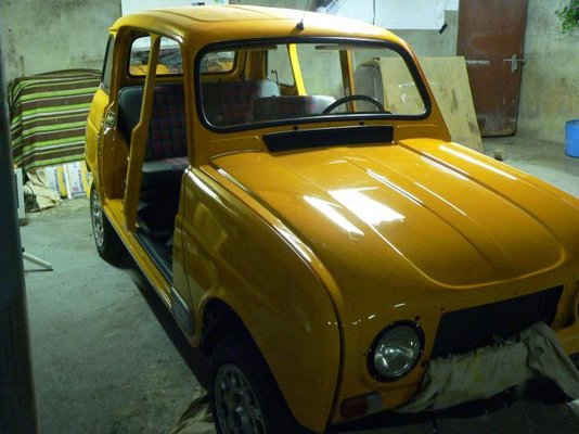

I've been busy this weekend again. Weekend before that I had exams, which I passed, so that's a good thing. I now plan to be ready before Christmas, which I think might be my first realistic deadline haha.

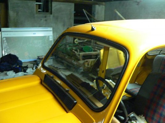

I put in the windscreen and redid the upholstry on the driver's seat. Ofcourse did some other things as well but they don't really catch the eye so ...
Here's a few (bad) pictures.
Rutger

Keep on posting your success, excellent work !!!
But what's that with the antenna?
Looks pretty goofy!
I would get me one of these ...

Thanks Barnfind!
And those antenna's are indeed definitely more awesome! I will consider changing it! It's kind of a funny looking thing indeed :p.

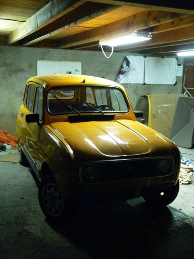

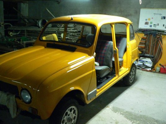

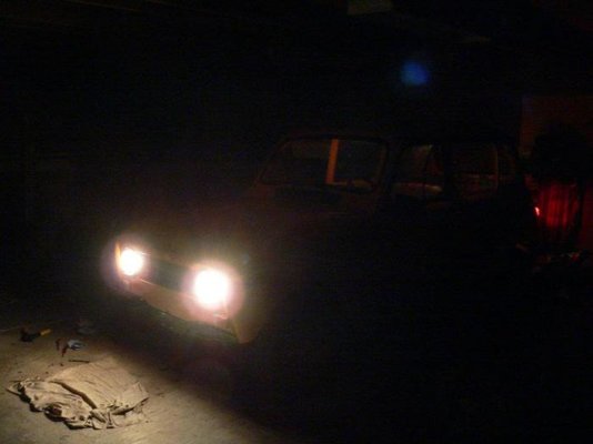

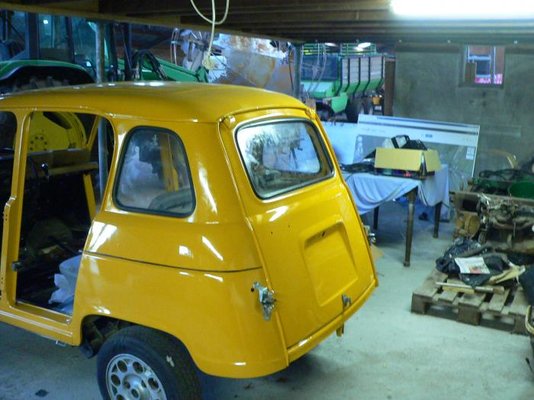

Just a real quick update.
Later on I will post a little more detail. The engine hasn't ran yet, still need to fix the brakelines and bumpers etc.
A very happy new year to y'all!
Rutger.
