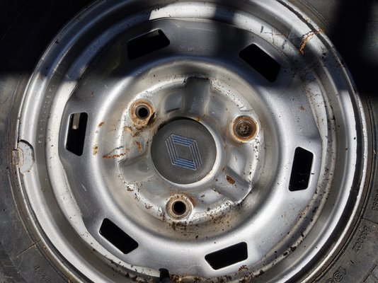

I'm new here. Just bought a 4 GTL, 1981, and I'm doing some restoration.
The current the rims have holes and I'd like to replace with solid rims and attach hubcaps.
Is this possible for my model, or is there a work around?

There is a work around. See the last photo on https://www.renault4.co.uk/gordini-brakes.htm You need to countersink the bolt heads that hold the brake discs in place as there is no clearance for the bolts in the silid wheels. Also you need to fit Bendix brake callipers and will have to grind some metal from the outside of the calliper and the sliders to clear the wheel.
or make a spacer to fit in the big centre hole of existing rim with a threaded hole to fit bolt on chrome cap
someone on here has done this already

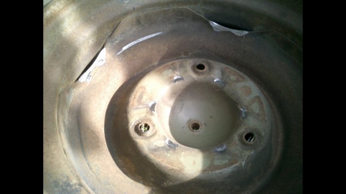

be aware the consequences of fitting early wheels to the front of Screenshot_20200429-141117_Photos.jpgdisc brake cars
note 6 bolt marks on rim and damage rim itself
Ooouch! I don't want to run into rims rubbing.

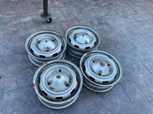

In the interest of not starting a whole new group for a related question: will Renault 12 wheels fit on an '85 Spanish built R4?
I recently discovered that one of my current wheels had a single hole drilled out to fit a larger stud so I'm on the hunt for at least one replacement wheel or maybe a whole set if I have to.
Here's a picture of the wheels in question for purchase:
What do y'all think? I'm assuming the bolt pattern is the same but should the same assumption be made for brake clearance?
No chance Renault 12 are 3 x 150 stud spacing which is no use for a Renault 4 which is 3 x 130

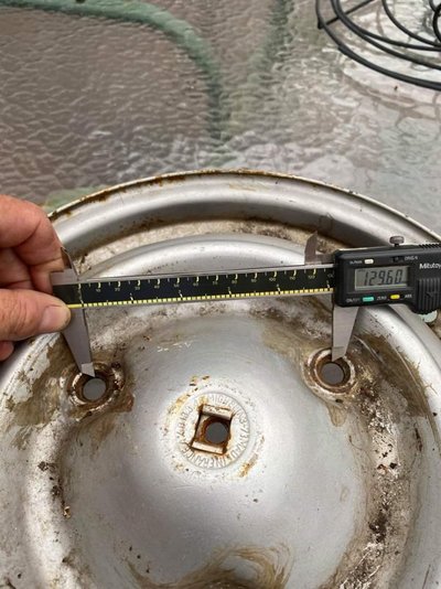

Well, that's unfortunate. How about wheels from an R5 ("Le Car" here in the US)? They're the easiest Renault 3 lug wheel to source over here.
Turns out these wheels actually are 3x130! The owner says it's entirely possible they didn't actually come off of a Renault 12.
