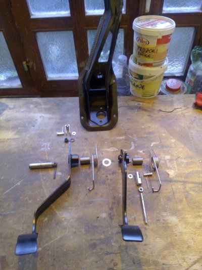

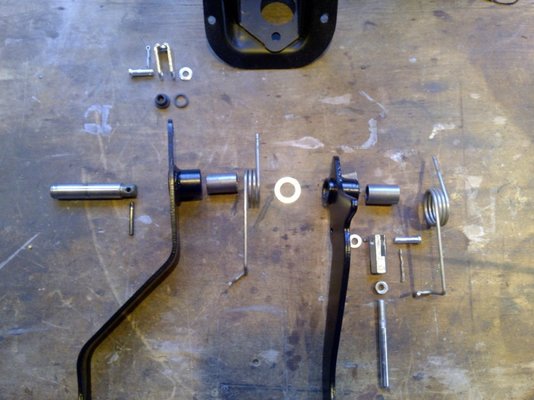

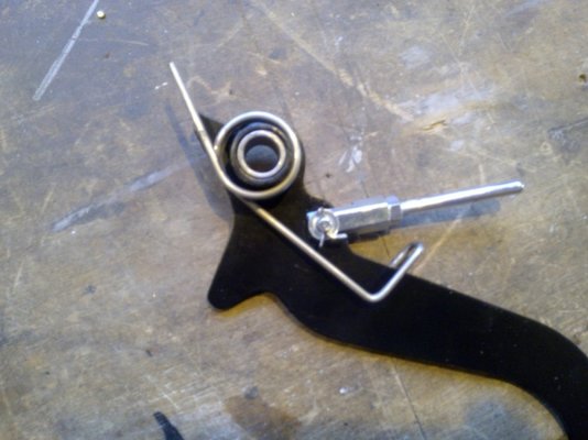

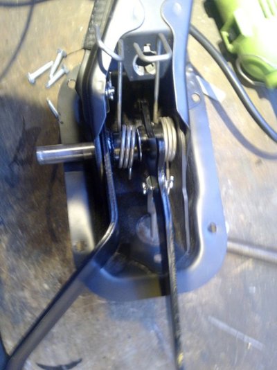

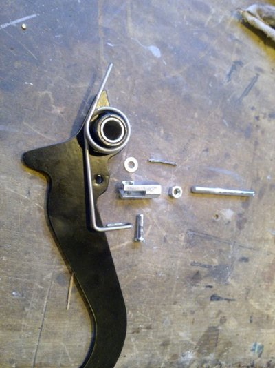

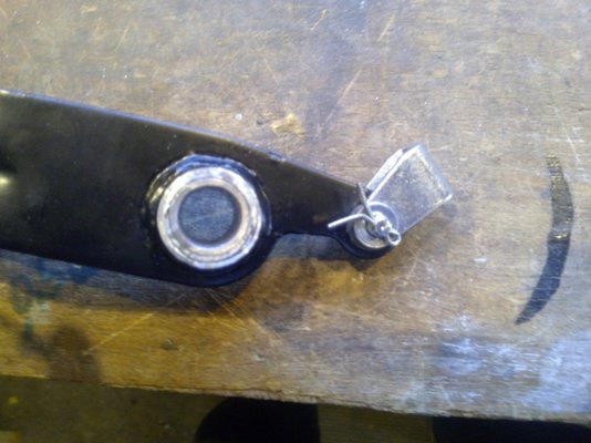

Pedal assembly!

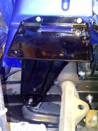

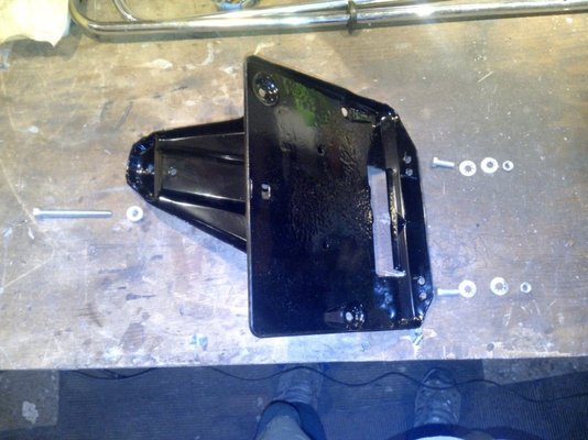

Accu stand

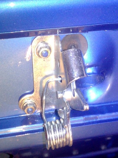

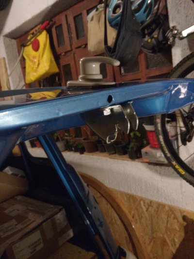

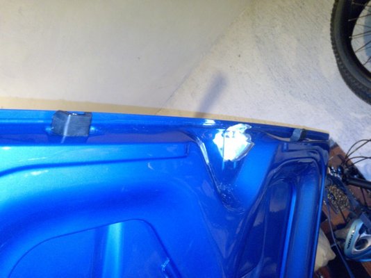

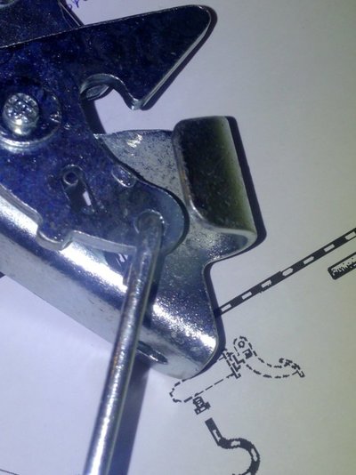

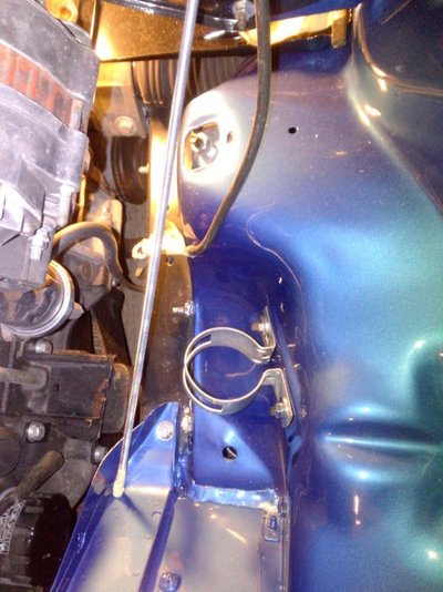

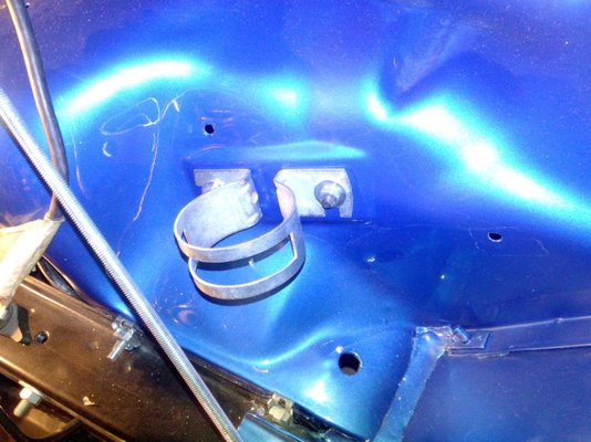

Hood lock

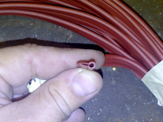

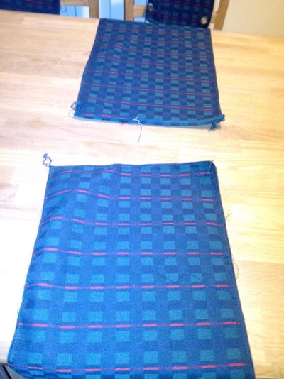

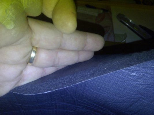

Kederband (do not know how to call it in english) It is rubber end for seat upholstery (GTL seats)
Seats are at upholstery workshop. Vinyl will be changed and middle part (tekstile part will be the same)
Just realized that i do not have picture of seats and door trims.
(Kederband (do not know how to call it in english) It is rubber end for seat upholstery (GTL seats))
Hi Petak, it is called "piping" in English, because it is like a small pipe. sometimes it is solid core, but you have hollow core. When they make things like suitcases, they can put a wire stiffener in the hollow part of the piping so that the suitcase keeps its shape.
Hvala doture!;)
Mojobaby: Thank you for English instruction....now i have found many adds at ebay....but it is easy when you know right name for part.

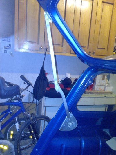

Meanwhile!

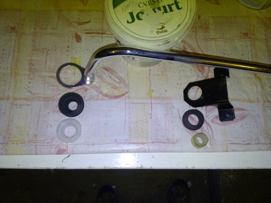

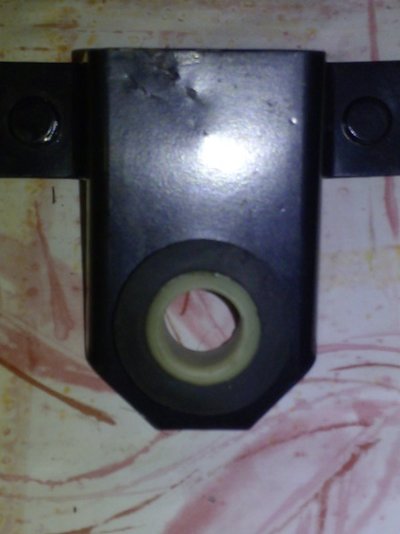

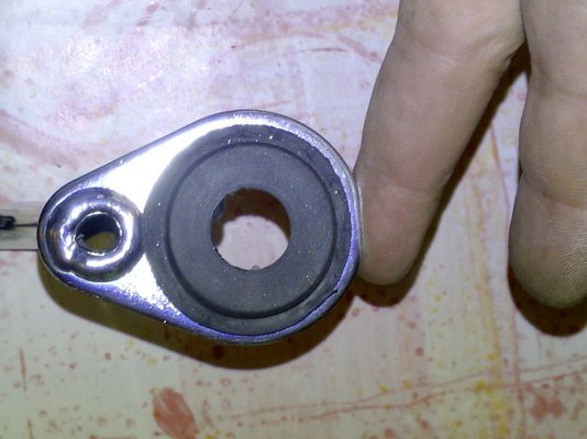

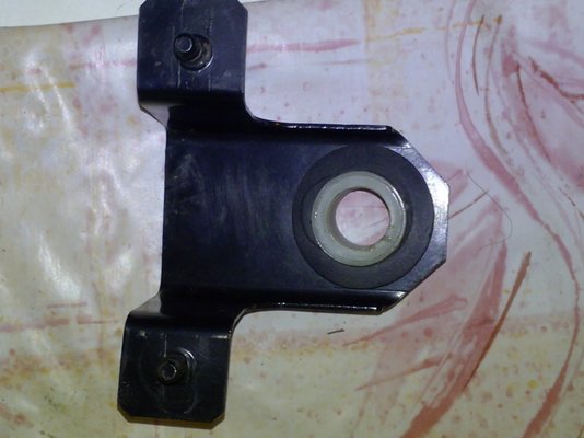

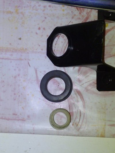

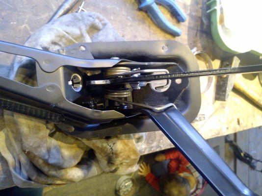

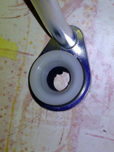

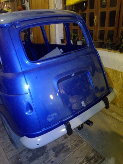

Gear lever bushes put together and lever installed in car. Some steps i forgot to take pictures...I was to excited for building up car

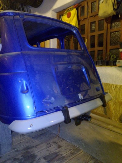

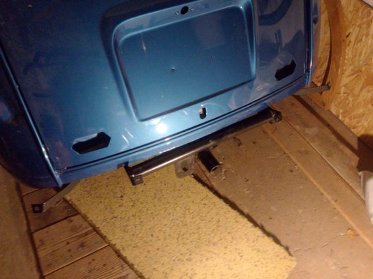

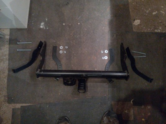

Towing bar in car

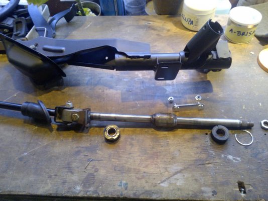

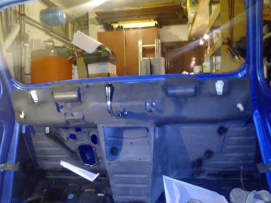

Steering column in parts....still not in car....waiting to put insulation first

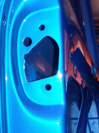

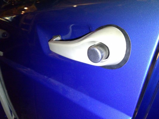

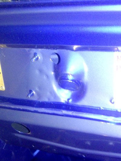

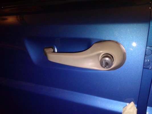

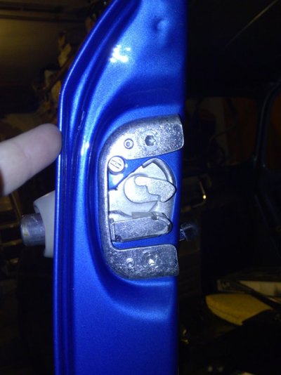

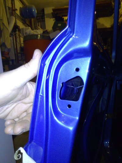

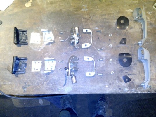

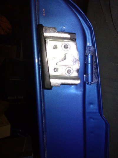

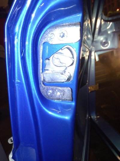

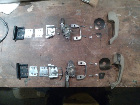

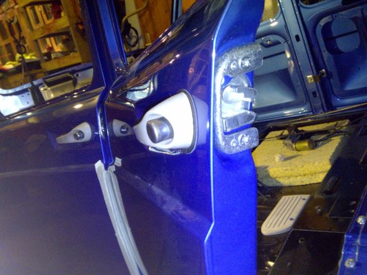

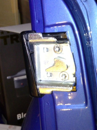

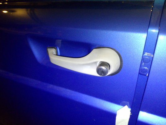

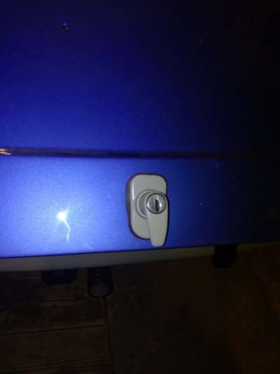

Door locks, and handles put on car

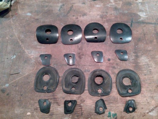

Rubbers ...fresf from owen

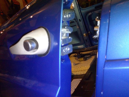

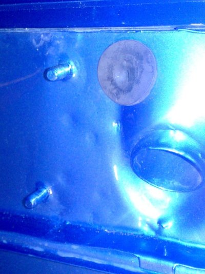

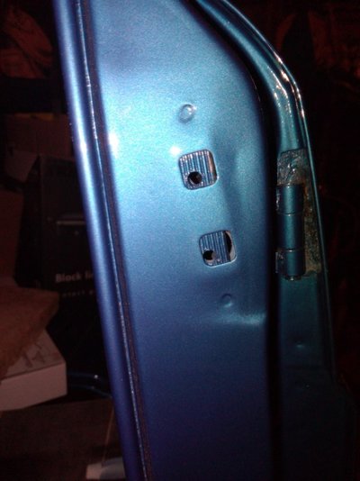

Front door locks and handles

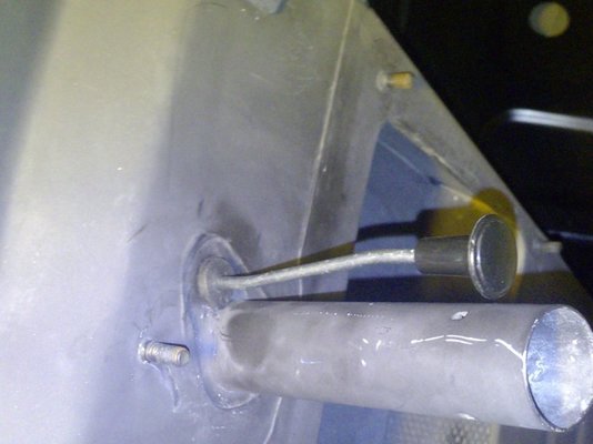

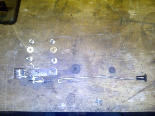

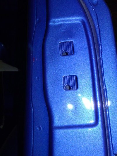

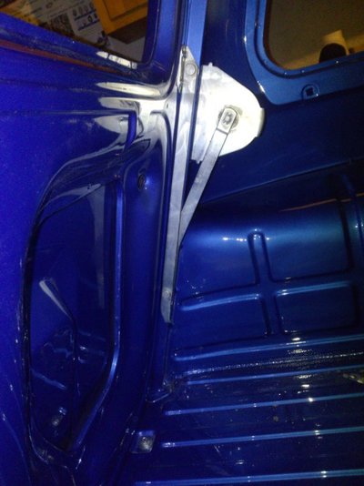

Rear door locks and handles

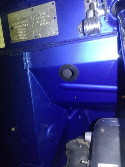

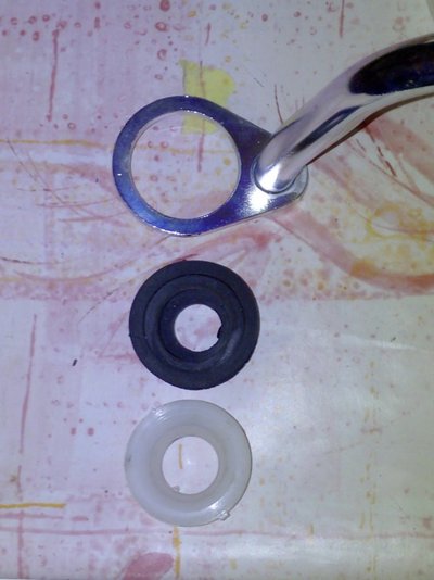

Rubber on ventilation opening

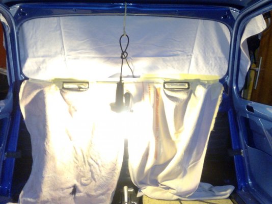

masking everything so that can apply adhesive

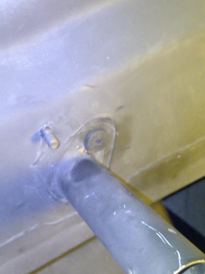

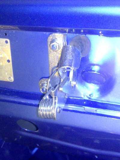

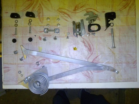

All the parts that you are putting in look new. Are they new or did you just clean them up. Perhaps electro plating on some parts and respray other parts?

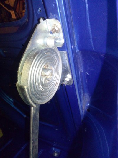

For example, the spring on your rear door. Is that plated or sprayed silver?
All shiny metal parts that you see are old one.
They were not broken, just used for 20 and more years, dirty and little bit rusty.
First cleaned with electrolysis and then zink galvanized (electro plated with zink)
All door locks, rear door spring with hand, front bonnet lock, internal door handles.
That is why they look so shiny.
Black parts around engine bay and inside the car are additionally powder-coated
And bumpers are also powder-coated
very few parts are brand new.
I have 2 donor cars aside so using best part out of three.

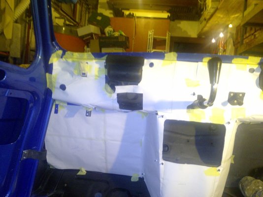

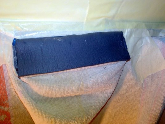

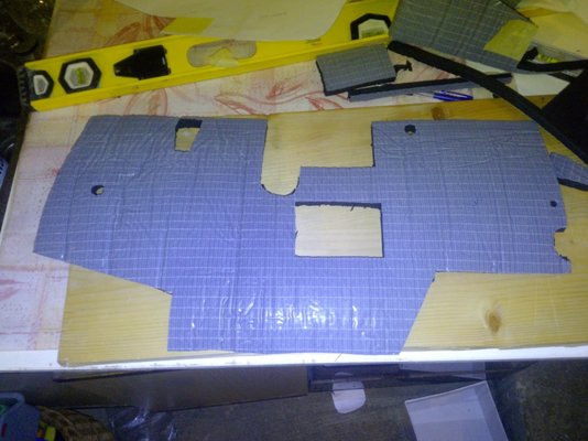

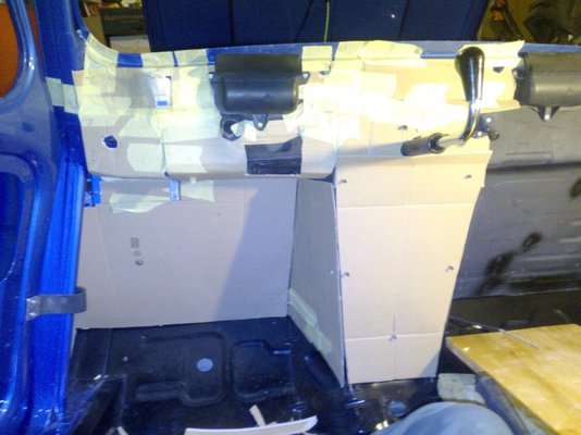

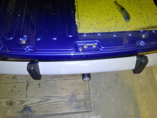

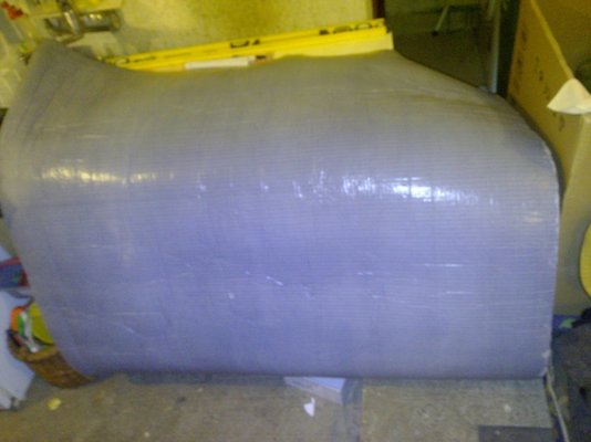

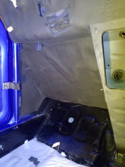

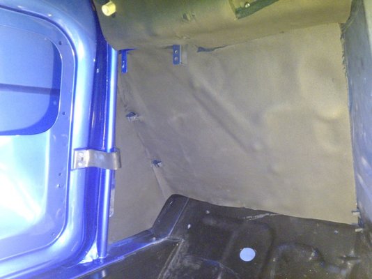

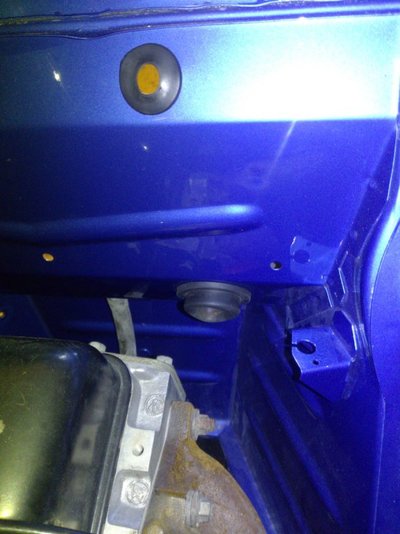

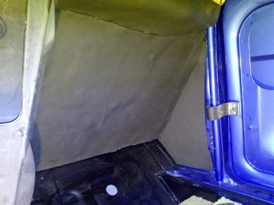

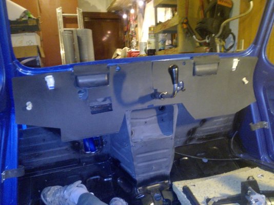

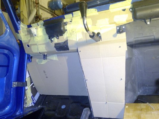

Some insulation is put inside cabin!
1.template
2. insulation K-FLEX DUCT NET adhesive 12mm tick
3. first peace
4. firewall behind instrument panel
5. Right side
6. Left side
Problem could be when i start to mount parts that goes under instrument panel so some places will be cut out so that all fits inside.
Also, on lover parts of insulation, in front of driver and passenger i plan to put some guarding foil ( tin adhesive foil that is used for car advertisements on vans) to prevent destroying insulation by throwing something on shelves, and accidental bums with boots
