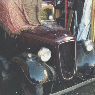

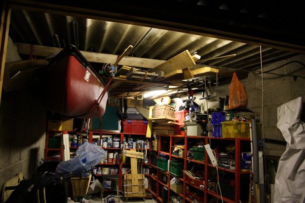

So now its WOMBLE's turn. But the first stage is the tidying (and more) of the garage. The amount of stuff inside was incredible! My Austin seven 1934 with another one inside it. Tons and Tons of semi useful junk. I took three People Carrier Loads to the dump before I could even get in the door properly.....Type classification : 'Hoarder' :-)
So A whole two months late starting on WOMBLE the garage is now useable (though there is still a whole load of junk outside the garage which I'm loathed to put back in)

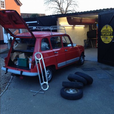

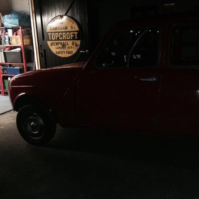

Well the new garage doors are on... what an improvement to up and over and bang your head one previously fitted. Walls are painted white.
Junk (well most of it) is gone (or displaced outside) Floor is becoming blue so I can find dropped items. And a load of skip rescue flourecent lights are fixed up.
Glad to say WOMBLE fits in beneath the canoe even with the roof rack still on.

Ok so SIX trips to the dump and still there's more..... Finally the old set of wheels are on. They are the earlier pattern and do not fit on the front wheels without removing the brake callipers on a GTL . I also needed to make up some temporary spacers too As they still rubbed on the hub in places. I used 12mm lengths of 15mm copper plumbing pipe to make up spacer washers. It's all simply so I can push Womble in and out of the garage. Mind you looks pretty racy with no bumpers and spaced wheels At this moment everything for powder coating is being removed. These include of course the wheels that belong. (Destined to become a grey/cream) All the support brackets in the engine bay including the battery tray (destined to be black ) and finally the Rocker box cover in a nice racey red! These will be the first items to be shipped out to a specialist. ( Aerocoat of St olav's on the Norfolk Broads. On the return of these parts the rocker box will be re-fitted and next trip out will be to the engine rebuilders with the complete engine. Currently obtaining quotes for a professional spray job. Maybe including body welding too. image.jpg

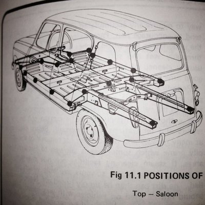

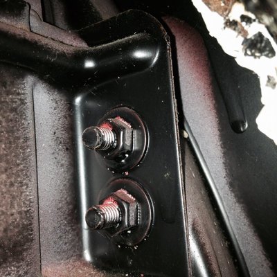

image.jpg image.jpg image.jpg image.jpg image.jpg image.jpg image.jpg image.jpg Well it's a lot warmer this evening so managed to get on well despite 7pm start in the dark. All the interior apart from the dash is out and begun unbolting the body from the chassis. Interestingly enough the bolt positions on the superbly illustrated Haynes manual are incorrect . Well on my model at least. I have three bolts on top of the side members not four on each side. Two at the front below the heater not six across the front. Have confirmed a botch repair has been carried out and the body welded to the chassis at the top edge of the passenger front footwell.

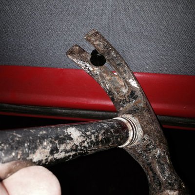

Along the way I discovered after having bust two door card plastic studs that the best way to remove them was gently with a claw hammer slowly twisting and prising them out.
When I come to spray paint the body I'll need the doors off. Now I've read on here it's a bit of a job to grief the roll pins out of the hinges. But closer inspection reveals all the bolts are accessible so they could all just be unbolted. Or is this not a good idea? Whatever happens I intend to get it all aligned correctly when reAssembling and welding in the replacement quarter panels.

Mine R4 had even more bolts than shown on this picture. 23 in total.
Did you looked inside front wheel arches...there are 6 bolt that hold body to chassis?
Will send you PM with locations on mine not to ruin your topic and your photo elaborate!

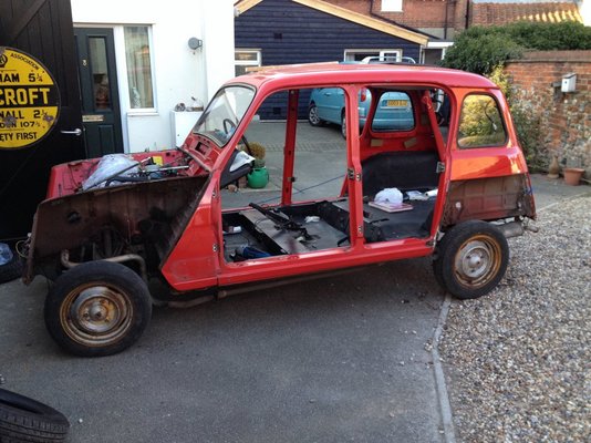

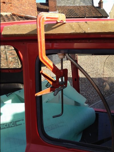

What a brilliant day out in the shed. Well the bonnet, doors tailgate and all the wings are off in short order. There are a couple of tricks I learned along the way that might be useful to others: I have noticed comments about removing doors by greifing the roll pins out then struggling as they come off so they don't bend any metalwork. Well I just unbolted mine and used a quick clamp to hold the door still so I could do the whole process single handed. I also discovered the bolts had been over painted in the factory clogging the threads. A very quick blast with a blowtorch sorted it immediately and nuts came off easily while still warm. Outside paint not even scortched. With the wings off some bodge welding is evident. In three of the wheel arches the body has been welded to the chassis. A quick zizz with a cutting wheel on the angle grinder sorted it . More tomorrow ! image.jpgimage.jpgimage.jpg

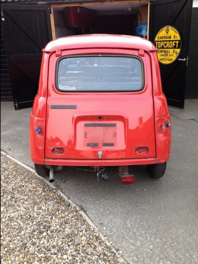

Ah ha....well as it happens the resto is progressing quickly... The new chassis is together with all four wheels on and with a spot of varnish will look a treat and definitely rust proof! WHAT? I

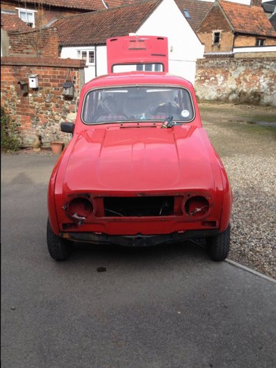

Ah you see oh ye of little faith....now with the doors on it's really taking shape

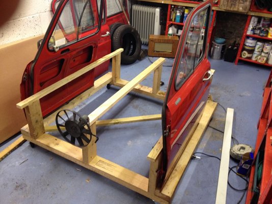

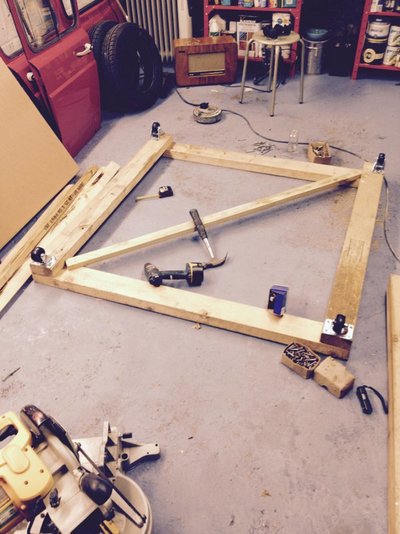

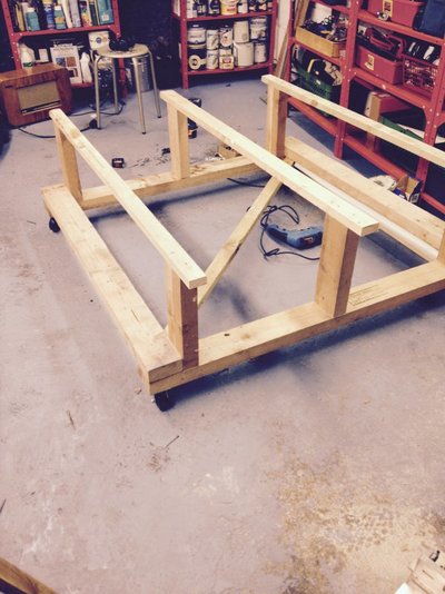

Ok ok it's a 'DOLLY' as we say up here in Norfolk Land. It's to sit the bodyshell on while the chassis is up in Louth with Simon of RENAULT reborn . I can then continue working on the shell and move it around in the shed. So that's what I made tonight along with taking all the brackets off the bumpers. Straightening them and giving them a good fettle before delivery to the chrome plater tomorrow. Let's see what he has to say about them

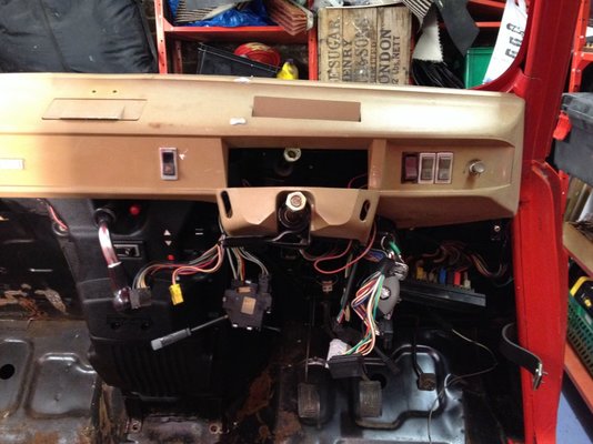

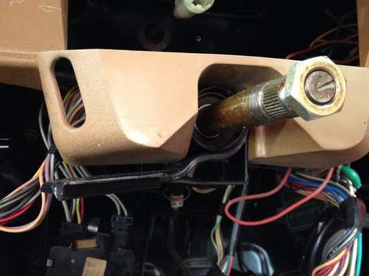

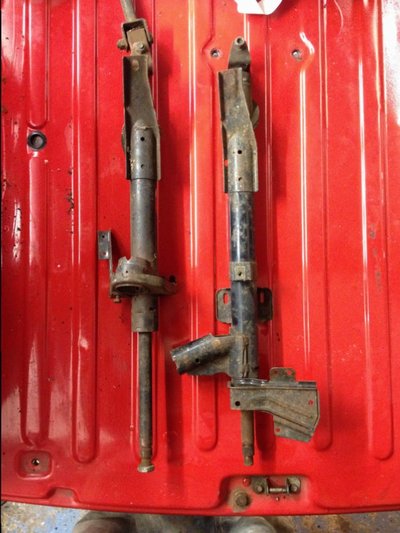

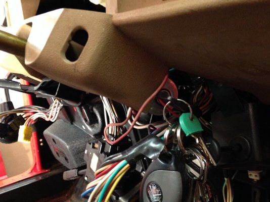

Tonight oi mostly bin eatin marshmallows and pickled onions and apart from that I've been experimenting with the earlier dashboard I was lucky to get hold of. It fits on pretty easily as you can see. A bit of jiggery-pokery and it should all work. Paul (Mr Reno ) loaned me a couple of steering columns (one early and one late) as they appear to be different lengths. Closer inspection reveals they are almost identical length but the collar does not extend up the shaft much on the early version and the ignition barrel is on the underside. The bracket holding the stalk switch will have to be ground off the GTL column and the earlier switching used as it fouls the switch housing. The barrel is still accessible though I will need to cut the switch housing away a bit

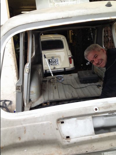

This was all so I could set off at the crack of sparrows this morning . And I did! 4am and 5am on the road from Wymondham Norfolk to Worthing Sussex to collect the donor body and bits from Paul (Mr Reno) when I arrived I was pleasantly surprised to be suddenly in the presence of the delightful 'Ornella' and her owner.... But more on that another time. So two punters for Paul this morning. Paul and I set to on the old shell ( no not Ornella! ) removing the dashboard wiring loom. Heater and pipes. Finally separating the body from the chassis. A friend of Pauls turned up to kindly help us lift the body onto the trailer. Soon after everything securely strapped down and the body supported on 4 old tyres to prevent the sills from being distorted ( I need those bits!) so now I'm home tired but excited by the prospect of some really choice lumps of body to go at saving loads of time fabricating new body sections prior to Welding Womble. So a steep learning curve. Finding out the detail of how an R4 goes together, the benefit of Paul's considerable experience had it dismantled in no time. Yes a great day and new friends too
