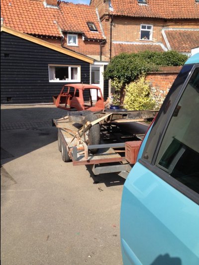

Began with collecting the trailer from Rob Vincent of Vincents Garage

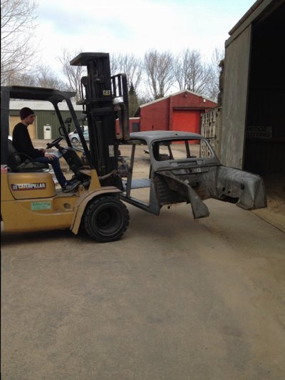

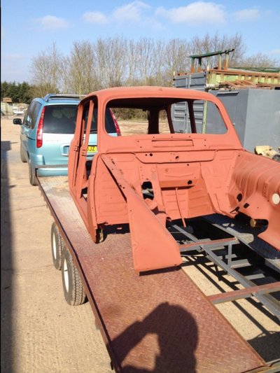

Then over to Blast Power services to collect the old Bodyshell that's been blasted in all the naughty places . It's come up well they did a great job. Before and after photos

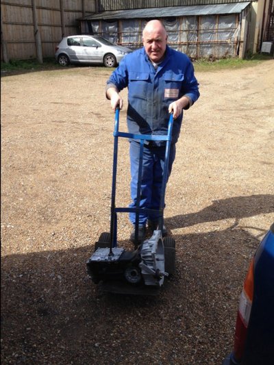

Then over to drop off the gearbox with David of J R Dain transmission specialists in Norwich. To leave them the gearbox for a complete overhaul. I caught them at a bad time as it was their lunch break but they still helped me out as I had not the opportunity to split the gearbox from the engine. It was still in the boot of my people carrier in one lump. So I set to with the socket set and soon had it separated and into the workshop. David put on his best footballers pose for me with the gearbox.. Priceless

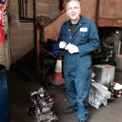

Jump back in the wagon and then off to a long established engineers... Whitmore's of Briston North Norfolk. Where Phil was waiting for the engine. Another fine pose!

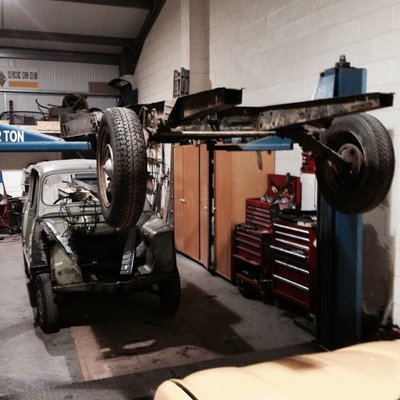

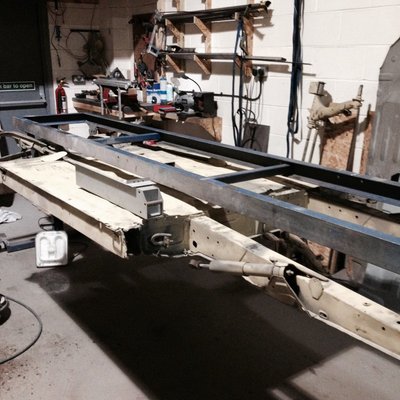

Back in the wagon again this time for the long haul right up to Simon Pocklington of Renault Reborn. Simon gave me some really useful advice and together we agreed on a strategy to repair my chassis. Simon is going to weld new half floor pans on. Having cut away the old repaired the box sections and rear chassis. All blasted and painted and ready for re assembly. Simon is a specialist having been in the Renault trade man and boy. My Chassis is shown here up on the lift so we could have a good look round. It will soon be placed on the chassis jig so it can be rotated and checked for straightness/alignment. While I was there I took some photos of other cars he was working on including a very eye catching promotion car. looked really good nice and shiny too .

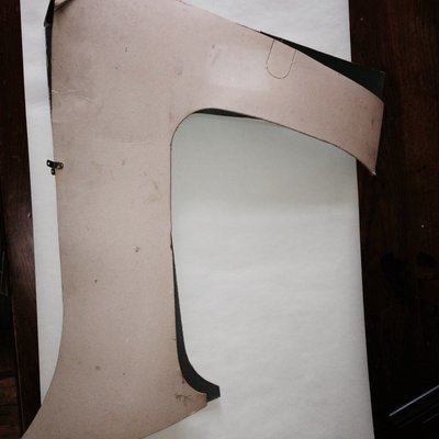

Oh BOTTOM! I've wrapped up cill plates for you Endo but post office tell be as they are longer than 61cm they have to go parcel farce and that's £11.50 odd. You can have the plates for nuffin. Was expecting them to be £2.80 which I would have also let go. I've wrapped the plates in the template of the rear quarter interior trim shape so don't throw all the wrapping away! For others interested Im expecting to post Autocad drawn PDF's of the trim panels on here so others can download. Endo PM me what to do

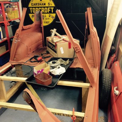

Well after an awful lot of head scratching I've taken the plunge and cut up the donor bodyshell. Truthfully it's been a hard decision...kept asking myself have I done the right thing slicing up a seemingly great Bodyshell. But the roof was badly dented and the decision to get it blasted was a bad one. The flat areas had been distorted by too much pressure so the boot floor I hoped to use looks more like a freshly plumped up duvet. . Oh well as Malcolm said every restoration has its low point. I hope I've just passed it. Onward and upward! I will have some bits of cill for Mike and I think someone wanted boot lid hinges and the area surrounding? Here is how it's looking
