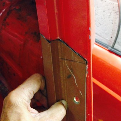

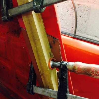

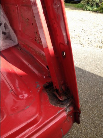

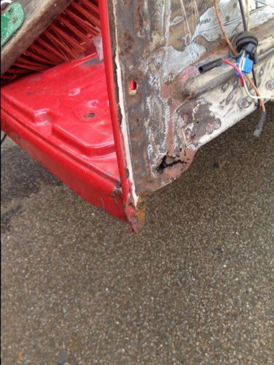

90% of the welding done . One of the hideous back corners now fixed and now once more unto the breech dear friends to fix the other
Oh dear you do seem to have more than your fair share of rust to deal with still keep up the good work
Never welded on the body... but you need to be pretty confident to prevent distorsion, with thet thin metal sheet...
Got the hang of it now, lots of checking , measuring and offering the cut replacement up against where it's to fit. All butt welded . Hard bit is deciding which bit to cut then a series of welds so the shapes don't get lost in the mix . It's actually quite enjoyable but the gas bottles are expensive !

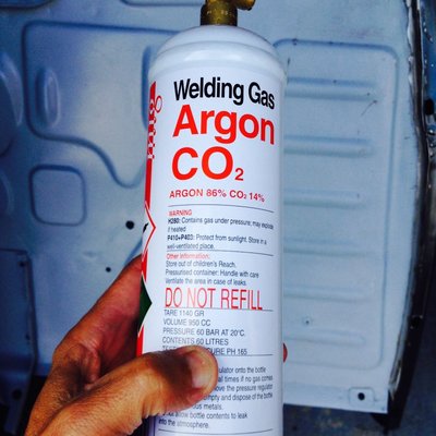

Are you working with the disposable ones?
I preferred to hire a 14 litres tank. .. 1,5 euros/month for renting, around 25 euros for filling... and with one tank I did the whole chassis and a bit of exercising welding before... now there is still something left but given the light weight of the tank not a lot...
No I have been unaware at the beginning, then thought each time I bought a new little bottle it would be the last
But I did discover there are two capacity amounts available in the same bottle size !!! Seems the little bottles are 60 or 110. Halfords in the UK are the same price for the 60 size as Machine Mart are for the 110 and I got caught out twice thinking as the bottle was the same size so would the capacity. So I lost out badly. In future I will hire a bottle or get a larger size from a specialist hobby weld supplier . Also found grinding flap discs in Aldi for only £3.99 for four! Machine Mart are £7.99 for one!

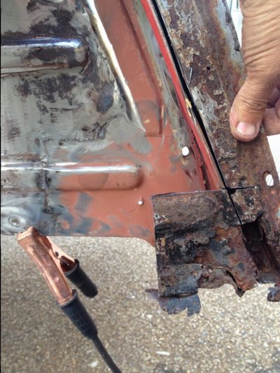

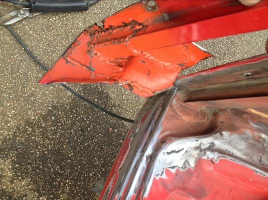

Last nights progress ...bit slow took a wrong decision at one point and doubled my work

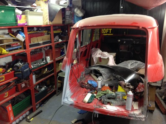

Got the right hand side tacked up nice and square. Nothing flapping around now so onwards and upwards!

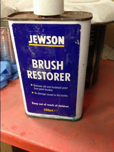

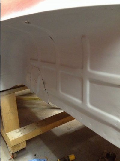

So ..... Here I am in the shed again ;) FINALLY found something that would dissolve the glue which stuck the wheel arch rubber mats on. I've been through every volatile substance I could find. :drunk:In the end it was Brush Restorer that did it.

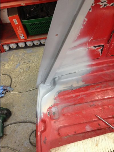

Sealing off each area of repair as I go now before rubbing down everything and checking the fit and alignment of all the body parts. Ooh I can't wait for the paint shop to take over :worms:hug:
