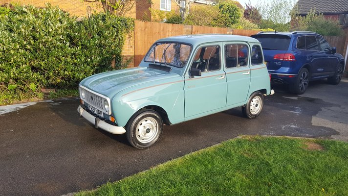

Great news I've now got a Renault 4 in my garage, purchased from member Declan in Kent yesterday. So stuck a solid 160 miles on her yesterday and what fun I had, m20, m25, m3 and m27 loads of waves and smiles. So F281 HAK is now near Bournemouth. Projects underway, replace the door locks, new door seals and boot seal, window runners, new exhaust and replace the gearbox oil seal as it's now leaking well after its blast on the motorway. So I've spent a few quid today may the transformation begin... Anyone near me who might be able to offer advise I will not turn you down. Plan to shot video and photograph progress

Another R4 in dorset :D
Welcome to the forum, what a nice looking car. Looking forward to updates on your progress.

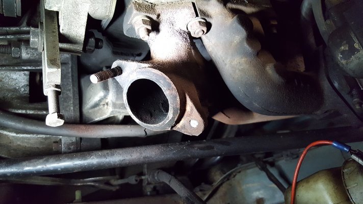

If you take the manifold off to drill out the exhaust stud, check the flatness of the manifold where it meets the head (check for little steps between the inlet/exhaust sections) - mine was way out - the exhaust sections had warped away from the head, making sealing a challenge. I had the manifold machined flat.
