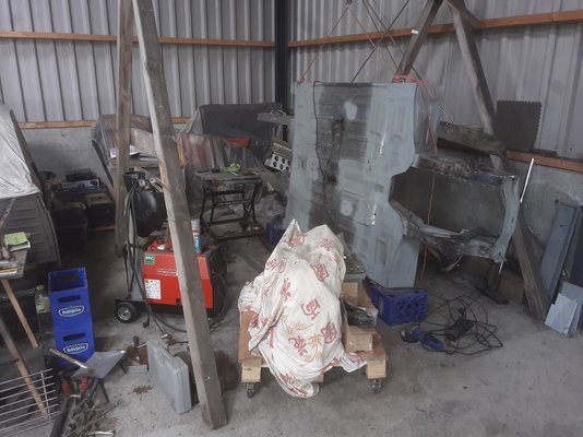

Update concerning the chassis repairs.
Lucky me my wife still let me spent some time on the Renault although it isn't much. After all the new house needs loads of attention

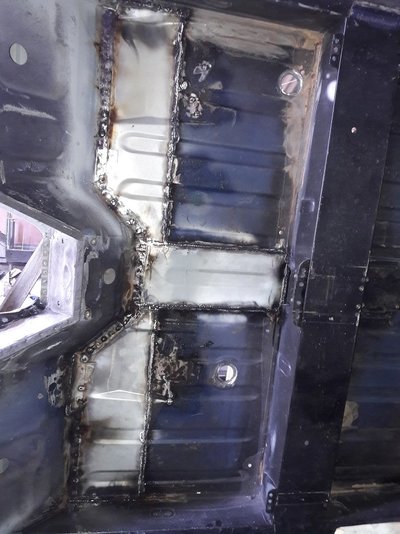

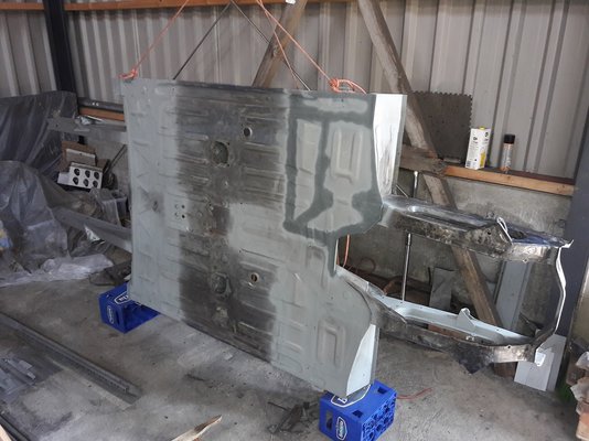

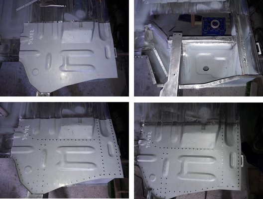

Further with the front center floor piece repair.

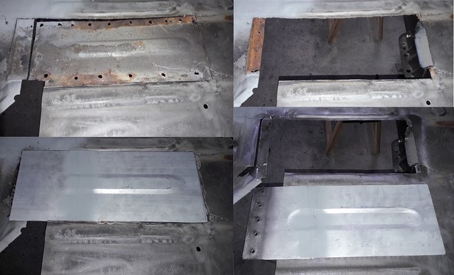

Cutting out the bad piece and preparing the replacement.
Then the welding proces follows and grinding and zinc protection.
Finally the floor can be closed.

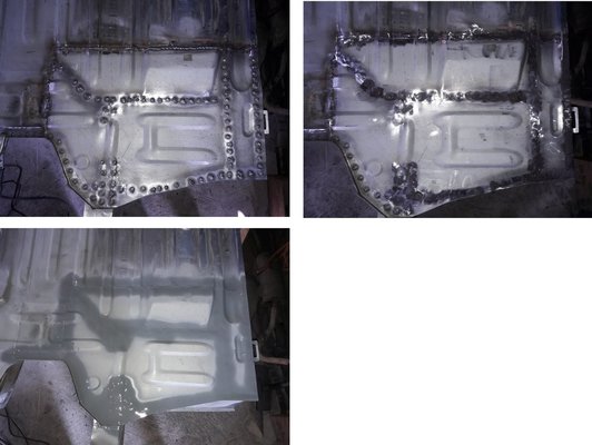

Step by step the following actions are taken, fitting the repair piece, cleaning and applying weld thru primer, again drilling the holes for plug welding and tacking.
Plug and seam welding, grinding, and the well known zinc protection.

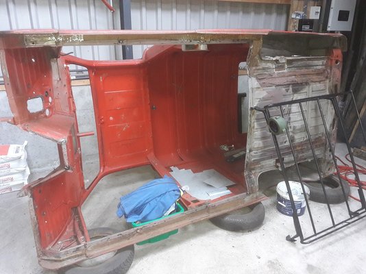

The chassis repairs are almost done. What's left is finalising the last bits on both the outside and inside of the chassis.

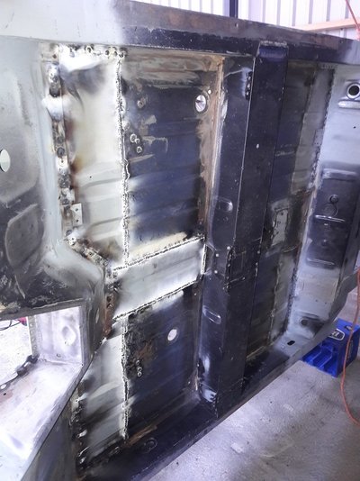

Here the chassis is flipped vertically so I can work on both sides.
Here a nice view on what welding on the outside does with the inside.

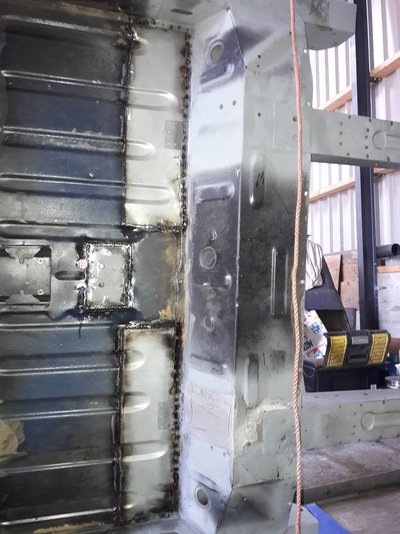

Some closer views, here the inside front section.
And the aft section
Surprisingly the aft section was welded some 6 months ago and still no sings of rust forming on the inside.
That's it for now and let us all hope that my wife will let me spent (more) time on the Renault
Cheers
Joop.
And the aft section
