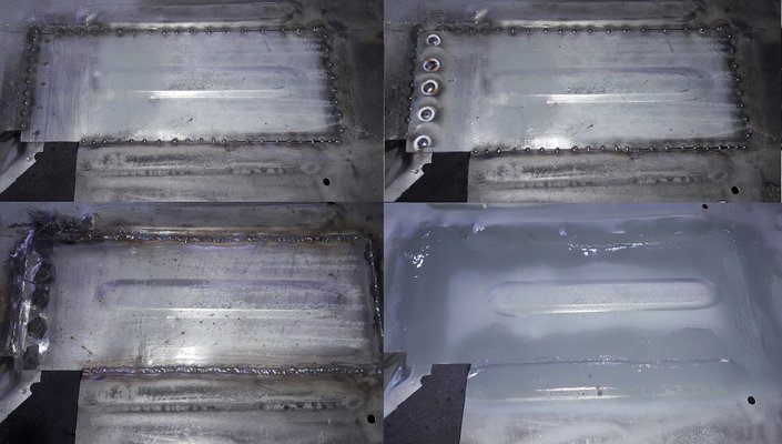

Further with the front center floor piece repair.
Cutting out the bad piece and preparing the replacement.
Then the welding proces follows and grinding and zinc protection.
Finally the floor can be closed.
Step by step the following actions are taken, fitting the repair piece, cleaning and applying weld thru primer, again drilling the holes for plug welding and tacking.
Plug and seam welding, grinding, and the well known zinc protection.
The chassis repairs are almost done. What's left is finalising the last bits on both the outside and inside of the chassis.

Lucky me my wife still let me spent some time on the Renault although it isn't much. After all the new house needs loads of attention
