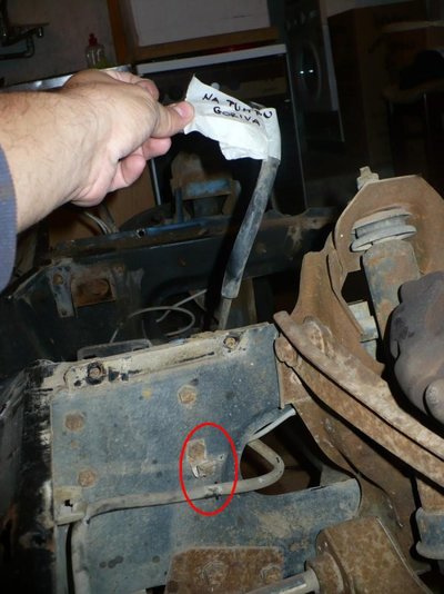

In the meanwhile, a cable holder (or maybe a pipe holder) was found broken; even if I don't remember what passes throught it, I proceeding in fabricating a new one.

This metal holder is for fuel line, and it is bolted on engine stand
No Petak, it's another one, the one for the fuel line is already at its place... thks one goes just above the starting motor, bolted on the same bolt of the left engine silent block...

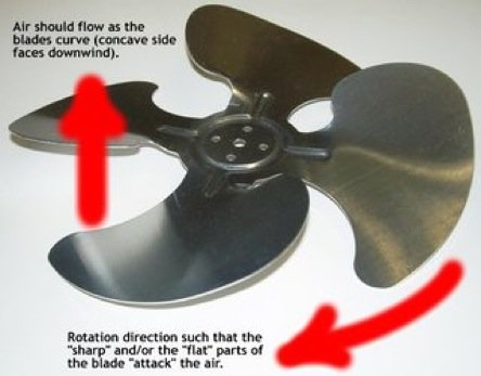

Hi Azazello, your engine is 845 and the fan turns clockwise. The fan blades are supposed to pull air through the radiator. Looking at the way your blades are curved, I think it would be better to reverse the fan.
Looking at photos above before you painted the fan, one edge of each blade is cleaner than the other. The reason for that I think is that the clean edge is the cutting edge and the dirty edge is when the blade "throws" the air towards your engine block.
Perhaps this fan is for an anti-clockwise engine?

So the "clean" edge goes facing the rad? I am still in time for reversing...

Mojobaby, you were right... I confronted another time with the original plastic one and it was facing the wrong side to the rad! Already changed position.
Thanks, you for sure saved me some headscratching.
