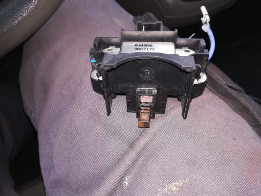

What a day.. I had an appointment for MOT at 11 am, when I wanted to start the engine I noticed that the battery was low. So I hooked up starting cables and due to my hurry, I connected the wrong terminals.. :doh::doh: Long story short, I cooked the alternator regulator. Aargh! But fortunately I also noticed that the carbonstick was broken off, no clue how that could have happened..

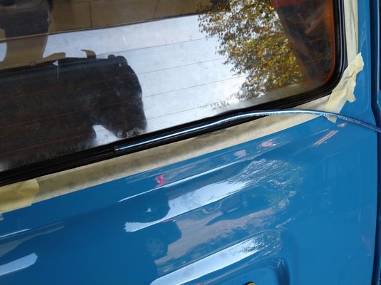

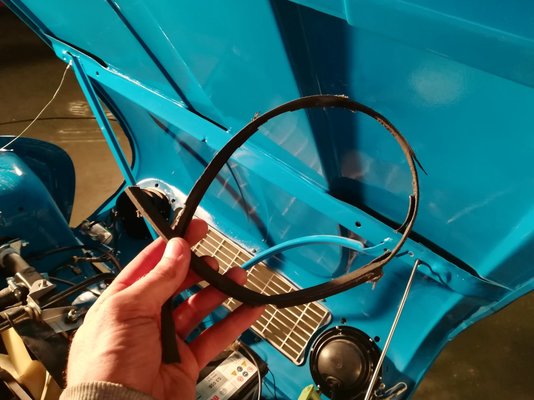

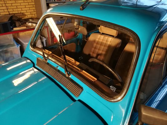

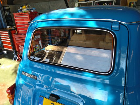

Put on the chrome strip, not a 100% perfect fit though.. O well, nobody will notice.

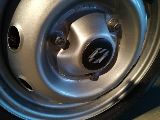

New wheel hubs

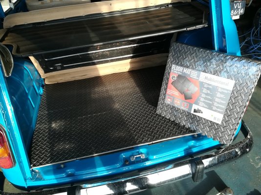

Some basic sound proofing on the floor

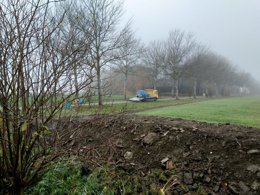

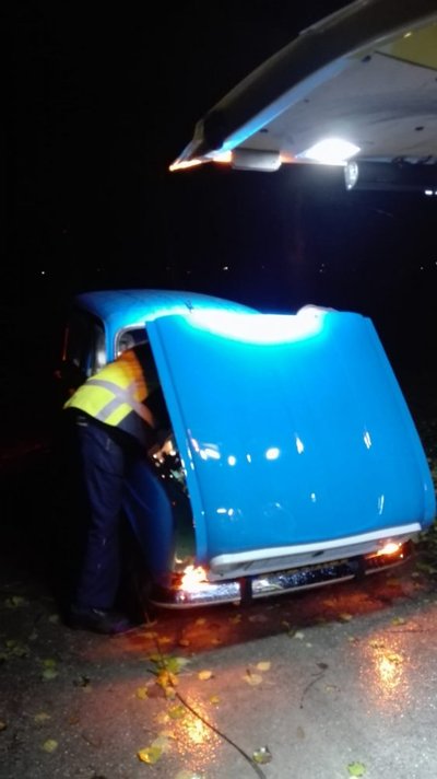

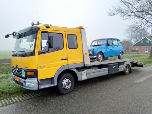

That was a lovely 30km roadtrip but than disaster struck. Suddenly the engine stopped working. Stranded in the Middle of nowhere, getting dark and in the rain. Fortunately the Dutch ANWB was very helpfull to transport Louise back to my mother-in-law.
Whatever happened? No ignition, but the most worse problem you can have. The rotor is not turning when engine is in gear. That means:
1: broken shaft distribution
2: broken distributionchain
3: broken camshaft gear
But first I need to transport Louise back to my workshop for a diagnose. Fortunately a friend of mine has a transportertruck.. In the worst case scenario I need to completely overhaul the engine again.
I was so happy that the project was almost done, having more spare time and just to enjoy the car. A real setback if you ask me :(
I will keep you updated..
