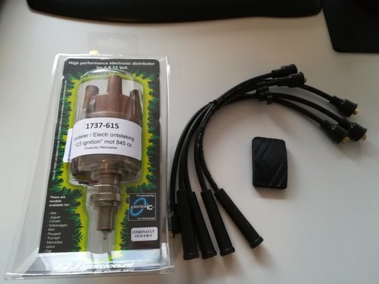

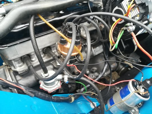

Good investment Jurjen. I have a 123 on my F6 for over 6 years now. Tried the different setting but gone back to the manufacturers setting.
Put in a new ignition coil as well, if you haven't done so during restoration.
JdeW
743
Laarbeek The Netherlands
A 123 ignition nice and as Robert wrote indeed an investment :)
I'm still curious about the difference between the original ignition set-up versus the 123.

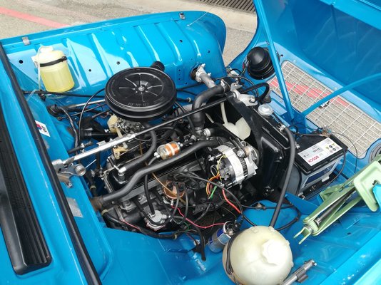

The ground through the engine bay in 1 st photo looks dirty and damp ;)

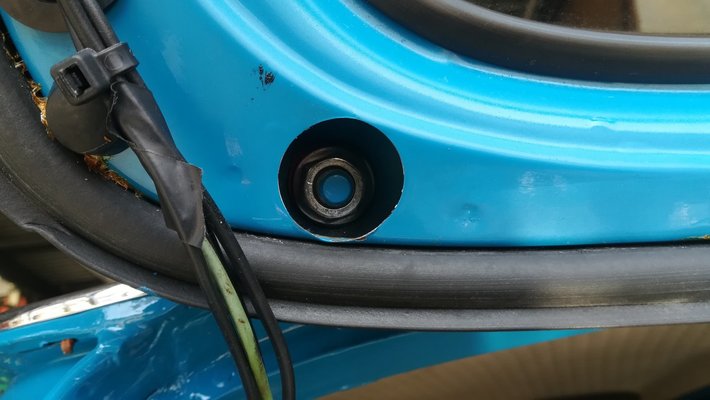

but now I need to make miles! (but first I need to fix the 'squeez' in the back.. Very annoying)
Yes make those miles Jurjen and that 'squeez' in the back could be the hat stand squeaking in it's mountings and hmmm that's a typical R4 sound :D you could apply a layer of felt in those mountings to 'isolate' that annoying 'squeeze'
Jurjenz
457
Groningen, Netherlands
Muwhaha, I finally find that much annoying squeeze in the back! On each bump the sound distracted me, but not anymore! It was the nut-washer-tailgate hinge. It put a fiber washer between the tailgate and nut. Now only, nothing but a deep silence in the car. How delightful! :D
