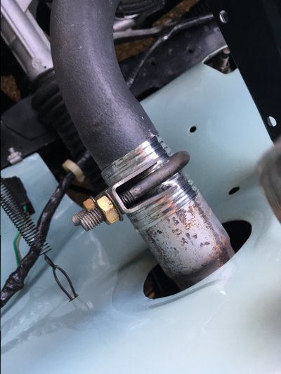

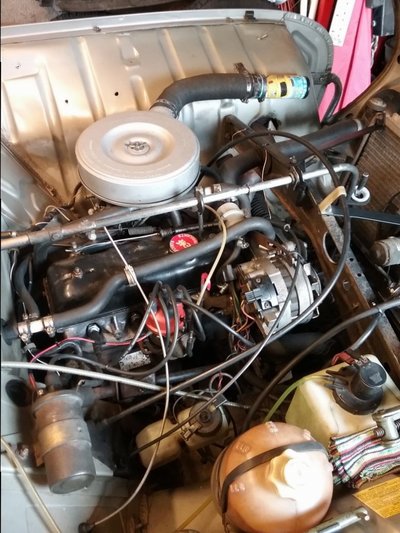

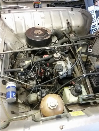

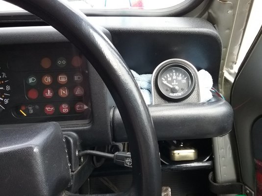

Hello all. Here is an update on what's been happening with the ex snailshed GTL.  As I've always been keen on doing a few mods, I just couldn't resist fettling this little beauty, and as I'd removed all the goodies from my previous car when we sadly parted company, it just had to be done. First on the list was the Ducellior distributor with Aldon electronic ignition, followed by a Zenith 32 if 7 carburettor and stainless steel Powerflow exhaust. This of course meant changing the rocker-box, and doing a bit of plumbing. Nic had said that he had had some problems with cylinder head gaskets, and he mentioned that the water temp light came on now and then, as it did on the journey home to Cornwall from his home in Hertfordshire when I picked it up. So, I thought I would investigate. After draining the system to check the condition of the coolent, it was clear, I refilled with blue antifreeze. However I wasn't diligent enough over bleeding the system, and nearly boiled the engine. I'd read on this forum what a pain it can be to get the air out of the system, now I know, first hand experience. Eventually I got it sorted and took the precaution of changing the thermostat and fitting a temperature sensor at the waterpump. It's had one or two longish runs, the temp light doesn't come on at all, and the temp settles around 85. The next test will be a trip to Kent at the end of the month for the 4L get together. By the way, I did check for combustion gases in the water just in case the head gasket was on the way out again, with a test kit I bought from Sealley, but it seems ok. I'm hoping it will see me through this year without any upsets, and I think next winter it will be engine out for liner seals, timing chain tensioner, which is rattling and anything else that needs doing.

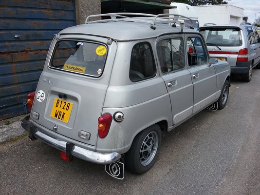

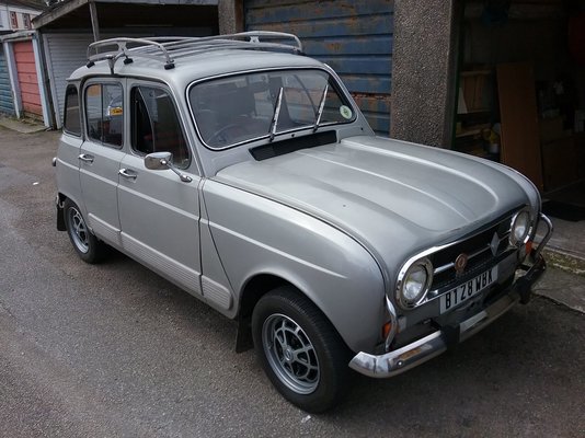

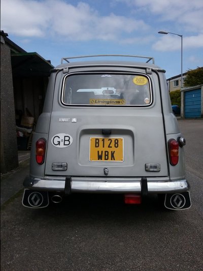

(Views under the bonnet are before and after, and the period GB plate was found at an autojumble recently. The Renault mudflaps I had in stock)
