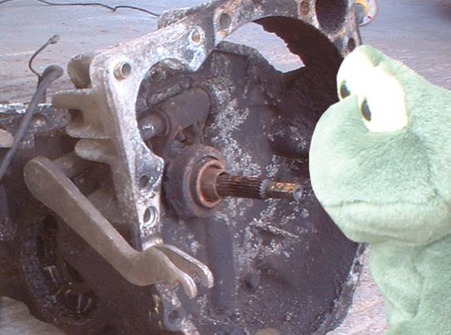

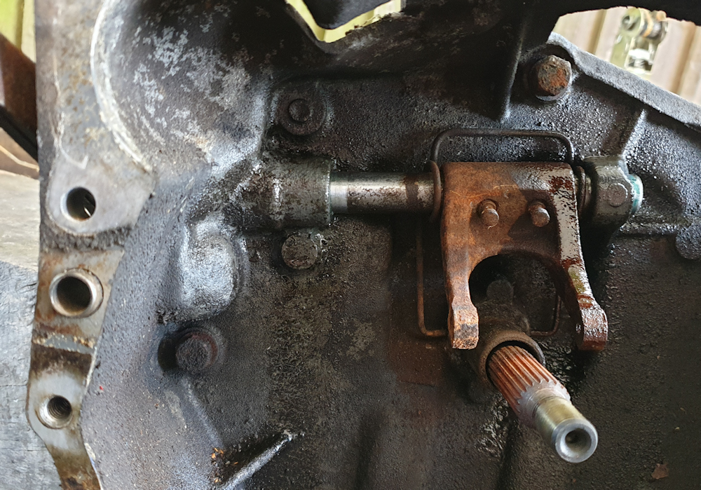

Frederick found the shaft between the clutch lever (outside the gearbox) and the release fork (inside the box) had seized.
There is a small return spring that pulls the clutch release bearing away from the clutch, but this was not strong enough to overcome the friction from the seized shaft, so the release bearing was constantly rubbing against the clutch backplate.

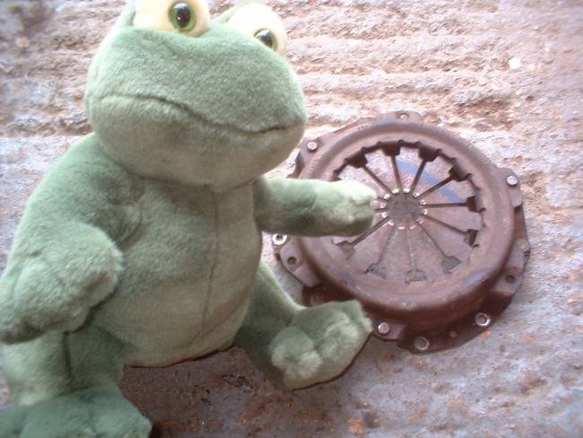

The release bearing had worn deep grooves into the clutch back plate.
Chances are this will have happened to most Renault 4s. Be sure to have a 3 piece clutch kit handy when you next need to replace your clutch.

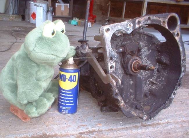

Spraying penetrating fluid at the outer end of the shaft was enough to free it - so there is no need to remove the gearbox.
If the gearbox is removed for a clutch replacement, then it is worth also greasing the main shaft of the gearbox (where the release bearing slides up and down).
Claude's clutch release lever had completely seized after being off the road for about 4 years. I had to remove the gearbox and used a blow torch to heat up the bearing surround on the left. After a lot of forcing the lever up and down and lots of penetrating fluid it freed off. With oil for future lubrication and a lot more working it became completely loose.
A blow torch might work from outside the gearbox while it is still installed on the car
